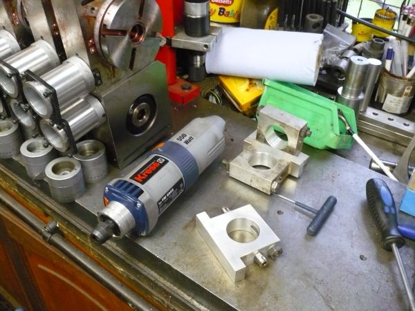

    Looking for a drawing I did a while ago and came up with this picture.
    Not suitable for your use because you can't get the centres in you need but it was an exercise on keyhole milling to get water passages nearly all the way round the mount to keep the Kress bearings cool.
    Not sure if any are left but i don't use my Kress now I have the high speed spindle so I'll do a search and see what I have

    Sure that's enough rotary tables!
    I notice you've done the other clamping method. I wonder which way is strongest.
    I was thinking of doing something like that with the DIY brushless spindle as the bearing temperature on those seems to be an issue...if I can find cheap 8mm bore angular contact bearings.

    Don't know about strongest, with the clamp method once the slit is compressed that's it.
    With the cotter method there is no limit how far you could pull it thru or better to say how much damage a ham fisted ijit could do.
