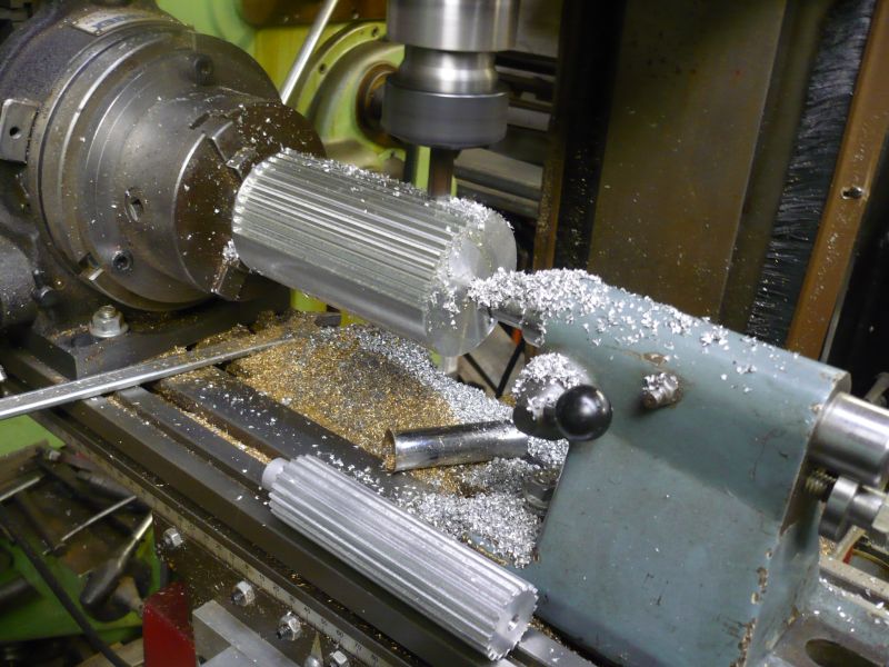

    Doing a stack at the moment.
    These are 5m's

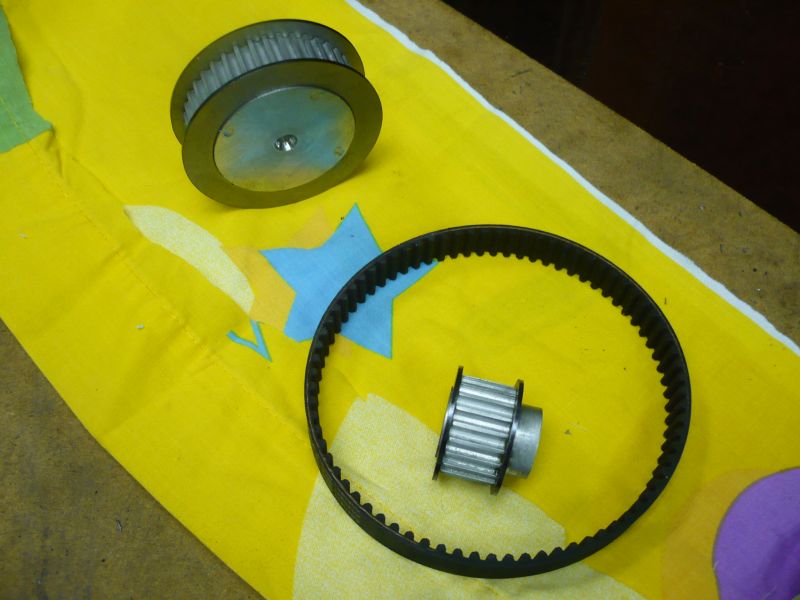

    And the finished job.

    5M's are a doddle, 1/8" ball nose cutter 2.16mm deep plunged in from the OD which you can get off the HPC website.
    For 3M's you need a 2mm ball nose 1.28 deep.

    That's how mass production looks like
    Very good job anyway. I like the side rings which I couldn't be bothered :whistling:
    Doesn't fly cutter do job faster???
    I ran 300mm/min @ 1.21mm doc and I would dare to do 500 easy. 2mm ballnose could be very flexible as well.
    Again very good looking pulleys, John
    Quote Originally Posted by wiatroda View Post
    The flanges are nice. You should use 2 to 4 per pair of pulleys, depending on the orientation.
    Ball nose cutter puts less load on the spindle, so less wear? More likely reason is probably that it's harder to grind an accurate 3mm form tool (unless you've got the right equipment) than to just use a ball nose cutter.
