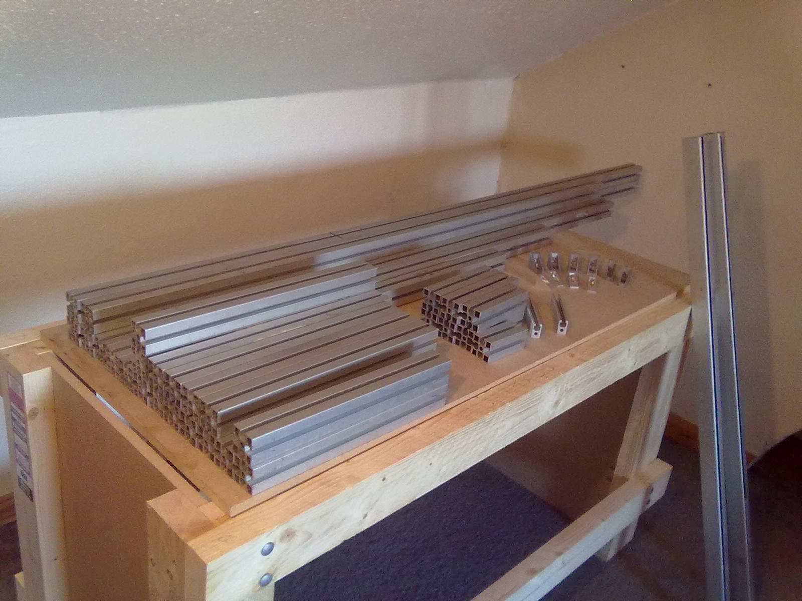

    I had the opportunity to catch up with John S in his workshop this week. He's a gentleman, a scholar and and all-round good chap I left* a little poorer in pocket, but richer in knowledge and with a pile of materials to put to work.

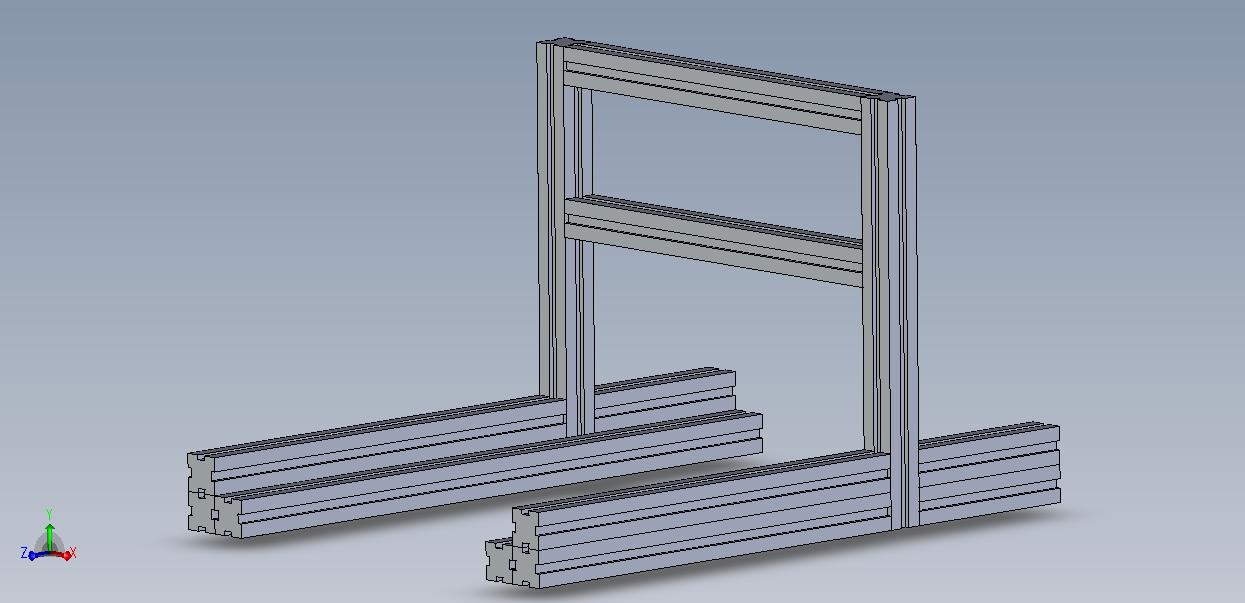

    My original plan was to use 80x40 (or more) for weight and surface area, but I think the 40x40 will make a good building and learning exercise. It's also like Lego, but for adults! The great thing about it is that I could knock together a few ideas and see them take shape in front of me, rather than have everything on paper or screen. I also get to poke, prod and wobble things to see how they act. Before any aluminium gets cut I want to have a clear idea of how I want it to go together.

    Dimensions are "off" because I'm approximating the structure but to be honest I could do most of this with very few cuts - also known as "less chances to bugger something up" - if I would accept something bigger than planned. The only problem is that it would also need increasing the size of other more expensive components. The example here is dimensionally fairly close to what I want, though (i) the gantry is far too low and (ii) the distance from the gantry to the far end of the router is too long, requiring those components to be trimmed at some point.
    The pieces of alu that run along the inside of the "wall" are for a mounting location for the rails, though I'm still considering how to do this effectively.

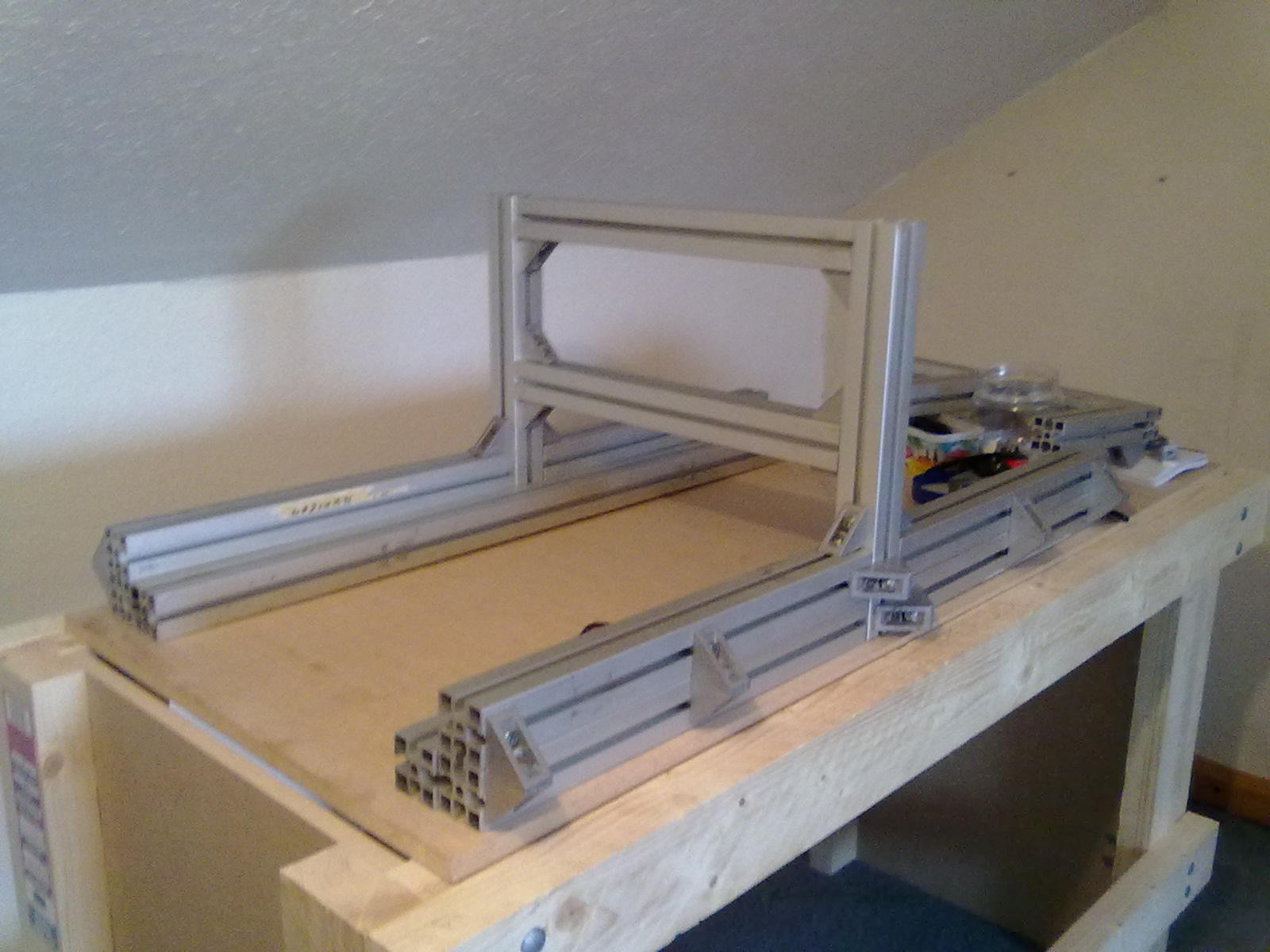

    Intriguingly enough, the follow design works with only two cuts needed to get the internal rails to the right length. It gives me (by a scrape) enough travel for a 300mm work area on the Y, plenty (up to about 400mm) on the X and approx 160mm on the Z.
    I think I'll eventually take the plunge and cut some profile to length in order to extend the back section. It feels unbalanced as it is and I'd like that the angle to be slighty shallower.

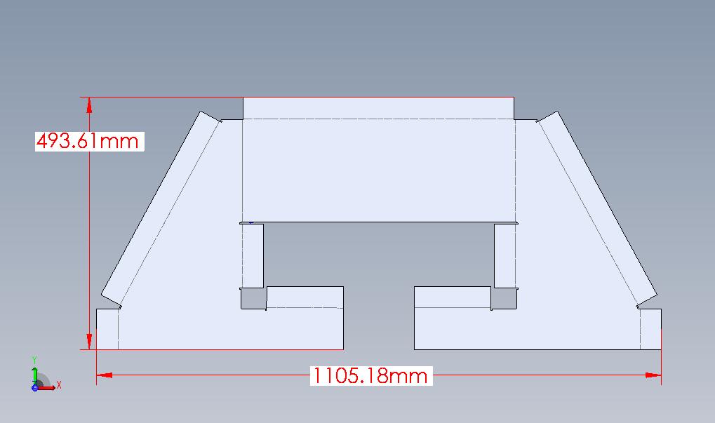

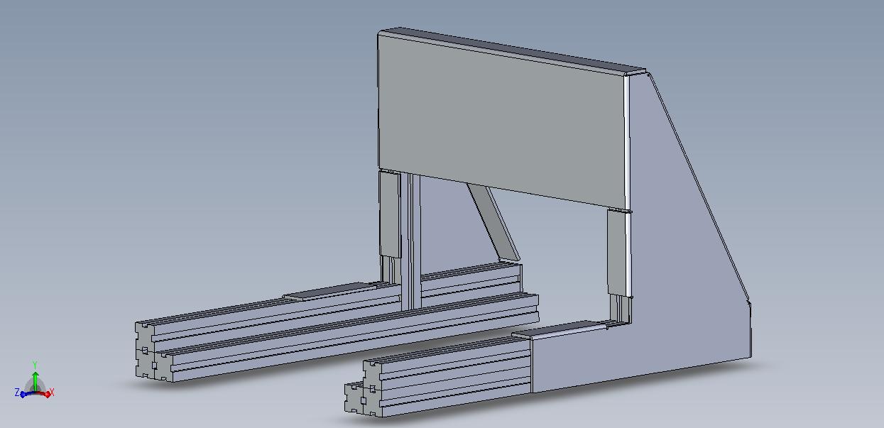

    Someone came up with the rather interesting idea of replacing the side plates and front gantry plates originally planned with a single piece folded around the frame. The idea is that it would form a more rigid structure and could also work with thinner plate - the suggestion was to use 3mm, presumably to assist in forming cleaner sharper bends? If memory serves, this would be similar in concept to a monocoque design as the walls provide structural strength? Let's see how that would look (but with 5mm because I forgot to change the numbers)...
    ...and the flattened sheet...
    This piece of plate in 5mm comes in around $42 + VAT, 4mm at £34 + VAT, so material-wise it isn't a significant price difference from the original bracing idea. The issue is cutting it out cleanly, then finding a local fabricator to bend it for a reasonable price!

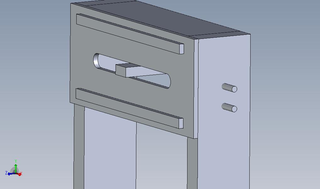

    A key piece of the puzzle remains the gantry. Another interesting idea that came up is mocked up below (again not dimensionally accurate)...
    The ballscrew and motor were to be internal, with a slot in the front of the panel allowing the ballscrew to connect to the sled for the Z axis. Pulleys were to be external for ease of changing (note motor shaft and ballscrew sticking out the side).
    I presume the idea could still be achieved by doubling up on the ganty supports, to reach a depth of 80mm - which would accomodate NEMA 23, while a cut-away section would be needed to accomodate NEMA 34.
    I'm not particularly planning to try and implement this, but there's something about the idea I liked so I thought I'd share it :)
    Folding the sheet seems like a good plan combined with the original extrusion.

    You will not need Nema 34 for this size machine so don't worry about it. The 3Nm nema 24 that lots of people use will be plenty.
