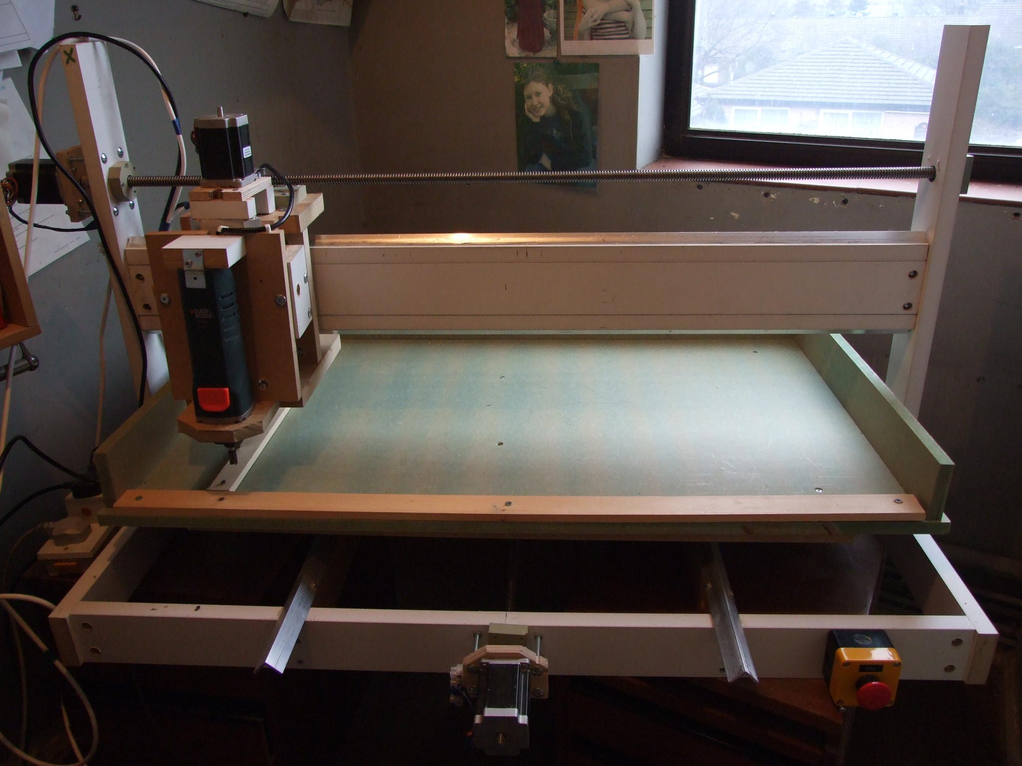

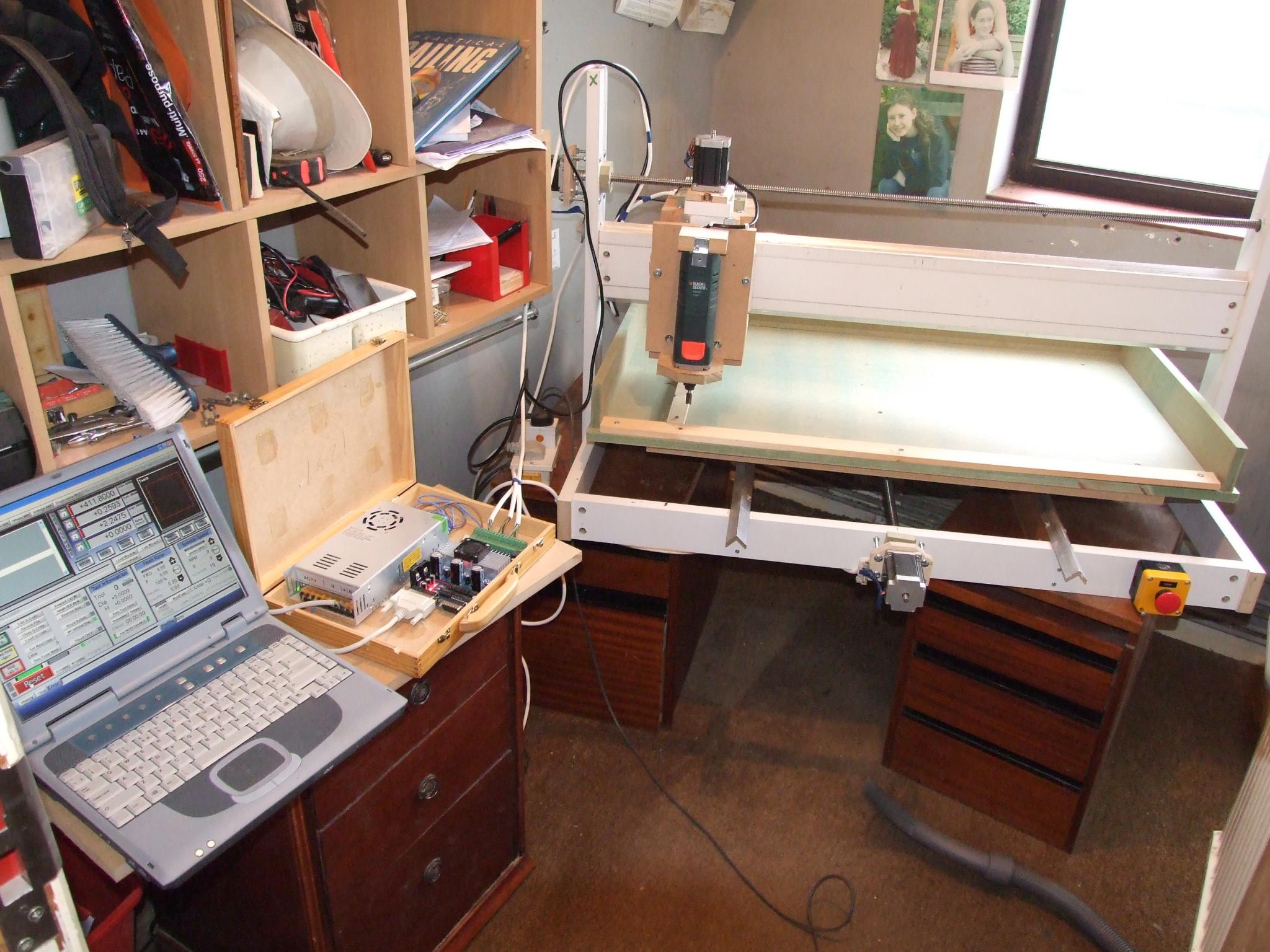

    Hi All, been reading and learning a lot on this site for quite a while, I built an mdf cnc last year and like most people got hooked and needed to build a better one. I decided to go with a fixed gantry this time and it looks like it will be a lot more stable than my previous moving gantry model. slightly larger footprint is small price to pay.
    I used 1"x3" coated mdf for this one ,I have used the 3.1Nm Nema23 439oz stepper motors and TB6560 Driver board from 1st machine.
    I would like to thank all the people on this site for the helpfull information I have gained.
    Cheers, Tony.

    I appreciate most of you are probably in engineering so please make allowances for my low skills as I am actually a 60 year old hairdresser !! and this is just a very enjoyable hobby.

    What screws are you using for each axis? Looks like ACME not ballscrews from here.
    I know the feeling... made it because it was interesting to make, not for a specific purpose.
    Hi Jonathan, I used TR16x4Dx1500mm and 1000mmTrapezoidal Acme Leadscrew for the X and Y axis and 10 allthread for Z axis. had a couple of teething problems this last 2 days but will be all sorted out tomorrow.
