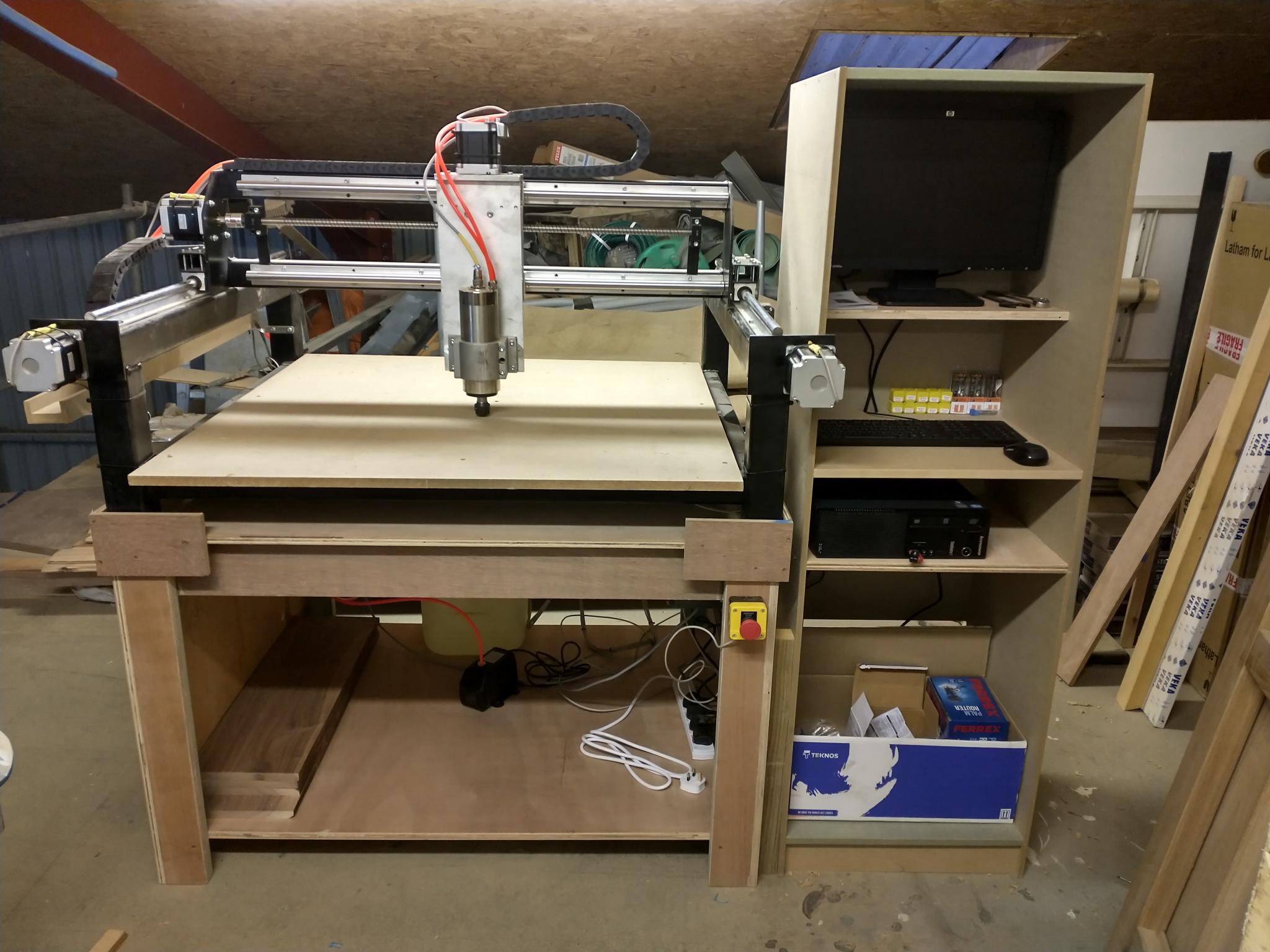

    Hi all
    I bought a 3 axis cnc router from UK and comes with computer etc.
    so finally managed to put together and try it out. I used aspire for doing my drawings and Mach3 for the cnc.
    I`m new for this but have to start somewhere.
    So opened my program and started o run without cutters in to see.
    the spindle was sitting in to the middle of the table and started from there. My machine work area is 850mmx870mm and my program was running in 750x200mm. so i did surprised why not go to left because it wont fit this way......
    anyway, let it run and when reached the edge I switched off straight away. try to send the spindle manually (jog) but wont react to nothin and the software was wont let to re set.
    so I switched off and back but still no joy. Today I went back and find the solution to re set the machine (google was the answer) so now the jog is working but regardless what arrow I`m press the spindle only go one way... the spindle wont move up or down but the Software showing it is moving.
    and I have Two motor to shift the spindle but only one working and again wont matter what arrow I press only going one way.
    They got power i guess because if machine switched off you can move them but if power up and switched on they wont move non of them.
    found out it was my mistake to not re position the zero point but i thought the machine automatically pick the sizes up from the aspire program....
    However now i have a CNC is doing funny things and not sure why.
    I sent a few text where I get the machine but not much help I get last time... (probably he pulling the hair out what I did)
    So now please someone tell me I`m not ruined my brand new machine?
    I`m from Aberdeenshire if that`s help or have someone near enough here? I`m very new for this but part from that i was doing fine to make my programs etc but now I don`t know what to do.
    If anyone can help or suggest anything would be brilliant. The machine should be running for ages but was a few parts was damaged for delivery and now this,....... nothing big damage so not related to any of this parts and as I said it was working before fine.
    I did said to reset the software because I hoped they will get back to the starting point when it was "jammed" that would messed up something?
    Hope you understand the my situation.
    Best Regards
    GeorgeClick image for larger version.

    Hi George,
    Another Ebay machine from the guy in Peter lee I'm guessing.?
    I've had a few dealings with his junk machines. You'll have more chance of getting a reply from the Queen than you will him.
    The reason you crashed was that the machine doesn't have any HOME (or Limit) switches and because of this SOFT LIMITS cannot be set which would have prevented this from happening.
    Aspire as nothing to do with the machine and knows nothing about where you are going to set your ZERO point on the table. Only the machine controller (Mach3) knows this and if it isn't set up correctly or has the needed switches crashes will happen.
    All of his machines I've had dealings with have been the same, no homes or limits and poorly set up or not set up at all.
    Now without seeing more and a better explanation of exactly what is happening or not happening it's hard to say why it's not working. BUT you mention Resetting the software.! Exactly what did you do.? because if you re-installed Mach3 then it's highly likely you have messed up the settings.
    You need to give a better explanation of what you did and what's not working. We/I can help you but you have to help yourself by giving us clear information.

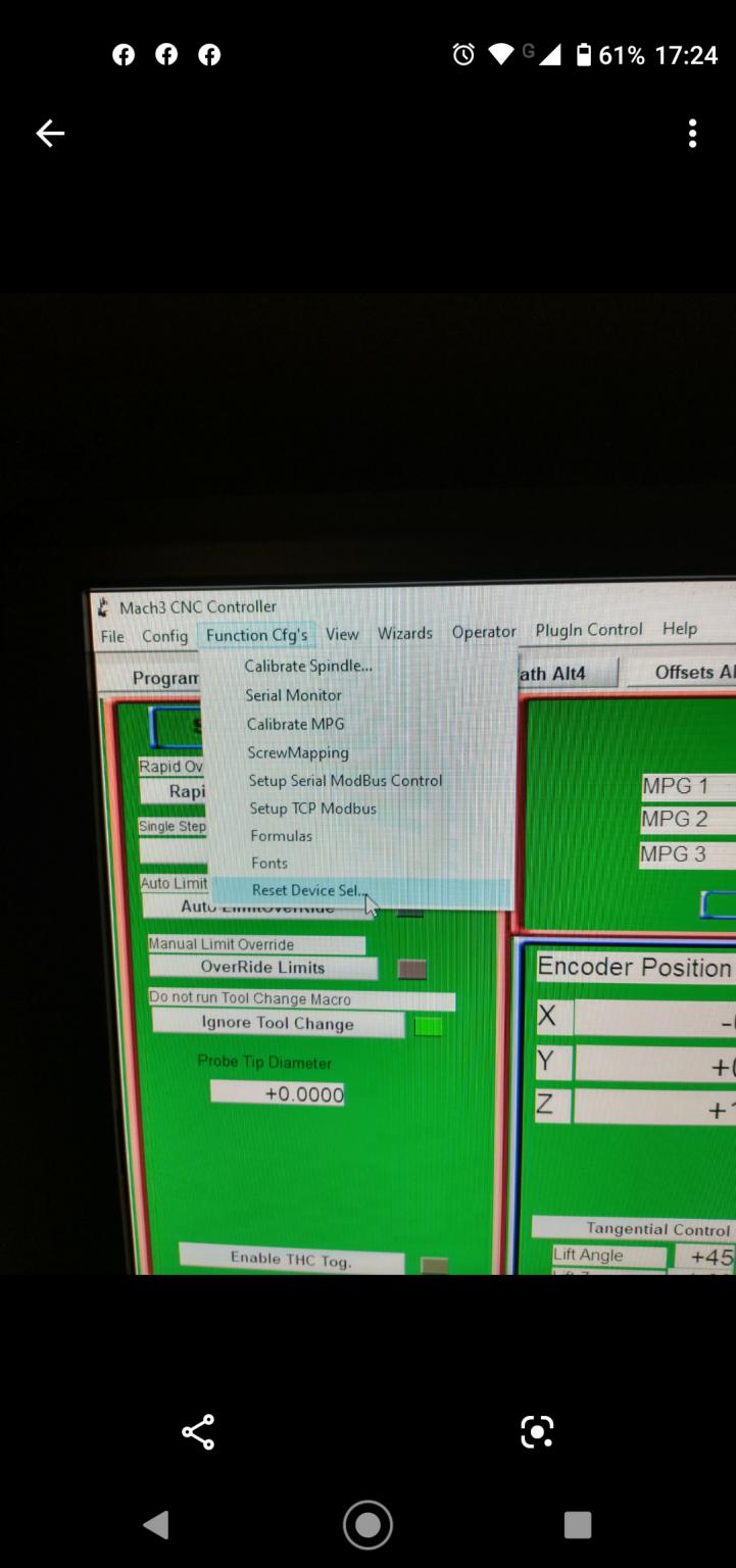

    What I did is the mach3 top sections saying configuration and at the very bottom asking reset.
    I was sent a message to him about what happened and he's asked me to open the controller box and go true what he asked.
    All the lights are green how it should and one is blue etc. So he said it's all ok there.
    He asked me to open the motor configuration page and send a screen shot and he said the settings are not right.
    He send me a files and said if I drop that file in it would sort this problems.
    I did but nothing happened. I mean when I try to jog the machine it's only go one way the X axis and when I want to shift the whole machine only one motor moving instead of two.
    And the motor which is shifting the spindle up and down not respond but the mach3 software showing is moving up or down.
    But when I jog the machine only move one direction regardless what arrow I press on that axis......

    This is how I try to re set the machine

    I'm very surprised he's even replying and I don't expect he will do so for long but my advice is that while he is responding then do exactly what he ask's you to do and if it still doesn't work then send it back or have them come and get it working. You shouldn't have to make the machine work and just crashing it into the side shouldn't break the electrical side of the machine (or even the mechanical side in normal circumstances). The worst it should do is require a shutdown and reset of the drives or at the very worst a PC restart.
    Don't mess around in Mach3 because you can easily wipe out important settings. For instance, the Reset you show isn't a reset like you think, what you are actually doing is Reselecting the external Motion controller device, which in your case will be UC100, which is an external USB device.
    If you still don't get any joy from him and he doesn't get you working or you don't or can't return it, then come back and I will talk you thru getting it working but until then I wouldn't touch it or change any settings unless told to do so by the supplier.

    Only one thing I changed the mach3 is not letting me reset and keep showing need reset..... So I found one of the forum how I can get that to work.
    So that was it but I didn't changed anything .

  8. #7
    Hi Jazzcnc
    Problem solved
    The CNC is working now.
    It was my mistake,I thought I replaced both of the files he sent me but obviously not. I did it again today and now it's fine.
    However I thinking it's a big job to add on limit switches to the machine? Probably not just a simple job specially need to get the mach3 altered to....
    Most of the time I use a same program on to the machine so one's is set it should be fine but later on I want to use it for different Jobs.
    Only one thing is still worrying.
    When the gantry motors not worked properly just one was running so I wonder if they are slightly off set eachother?
    How I can get that fixed?
    I take some measurements and looks have a few mm different.
    George
  9. #8
    Quote Originally Posted by Georgehun View Post
    No, it's not a big job, this is one of the things I've supplied and helped others with on these machines. The KK01 breakout board he's fitting as got the spare Inputs.
    You will need to make some brackets to mount the switches plus the switches and cables themself. Also, I would advise using switches that work with 24Vdc power, like inductive proximity sw, to lower any chances of electrical interference. In which case you will need a 24Vdc PSU as there is only a 5V PSU in the control box.
    Setting up mach3 to use them is very simple.
    Most of the time I use the same program on to the machine so once is set it should be fine but later on I want to use it for different Jobs.
    Not really, without Home switches then you won't be able to use the same point because every time you shut down Mach3 it will lose the position and you will have no way to accurately find the WORK ZERO.
    This is the function of HOME switches as they provide a FIXED reference point that never changes called MACHINE ZERO, which you can then use to find the WORK ZERO you last used. Or for instance, if you lose position when breaking a tool or hitting E-stop while the machine is moving.
    When the gantry motors not worked properly just one was running so I wonder if they are slightly off-set each other?
    This is the other function of HOME switches, On a machine that uses Two motors slaved together you have one switch at each side and they can be used to set the gantry square when HOMING.
    To be honest I can't believe they get away without supplying at least LIMIT switches as it's a basic safety feature and the cost is minimal considering the price he's asking and the cheap low-quality components he's fitting to the machine means he's got more than enough profit to do so.
    Also, it's very easy to share the switch to do HOME and LIMIT duty's so there is no excuse.
    My advice is to fit them ASAP if you want to work accurately and safely.
