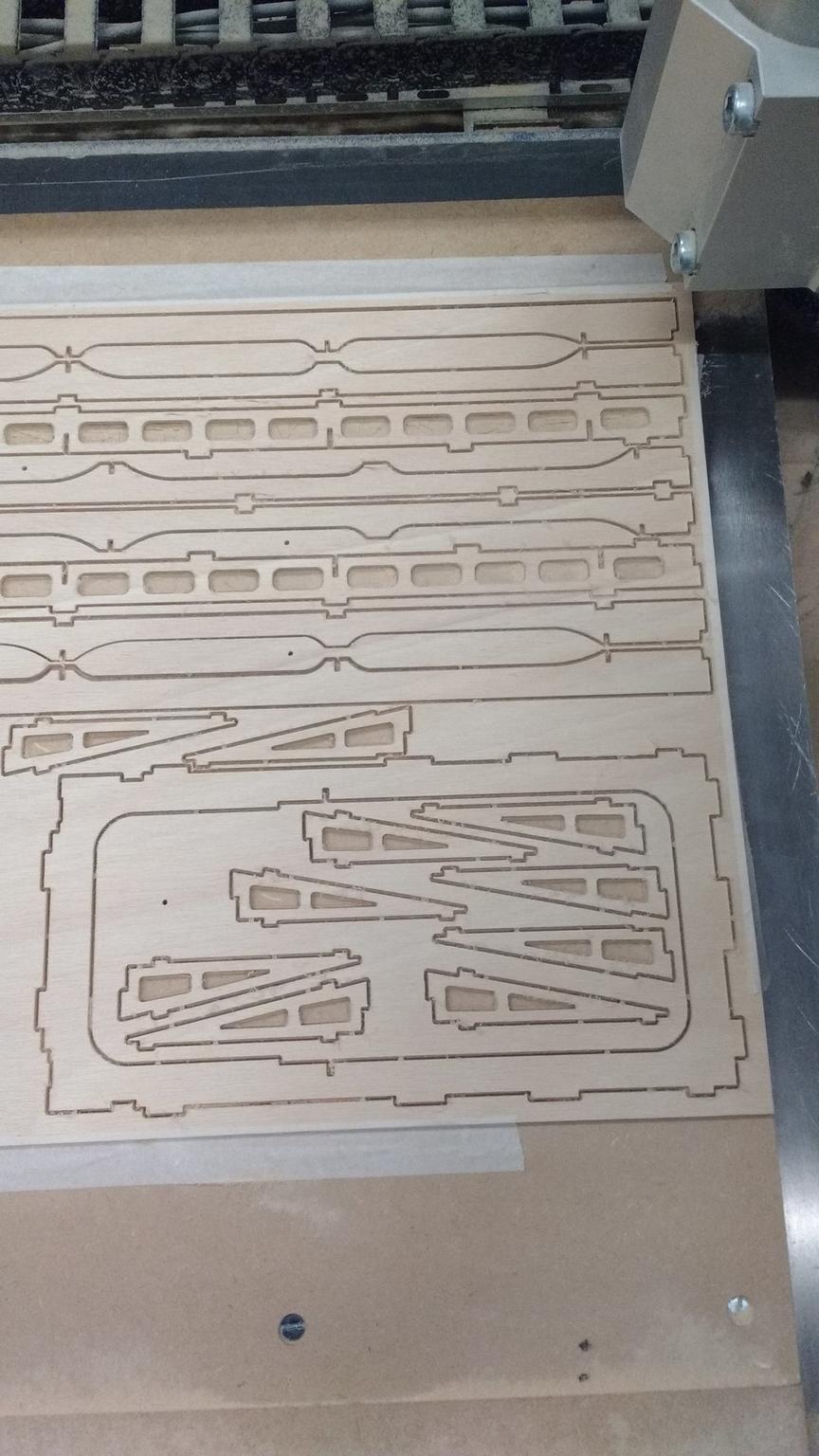

    I've just started to look into the g code in the programs (because I wanted to send the machine back to Z25 X0 Y0 (G0 Z25X0Y0) after the program had stopped cutting) so bear with me if I'm being a little thick. It's been 15 years since I've done any computer programming of any sort so am more than a bit rusty!!
    I'm trying to drill a few holes in my work piece (3mm lite ply) so I can put some hold down screws in to stop it from lifting (yes I know get some spiral down cutters) but I'm not sure what command to use. Basically I want to spiral drill the holes with the 2mm single flute bit I'm using and then send the spindle back to X0Y0 and wait until I've finished screwing in the screws, then when I've finished I want to be able to click the start button again and it carry on the program. I'm using CamBam but not sure if it has an option to do this?

    Ok so lets get a bit more detail.?
    #1 Do you want to make one hole then move away and screw one screw down. Then cycle start move to next hole and repeat.?
    #2 Do you want to make all the holes then move out the way and wait for screwing down then carry on with cutting rest of the job.? Has in 2 operations with in one G-code file.?
    One is much easier than the other.! Both are relatively easy with Cam software but ones is harder than the other if hand coding but still not challenging coding so to speak if your G-code savy.
    Also do you want holes larger than the 2mm bit.? If not then just use a simple peck drilling cycle with small pecks.
    If #2 with same size hole then it's simple enough has the G83 peck drill cycle is classed has one operation even thou many holes in different locations.
    After the Peck cycle ends you send the machine to the loaction out the way then Issue a M6 tool change. This will wait for tool change and just don't change the tool and push cycle start when finished screwing down.

    Thanks guys, hopefully the below picture will show what I'm trying to do. There are lots of nested parts and I want to put in supporting screws to help keep the ply stable and not moving all over the place so the pieces get ruined, yes vac hold down would be nice but that's not going to happen...yet! Neither do I want to be cleaning double sided tape from the parts.
    Dean, #2 is what I want to do. I currently drill the holes (3mm from memory) using a spiral mill operation (I think!) and then want to send the spindle out the way back to X0Y0 whilst I get my cordless drill and screw in the screws. Then I want to be able to set the machine back on its merry way cutting the next operation etc. etc. till it's finished.
    Charlie, the M00 option I presume would just pause the program with the tool still over the last drilled hole?
    Lee, the feed hold runs on a bit after pressing (tried it a few times...) so not really suitable and I'm not sure I want a timed delay as I know it will either be too short or far too long....

    When I want a small pause, I add a tool-change, without really changing anything. I can then jog it away and put in screws, when I hit run again it will go to position and continue.

    I do edge clamp it (see above pic, I use masking tape...) and do the drilling operation first...I want to know (being a complete noob) how to stop the code so I can put the screws in.

    As someone has said above, an M0 is the best way to pause the program.
    An example would be...
    (this is based on fanuc/has g code but the format will be the same)
    G83 Z-10 R3. Q3. G99 (drilling cycle)
    X4. Y6. (hole position 1)
    X44. Y46. (hole position 2)
    G0 Z50. (rapid away from job in z)
    X0. Y0. (rapid to home/change position)
    M0 (program stop)
    ... Continue program
    The M0 will pause the program until you press the green cycle start button again.
