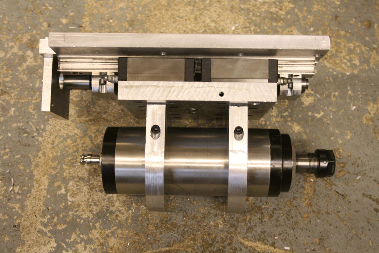

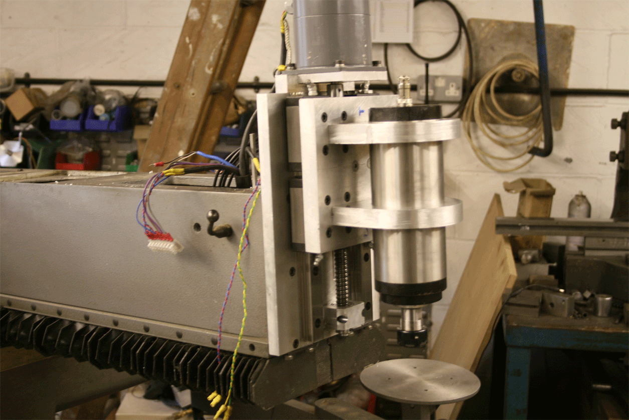

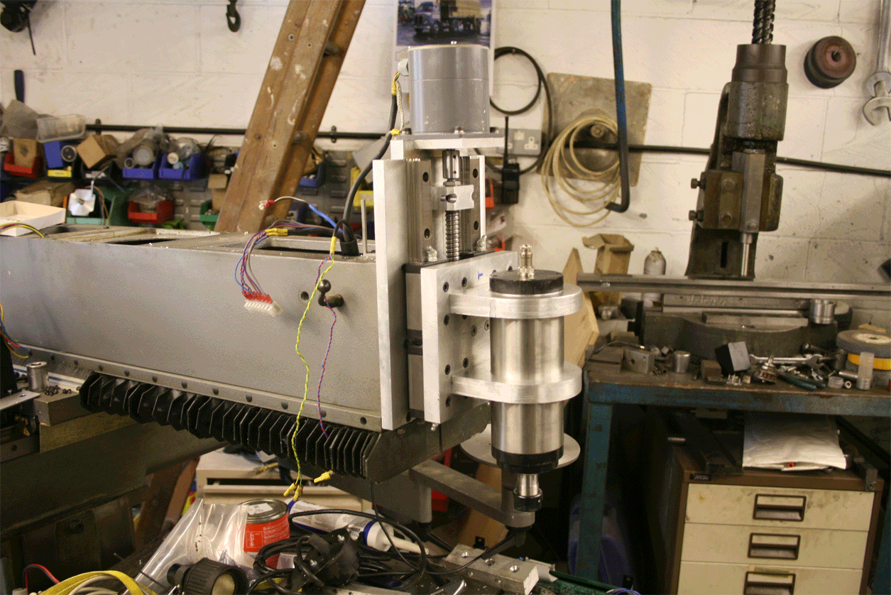

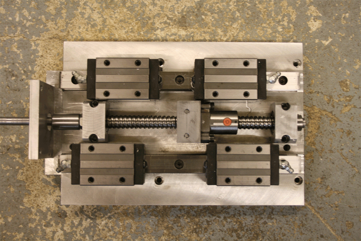

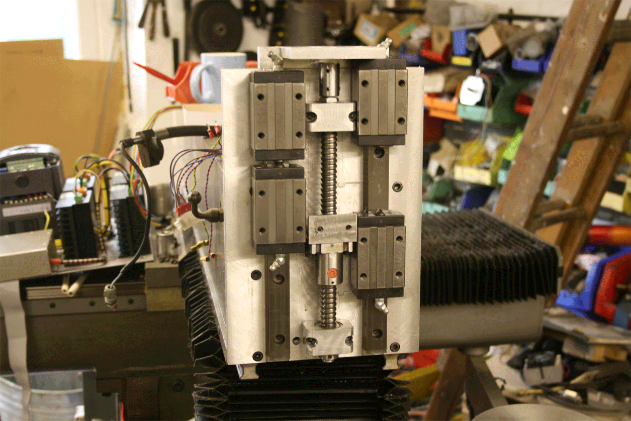

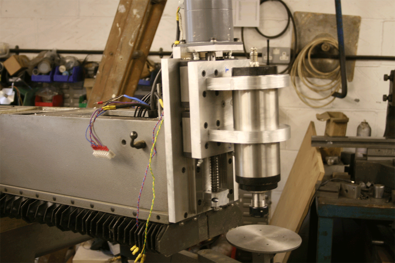

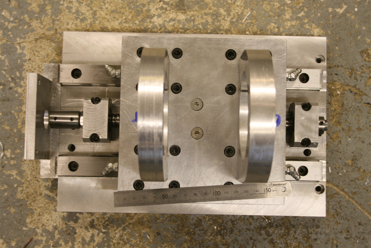

  2. Hi New Member ( name and address withheld ), i have gutted my machine as i was dismayed how BASIC the controller was, i felt that someone had found my old BBC basic computer and given it back to me to use again!!!

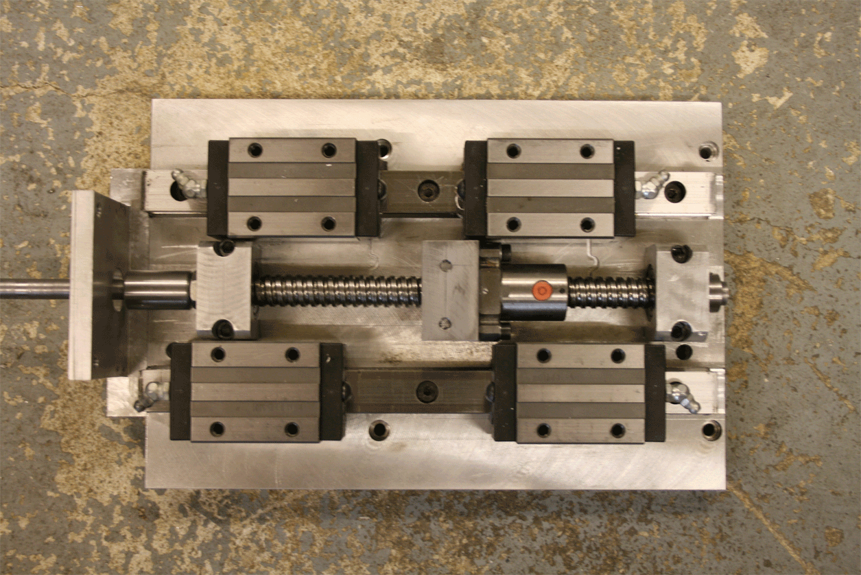

    I have so far rebuilt the z axis to use a Chinese water cooled spindle motor and inverter and therefore done away with the belt driven spindle and the very noisy motor mounted top central of the mill grav i have also stripped out all of the original electronics and i am currently building a PC mother board with a smooth stepper to give two IO ports and a serial port to control the inverter, i am intending to use one port to work with a MPG and the other port as limits and over travel switches all of this is to be run under windoz and Mach3 much to 2e0poz's dismay and his attempts for me to run Linux... i am stead fast with this windoz rubbish
    So far everything seems to be going to plan ( if i had one ) and i am now wiring and configuring the MB and all of the IO's.

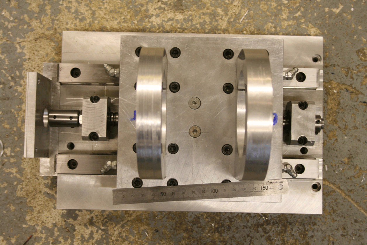

  7. my new Z
ID:	5844Click image for larger version.
Name:	IMG_2894 - Copy.gif
ID:	5845Click image for larger version.
ID:	5846Click image for larger version.
ID:	5847Click image for larger version.
ID:	5849Click image for larger version.

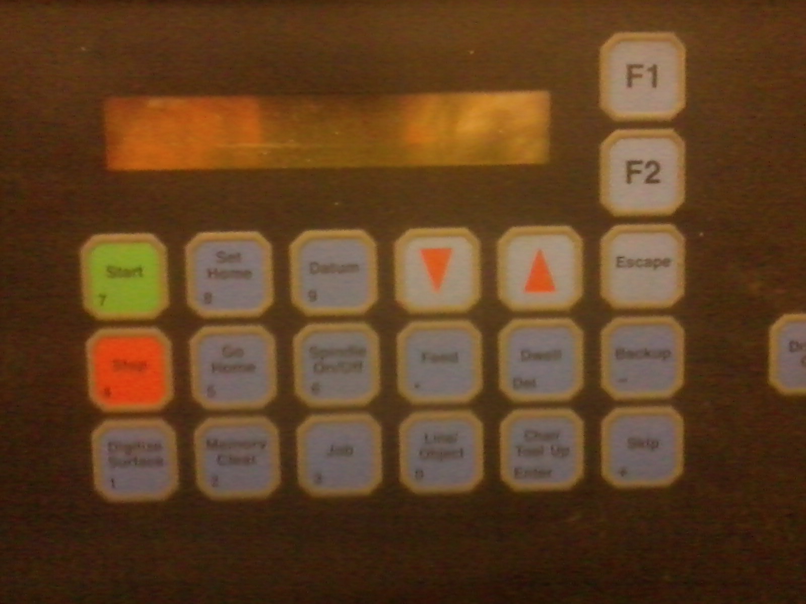

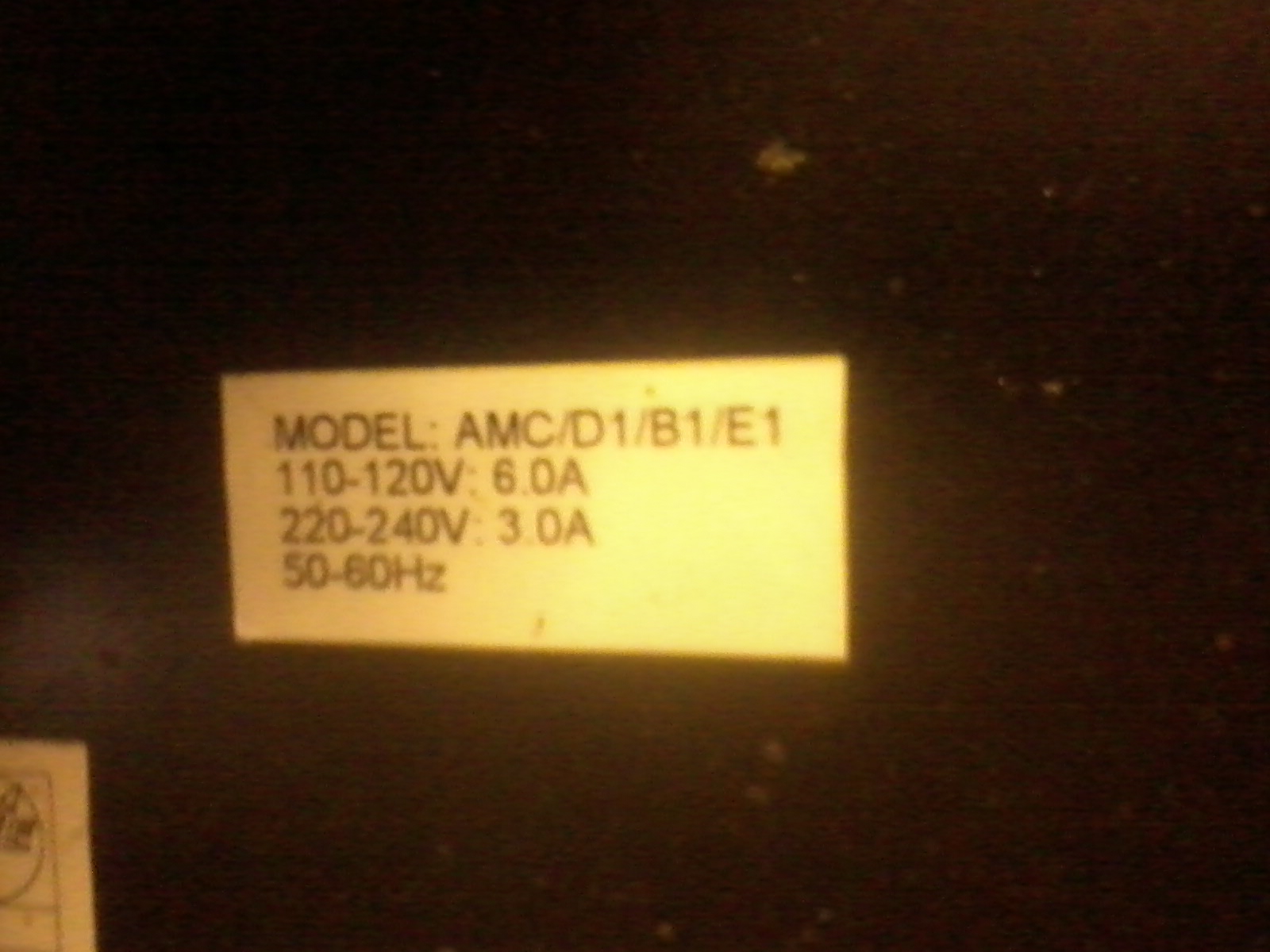

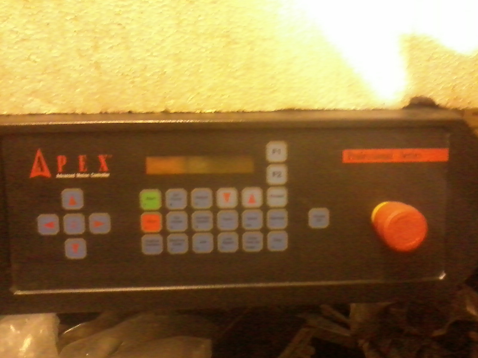

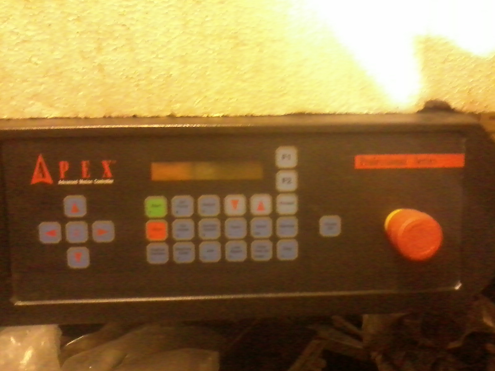

    Hi
    This is the Apex controller fitted to my MillGrav any help you can offer would be very much appreciated.

    Hi just found your post on a random google search, did you get anywhere with this? I spent about 10 years programing and running this machine so should be able to help you. You state the old model I take it the machine is fitted with the older style square white control unit not the apex model? Have just registered on here so drop me a line if I can help in anyway I will.
    If you do have the old control unit you can only program basic commands via G-codes for general milling purposes, if you wish to use it as an engraving machine you will need suitable software for your pc, I very much doubt the old newinghall software will be available, plus their dongles cost lots! I will see what information I can dig out on it its been a while.
    I have spent many hours trying to get information about the Apex Controller which shows only two lines of text at once. What I cannot work out is how one sets up the controller to receive G-code. There are three formats, one being a Windows 'special' which works OK with JLS. However the more modern CNC software outputs G-code. Software purchased from BobCad USA was expensive, and from samples they wrote an interface using the information from Newing Hall which took months, but nobody seems to know how to select G-code for the interface. The Millgrav has new ball screws and is quite a nice machine, but the controller seems to let it down. I wonder if you would remember how to set it up for G-code. Cheers for any info you might have!
