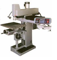

  1. Hi I am now the proud owner of a newing hall Millgrav, an older model but in beautiful condition, my question is about the controller and setting up, as there is no instructions to show how to use one of these machines, is there anyone out there in cnc land who may have some written instructions that they might want to share???

    Hi just found your post on a random google search, did you get anywhere with this? I spent about 10 years programing and running this machine so should be able to help you. You state the old model I take it the machine is fitted with the older style square white control unit not the apex model? Have just registered on here so drop me a line if I can help in anyway I will.
    If you do have the old control unit you can only program basic commands via G-codes for general milling purposes, if you wish to use it as an engraving machine you will need suitable software for your pc, I very much doubt the old newinghall software will be available, plus their dongles cost lots! I will see what information I can dig out on it its been a while.

    I have just joined the group, and hope to learn enough to be able to bring a machine to life.
    I started out building a gantry type Engraver/miller using a 4' x 2' surface table as the bed and weldments for the arms and overhead track. collecting endless ballscrews, slides, steppers and obsolete drivers along the way. The engineering evening class closed after a guy released a machine vice onto his foot, so the project was abandonned.
    I have bought a Newing Hall Mill Grav machine with the Apex1 controller upgrade, from a local business which closed after 80 years trading. The machine had no software as the firms office had been the victim of an arson attack. I have downloaded the only program available from Newing Hall which appears to be only a job setting out program, they tell me this obsolete machine is no longer supported. I expected to be able to plug the machine into the serial port and at least jog it, no such luck!
    Does anyone have any experience or information as to what is needed to have the machine talk to a computer.
    I have a demo version of Mach3 but presumeably this would involve bypassing the Apex controller altogether.
    Any help would be much appreciated.
