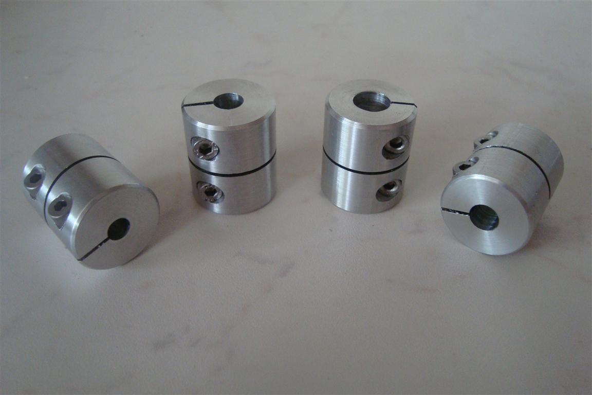

    Was going to offer to make one as I've done lots in the past. Let me know if you still need it.
Name:	DSC07501 (Medium).JPG
    Sorry if I'm stating the obvious, but it's best if you bore the 14mm and 16mm hole both frome the same side of the coupling, i.e. do it all without taking the material out of the chuck. That ensures the two holes are perfectly concentric.
    just wondered is the picture your work ????
    if so pm me a offer depending on the price i might take you up on it
  7. #6
    Yes they are...used to sell them on eBay then decided it's just not worth it. They look like 8mm ones. For your size I would use 30mm aluminium bar, how long?
    Here's some more I made earlier:

    Jonathan you might want to consider allowing the slit to cut the opposite side as well. it allows it to grip much better. Scott if you want one of theses to cover the whole screw (thread as well) then that is not good. You need to take some off to about 12mm which should be about the bottom of the thread, 16mm seems a bit big?
    I did consider it, but my slitting saw is not big enough. When I get a bigger one I'll do that.
