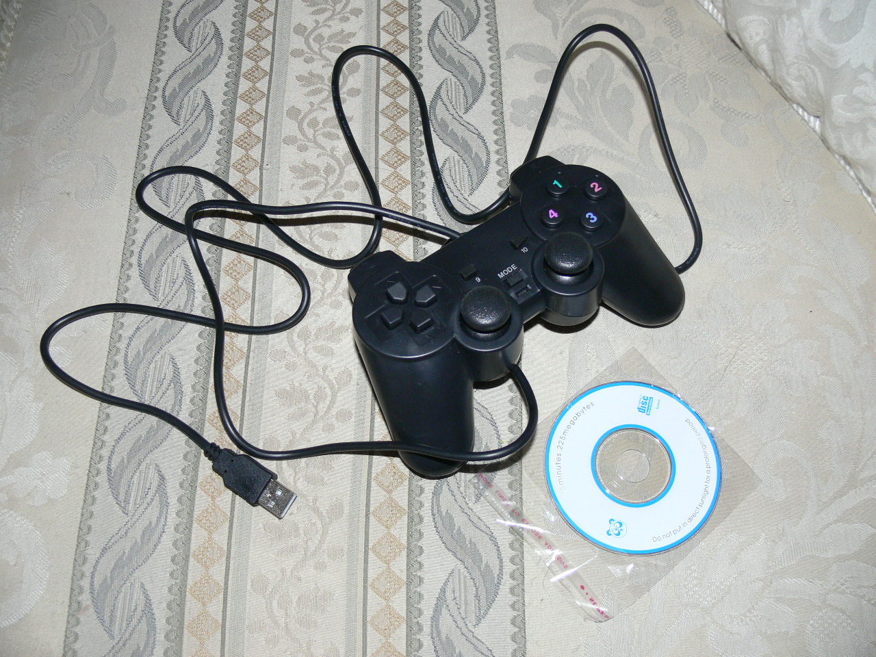

  1. Hi guys
    I received today new USB pc gamepads for my boys. First thought I had : is it possible to connect it to mach3 to control axis, feeds, start,stop etc?????

    Did someone do it ????
    Yes they have. See here:
    http://www.machsupport.com/plugins.php
    Look for Xbox, at the end.
    Edit: Oh except that's not an Xbox controller? Maybe one of those will work anyway...
  3. Quote Originally Posted by Jonathan View Post
    Thanks Jonathan
    Mine one is PC version of PS2 gamepad, but I'll give a try and see what happens :naughty:
    An xbox controller is a standard USB one anyway, I know as i utilised the controller ports to run my keyboard and mouse when i stuck linux on it :-)

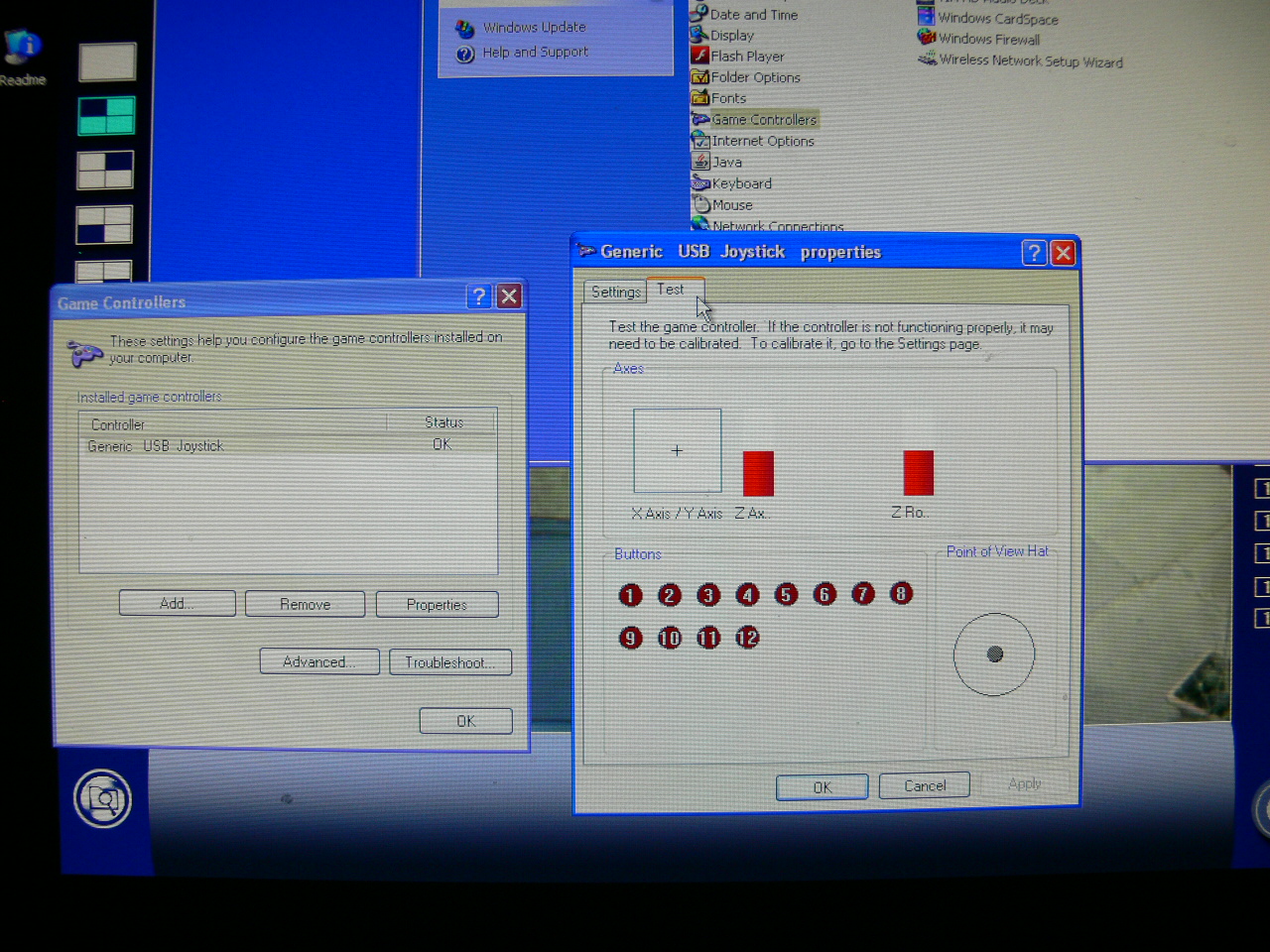

    you can make it wrk easily just using a joypad keyboard emulator such as the one on tis page http://www.gamessence.net/gamepad-keyboard-emulator/
  6. Thanks John. It does work and cooperate with mach3 nicely.
    I can control all axis + start stop buttons. £5 gamepad from fleebay with 1.8m long cable does its job. Must order another one or nick from boys room :naughty:.
    Does reset, feedrate down or up button have keyboard shortcut???
    not sure bout reset feedrate etc having a keyboard shortcut but i think ctrl puts it in step mode so if you old ctrl and then press a direction it will move one step depending on what the step is set to in mach i.e 1mm 0.1mm 0.01mm etc
