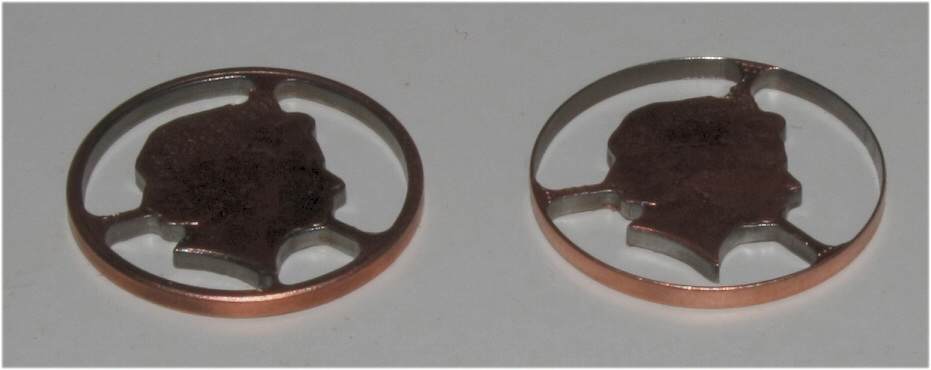

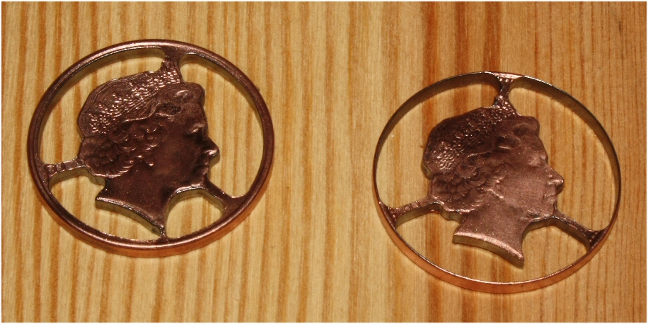

    Mmmm, it's about time I did something proper! Found the spare kress! Spent all day cutting out 2 pence pieces, another excellent waste of time :-)

    An excercise in trying to mount concentric and mill. Thin one: the edge varies from 0.34 to 0.4 mm so not bad. But the mount was in wood (just a 26mm hole bored) so had some give. The top part was in ali to form a clamp to hold the 2p down, 25.6 hole with a small 26 dia 0.5 deep lip. Was trying to get the edges as thin as I could, must have over cooked it as on attempt the 1/16 end mill bit snapped. It only has 3mm flute length so I think it touched the clamp edge which was enough to stress it. T/C ouch! Took some vid of the v carving, mute your sound, it's terribly noisy!
