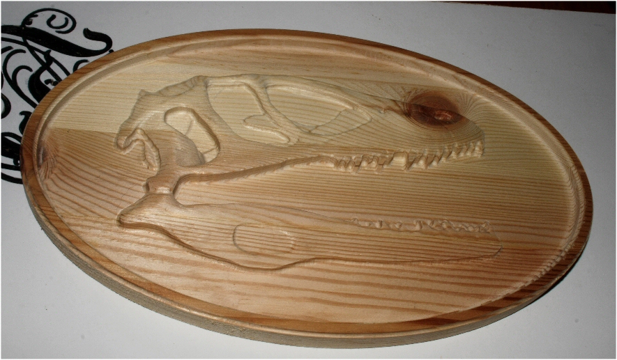

    Coins and stuff
ID:	5168Click image for larger version.
ID:	5170Click image for larger version.

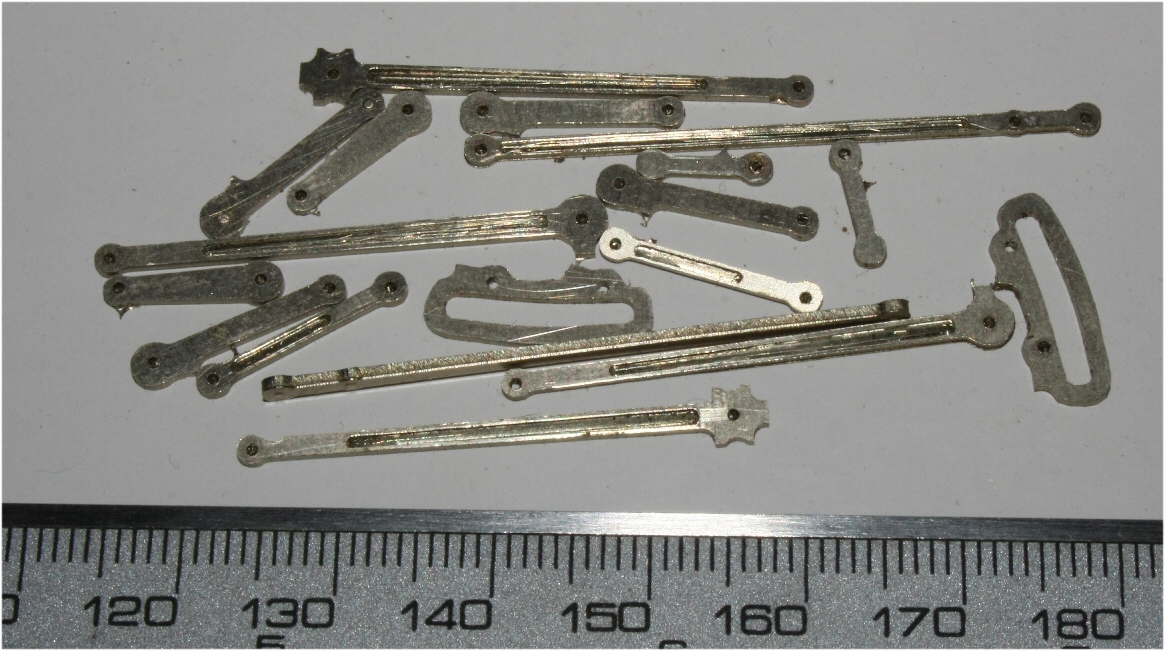

    Did this about 15 years ago, never used them, intended for an O guage model of George Stephenson, thats a Black5 BTW with unique valve gear. They were never used (yet) and they are taper fluted with 1/32 bit. They are out of 1/16 N/S. Never been cleaned up and still have the support tabs and smells of treflex, so nothing changes!
