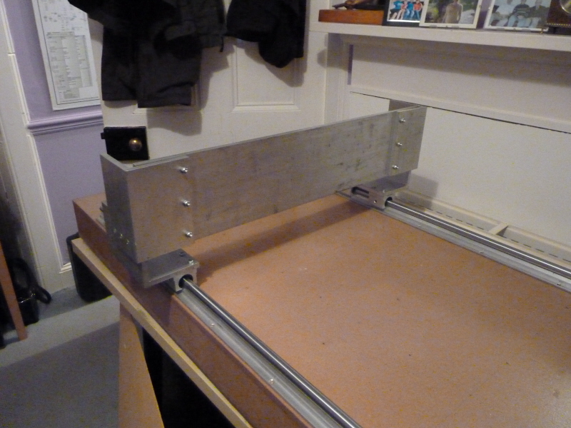

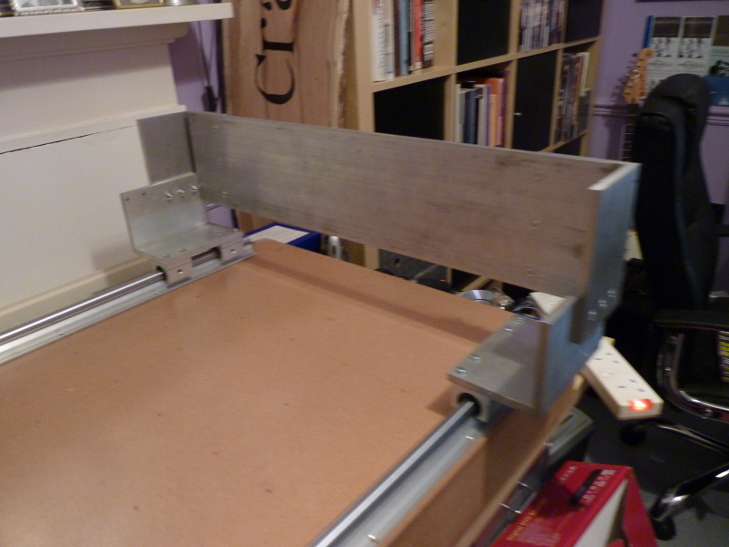

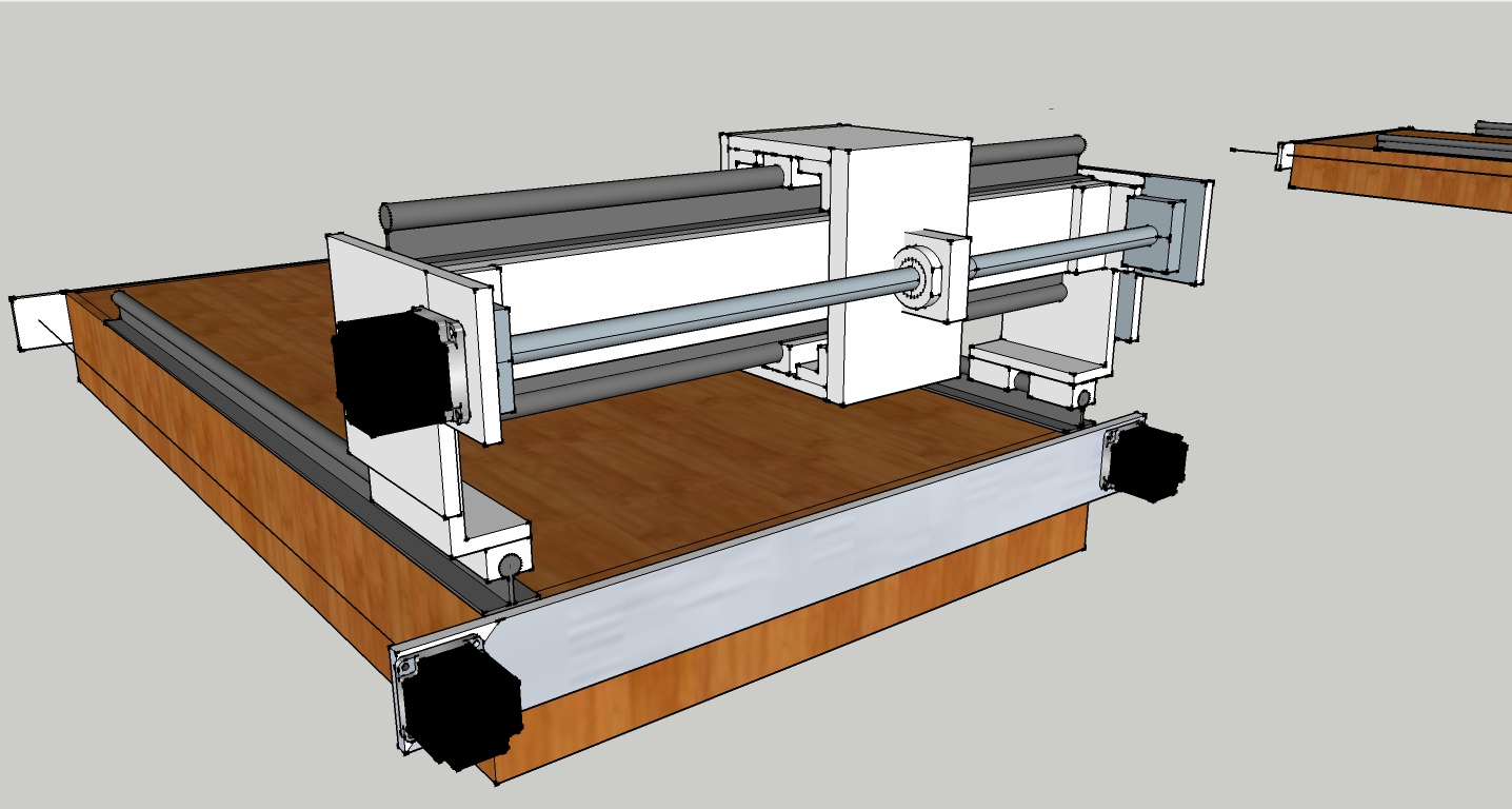

    Hi guys. This is my first attempt at building anything like this myself. I have a history in motorcycles for 45 years and used to be a mech eng designer. Its a bit diferant without a full blown workshop doing your bidding. This project has a limitation on funds but I will not skimp if possible.
    As it is the first I have decided to make a torsion box base. If this all works then I can upgade to a metal frame later. I also thought that linear rail bearings would be better than bearings on angles.
    I realise that regidity is essential so the y gantry has been constructed from 10mm Ally. Although it came cheap the angle was not exactly 90deg . Bit of patience and it appears to be fairly accurate. When the rails arrive for it the will be measured off the x rails to locate. If it ends up being too heavy then I can cut sections out to lighten the load. It rolls well but inertia maybe a problem.
    I have ordered ballscrew, 2 for the x and 1 for the y. My next decision is stepper size (3nm maybe) and whether to build or buy the z.
    Comments are always welcome. Already had great advice on spindle choice.
    Bruce

    I too started with my X-axis rails mounted to a torsion box made from MDF/pine with a gap left either side to hide the 2 leadscrews. I'm still using the torsion box as the machine bed. Making the steel frame for mine made a huge difference. What size are your X-axis rails, they look like only SBR16 or 20mm?
    Plate is weak for the gantry since when the machine is cutting parallel to X the cutting force will try and bend the gantry, and that's in the direction that's worst for a rectangular cross section. It's also the worst cross section to choose for twisting. Adding extrusion, or more plate perpendicular to it to the back would help, but you could try it and see and make sure you leave space to add it at a later date if required. What is the width of the plate, so I can calculate the deflection (roughly)?
    I'd be inclined to add some triangular pieces to the aluminium angle to stop that flexing.
    3nm is a good choice for the stepper motors. Lots of people, including me, use them. If you can afford 70 volt drivers (like MDS752) then you will get a higher feedrate than 50V (like MDS542), but it's more difficult/expensive to find/make a suitable power supply. The mass/inertia of the gantry is not a problem with these motors. Chip's and mine (and many others) using the same motors weigh a lot more.
    Have you bought the ballscrews yet? If not then get 10mm pitch (RM1610) for X/Y to get a higher feedrate and use HTD timing pulleys (although 1:1 ratio is about right for those motors and 10mm pitch screws adding the pulleys still helps as it reduces resonance). 5mm pitch screws (RM1605) will work but it wont go anywhere near as fast, or more importantly the acceleration will be less and possibly vibrate more as the screw is spinning twice as fast.
    Thanks for the heads up guys. All the material is 10 mm thick and 150mm wide. I had wondered about the the plate for the gantry but thought I could add box/angle to the back if required. the rails are 16mm
    Unfortunately I have already ordered the lead screws and they are rm1605. I really should ask first DOH!. I am going to look into ordering the motors controllers this week sometime.
    The angles on the rails were left hanging for, just as you say, the support for the nut on each side. I also thought that this allowed for the Y screw supports to be further apart and thus allowing me to use more of the bed width.
    I really appreciate all your help guys
    Bruce
    x and y screws plus the y rails arrived today. Had a thought about the gantry design and have to agre especially with the angle on the rails. Looks like a bit of a rebuild required. I will also have to think about the z gantry.
