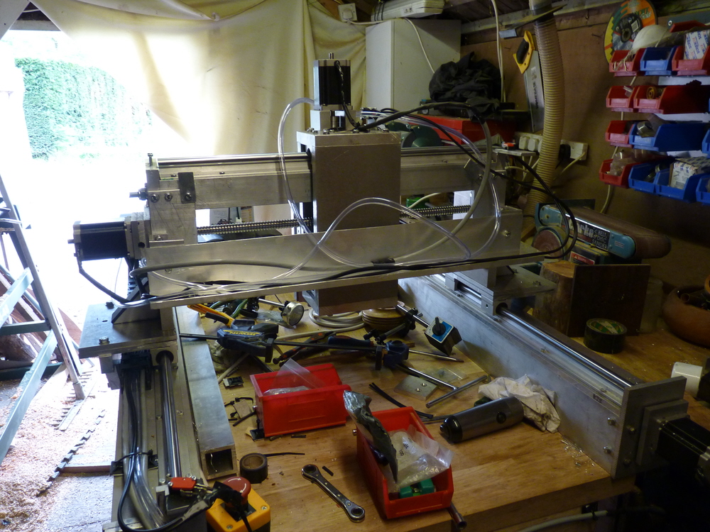

    Thats most of the metal bashing completed know. All thats left is brackets to connect the x screwnuts to the gantry and mounts for limit switches. Gues I will have to start on connecting the electrics now. This is the bit that I am not confident about so a bit more reading of old threads and a few stupid questions, as usual.
    The y motor has had its mounting made after this picture was taken.
    Bruce

    Just looking at them X brackets Bruce how are you going to mount them to the bearing plates with that big overhang from the plate which the rails sit on.?
    It's looking good thou getting very close to fire up time.!!!

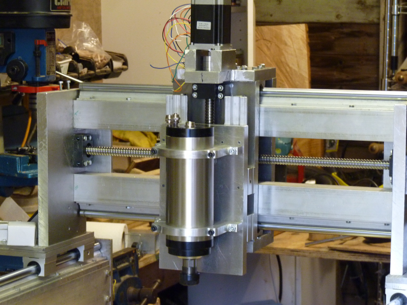

    But I have a bit of a problem with one side of the x axis. As it moves across one side starts to make a noise as though it was starting to bind up. Does not do it in the reverse direction. I have loosened the rails to allow them to move but makes no different. could be the bearings may have been knackered being put of and on the rails as it was built. I have a spare set to try. Disconected and pushing it there is no problem. It probably is the rail/ballscrew tightening.

    Cannot believe its been 3 weeks!! Today I decided to swap over the ballscrews but leave everything else as is. The binding sound now comes from the other side and yes I think I know the problem. You may remember that I thought it was a good idea to take a ballscrew apart and see how they worked. I think that I may have not found all the balls and that this is the cause of the problem. So I shall have to get another ballnut and try again.

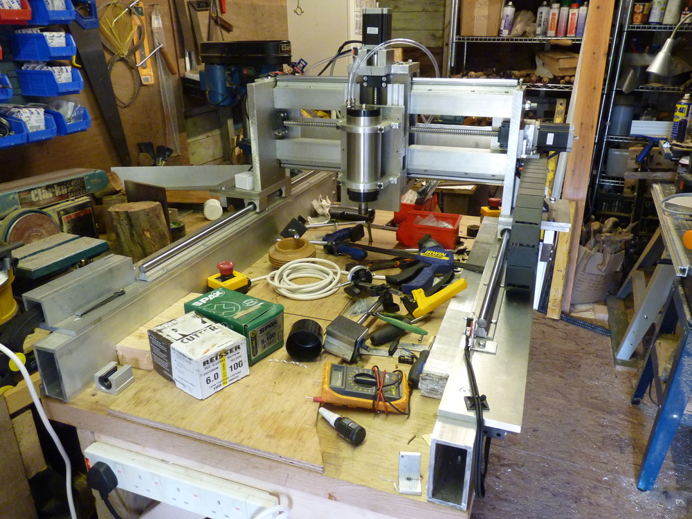

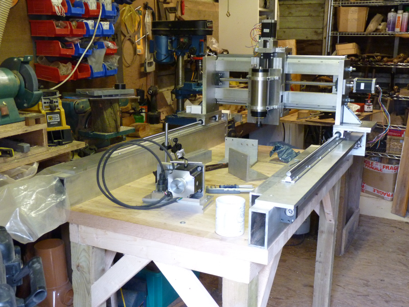

    AAARRGGHHHH I HATE COMPUTERS. All ready to do some alignment checking and the computer decided to crash and reboot. Thats all it does now is reboot, crash, reboot, crash...... Tried a linux disc but that would not load either. It has always been a bit suspect as it would happily run mach but not cambam. Here are a couple of pics. Wiring still waiting to for a tidy up.

    Looking good. Did you solve the suspected problem with the ballnut? If you've not already, try turning the ballscrews by hand to see if they feel smooth with no cyclical torque variation.

    Got a new ballnut from cnc4you and all the horrible noises have gone. I am so close to finishing but there is always just one more little thing....
    The tray on the back is for the drag chain. Then the cables and tubes will be sorted.
