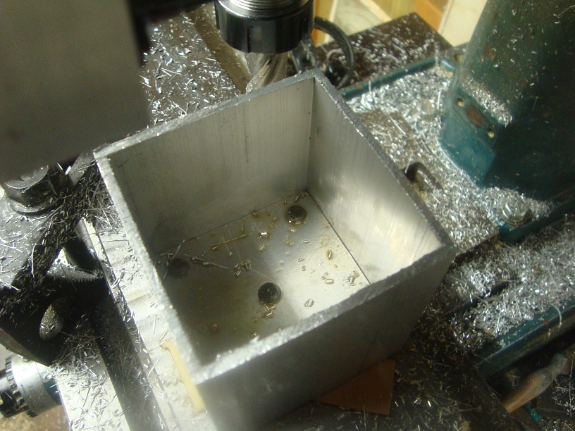

    80x40x3 box section is less than a third as torsionally stiff as an 80x80x3 box section. Same reason as before - material is distributed further from the centroid with a square compared to a rectangle.
    These photos show mine (old pictures!) with the size I mentioned. I put 20mm thick plate in the ends of the box section to make as strong joint.

    emmm. okay. I have looked on line and 3" x 3" x 10 swg (3.2mm) is easily available. My limitation is no access to a mill. All my work is bench work. But I am sure I can come up with something.

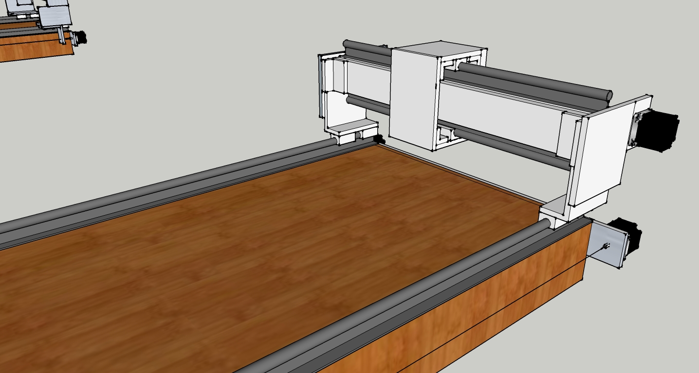

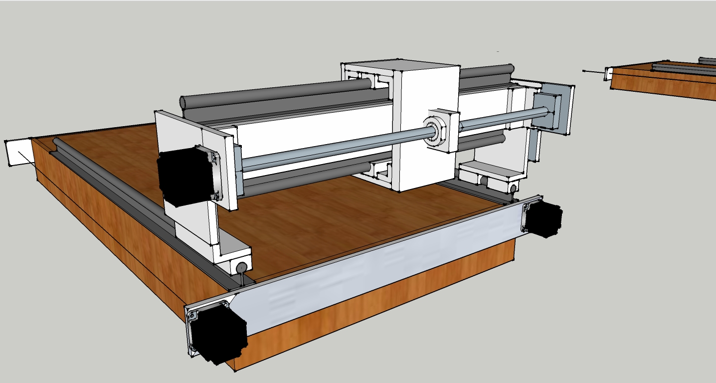

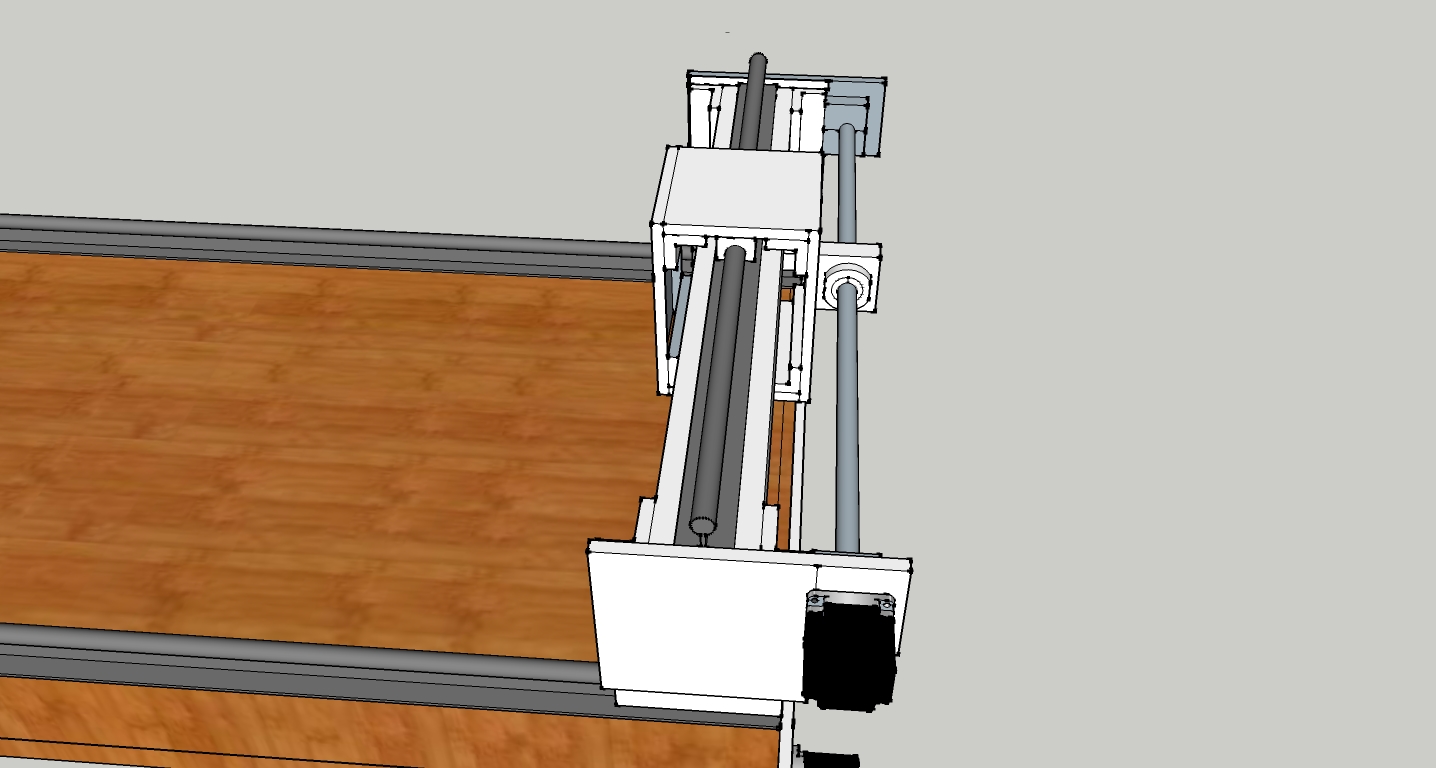

    OK Here is a thought on redesigning the gantry. Any similarity to Jonathan's machine is purely down to plagerism. I have looked at a construction that I can do myself. I will make some enquiries tomorrow about acccess to a m/c shop.
Name:	redesigned gantry 1.jpg
ID:	5180Click image for larger version.
Name:	redesigned gantry 2.jpg
ID:	5181Click image for larger version.
Name:	redesigned gantry 3.jpg
