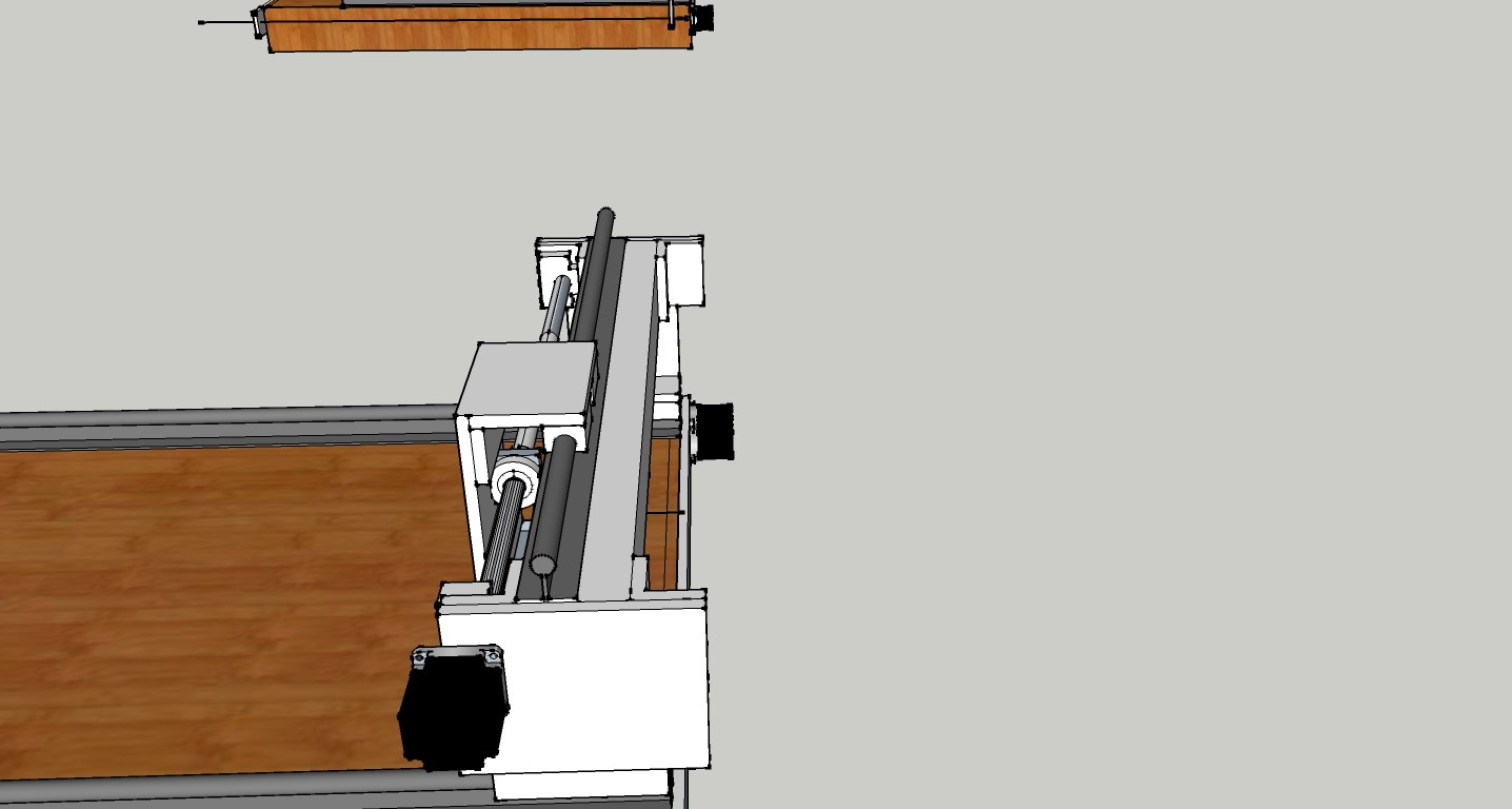

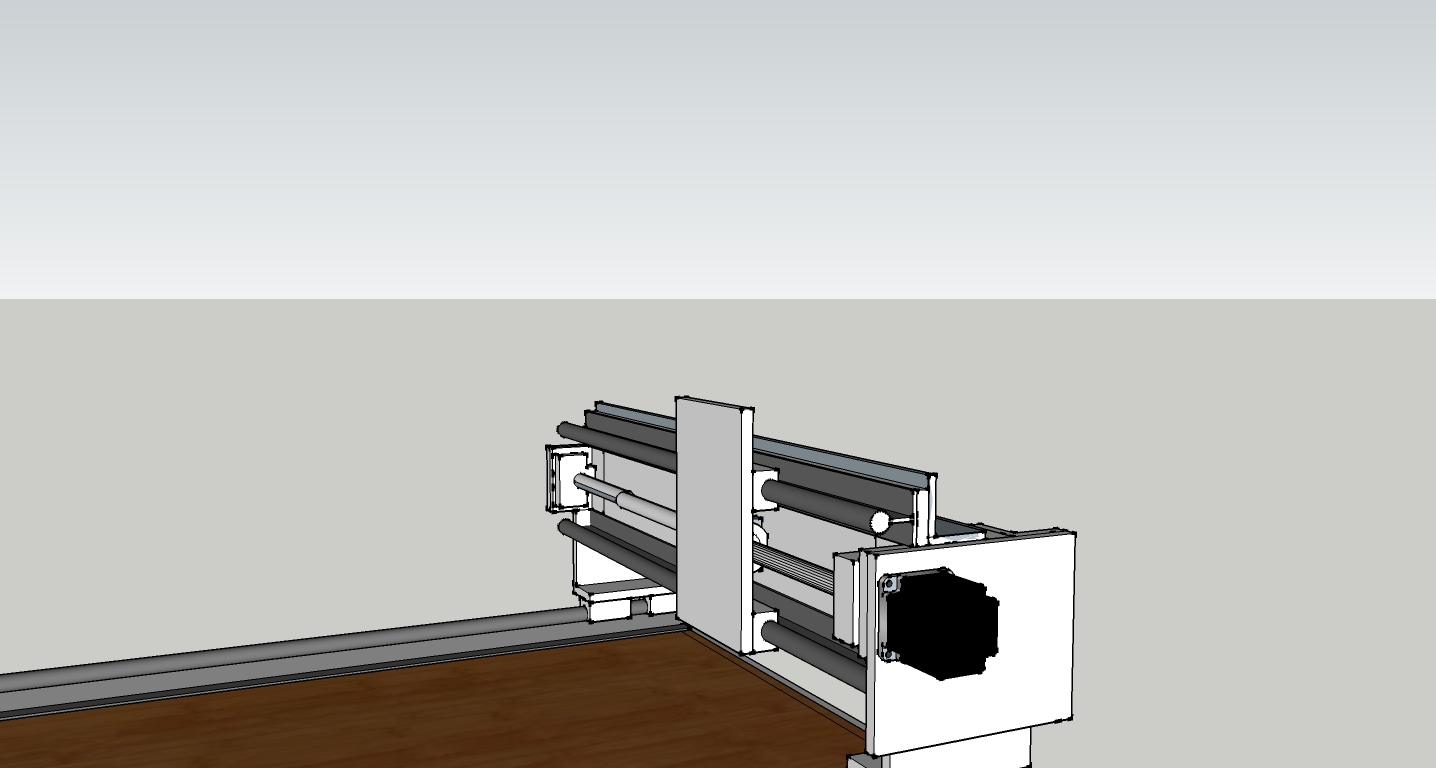

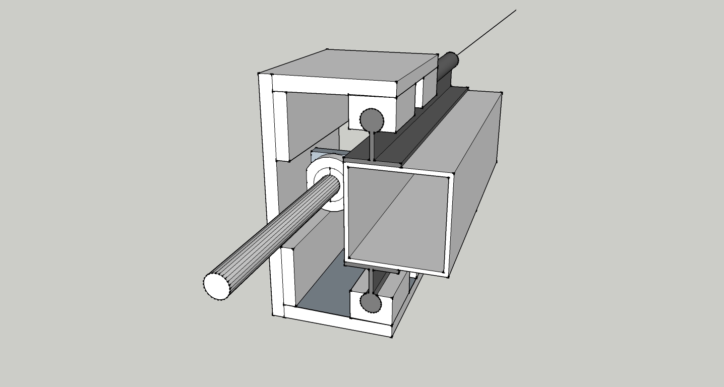

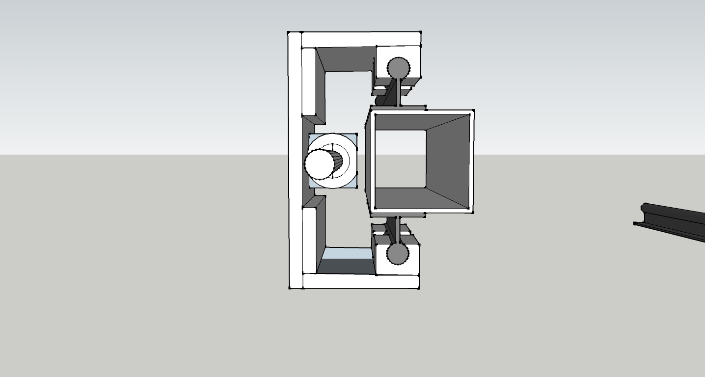

    Quote Originally Posted by motoxy View Post
    Any similarity to Jonathan's machine is purely down to plagiarism.
    Problem with plagiarism is, as they always tell you at school, you copy other people's mistakes! I've put the ballscrew on the Y-axis of my machine in a sub-optimal position, which you've copied! It needs to be closer to cutter / between the rails. The problem is everything between the cutter and ballscrew can deflect, as the linear bearings don't offer much support in that direction. I posted more about it here:
    http://www.mycncuk.com/forums/showth...h-X-and-Y-axis
    (But don't start thinking of two ballscrews like I suggest there - it's excessive! Just put the ballnut on the other side.)

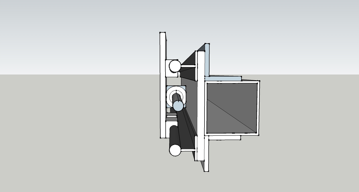

    Right. Here is another thought about the gantry.
Name:	redesigned gantry 4.jpg
ID:	5195   Click image for larger version.
Name:	redesigned gantry 5.jpg
ID:	5196   Click image for larger version.
Name:	redesigned gantry 6.jpg
ID:	5197   Click image for larger version.
Name:	redesigned gantry 7.jpg

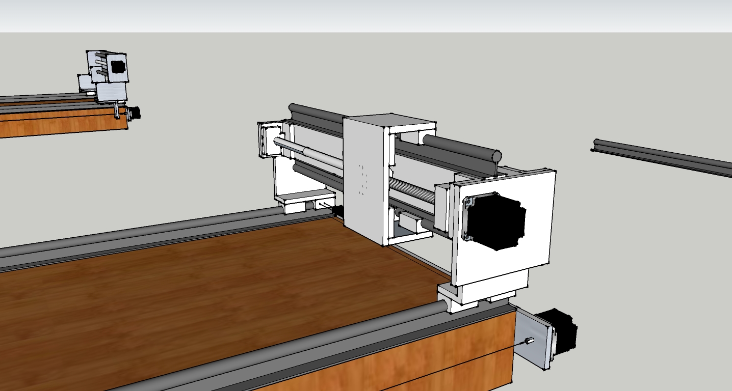

    I did not realise when I started this that it would occupy my every waking moment. This is the latest design, Strange thing is I seem to have gone full circle but added strength to the gantry. What do you think, could this be a go?
    Bruce
Name:	redesigned gantry 3-1.jpg
ID:	5207   Click image for larger version.
Name:	redesigned gantry 3-2.jpg

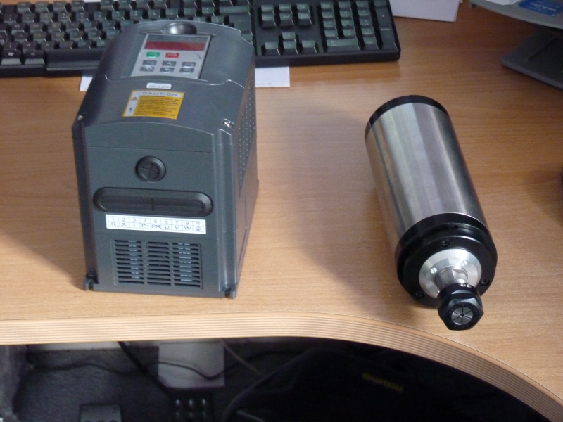

    Just had a knock at the door. Nice man had a package for me. One spindle and controller.
    Just like to say that that spindle is really heavy?? Now have to trawl web for wiring info.
    Bruce (with a big smile)
    Wiring is the easy part, if you struggle it will more likely be the VFD settings you'll want help with.? . . . It's not hard thou and it's all out there. It's been a while since I setup huanyang VFD but if your stuck just ask. . . . Jonathan will probably know them straight off the top of his head.!
