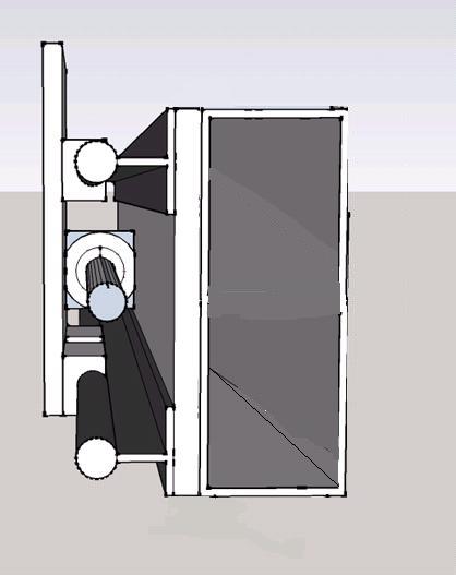

    Hi Bruce,
    In reply to post #73 I would delete the box section and the 2 angle sections. I would then replace them with either an RHS (rectangular hollow section) of similar depth to the plate, or stack one box section on top of the another and bolt the rails&plate to that. Looks like it would be a reasonable fit based on your drawing.
    With the RHS option you could potentially delete the plate, but I think on balance I'd still leave it in.
    Hope this helps,
    Barry

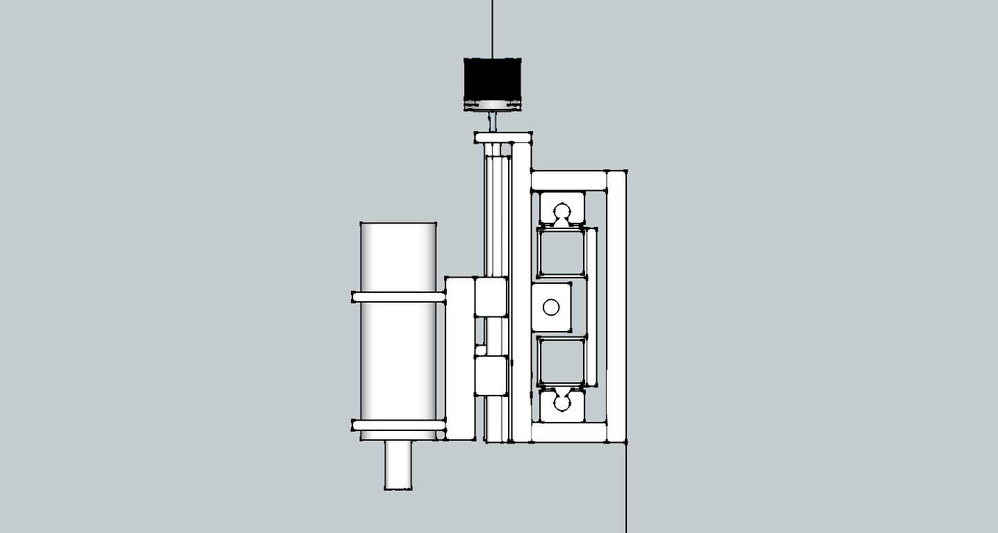

  4. #74
    Like this?
    (not to scale, 3D cad program stopped working otherwise I'd post a proper drawing)

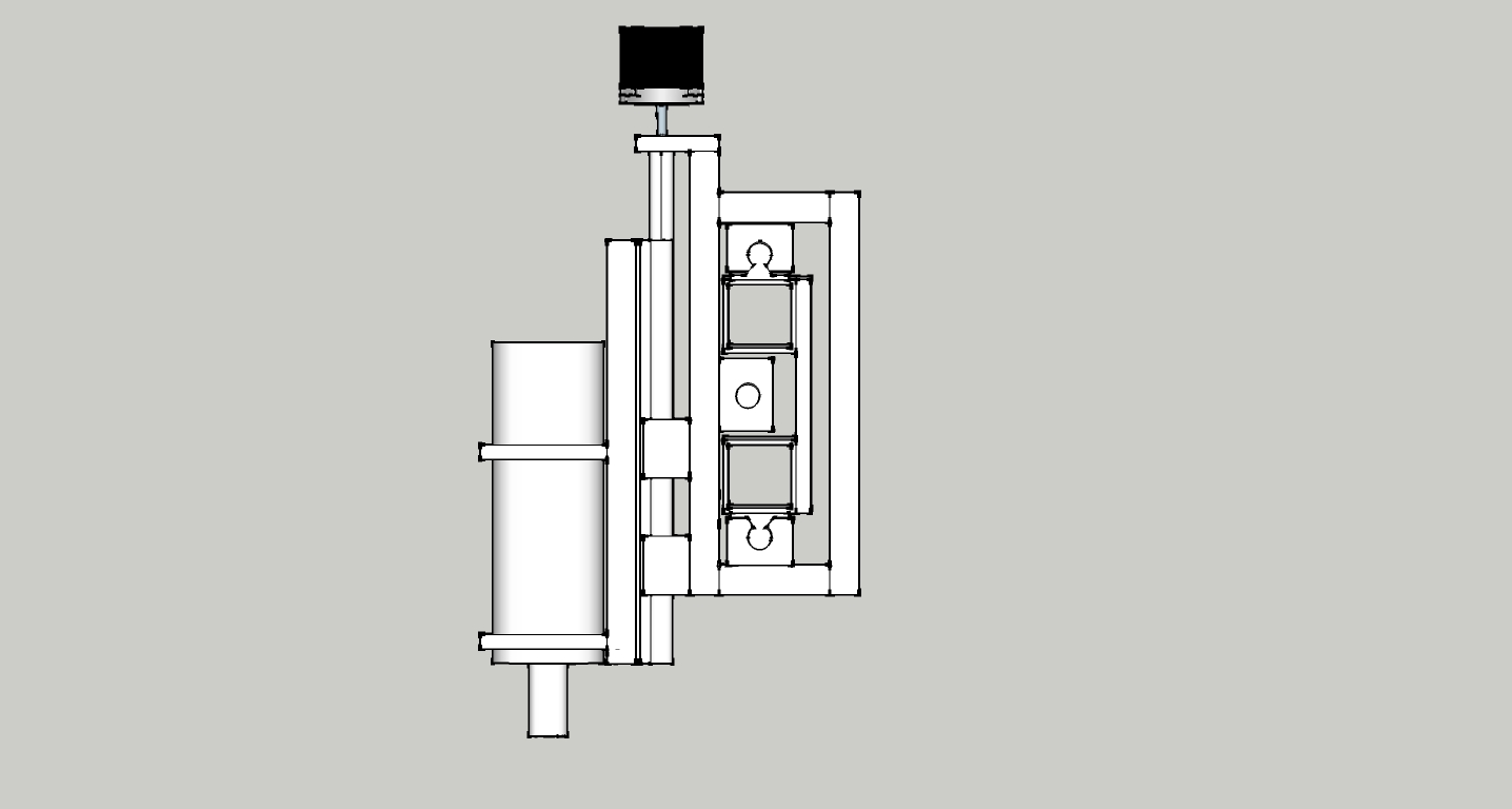

  6. #76
    Right, here is redesign 5-1.
    Obviously I will need to figure out the best side pieces for the gantry. Am I, sorry, are we heading in the right direction?
    Bruce
Name:	redesign 5 - 1.jpg
ID:	5247   Click image for larger version.
Name:	redesign 5 - 2.jpg

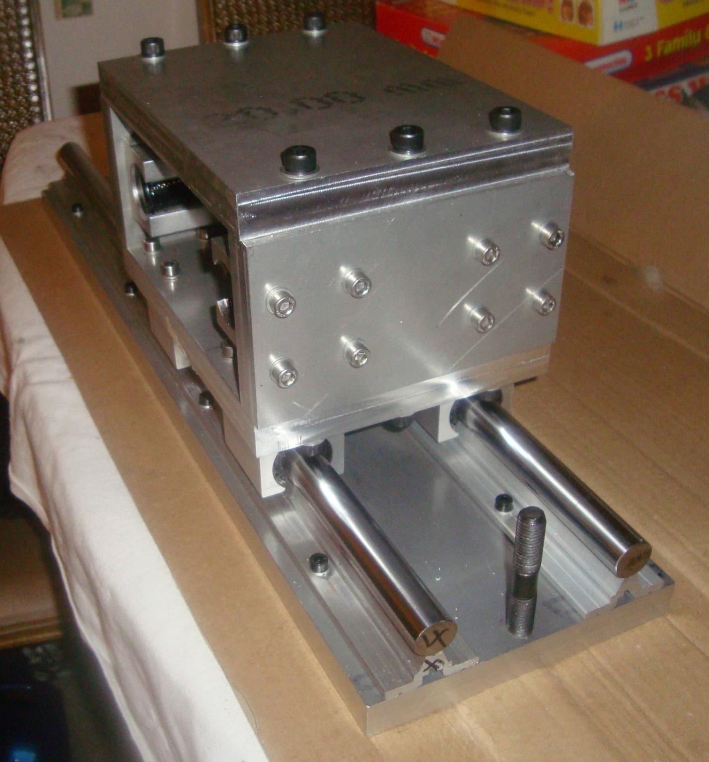

  7. #77
    Quote Originally Posted by motoxy View Post
    You've gone for a pretty generic arrangement now, which is fine.
    It will be stronger to put the bearing blocks for the Z-axis on the Y-axis and the rails on the spindle plate. This sort of thing (mine):
    Between you and mocha I have a pretty good idea about how to progress.
    Time spent discussing his machine was well spent then.

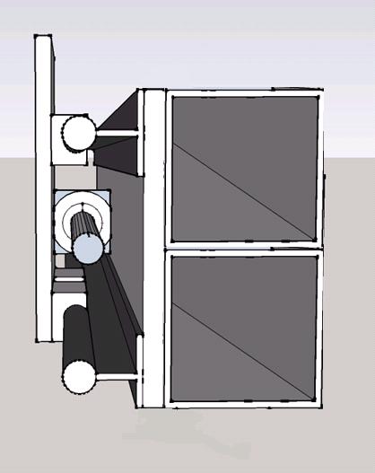

  8. #78
    Hi Bruce,
    I meant one of these to keep your re-design work to a minimum. But what you've since drawn is also good.
ID:	5250Click image for larger version.

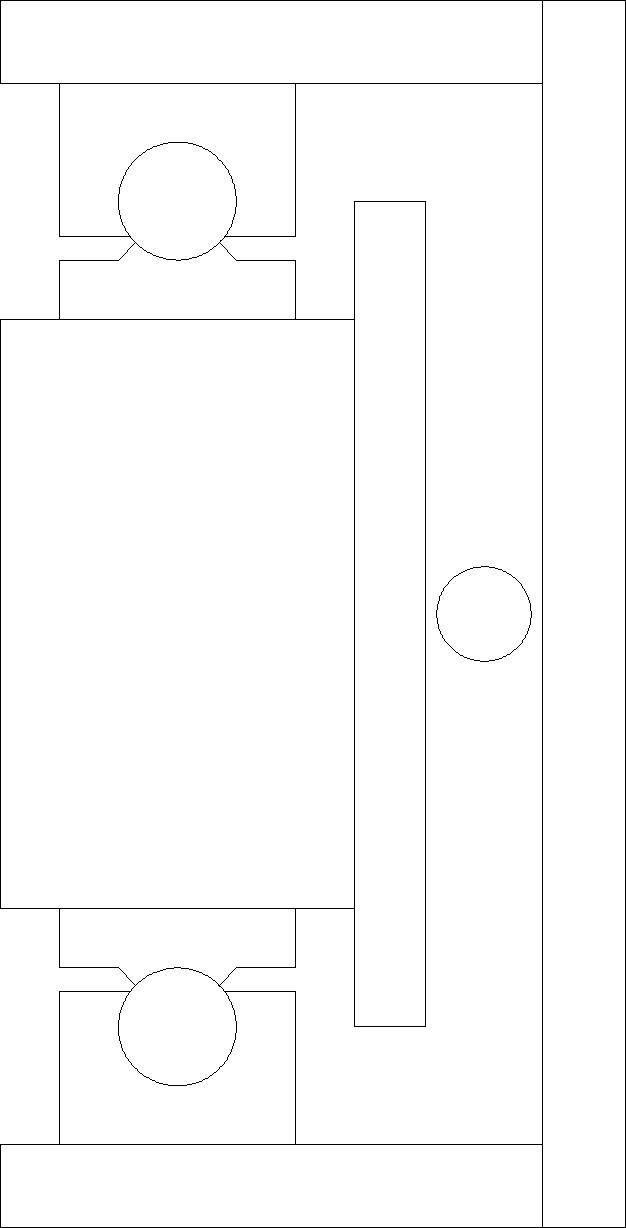

  10. #80
    Cleaned up the drawing a bit and corrected the plate thickness on the spindle mount. I have placed the rails on the spindle plate. I am not sure that I understand why as the increase in plate dimension and the rails being further from the center of the gantry would surely put more pressure on the gantry rails. I am obviously missing something here.
    Bruce
Name:	redesign6 - 2.jpg
