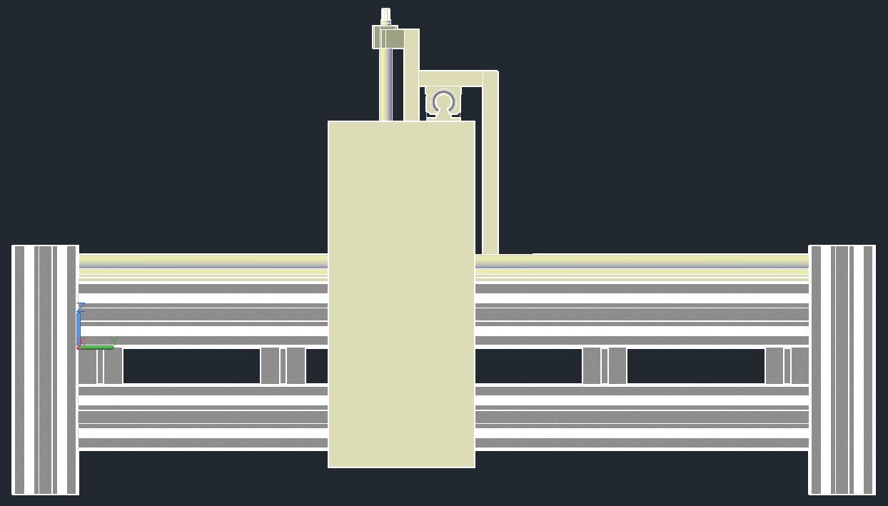

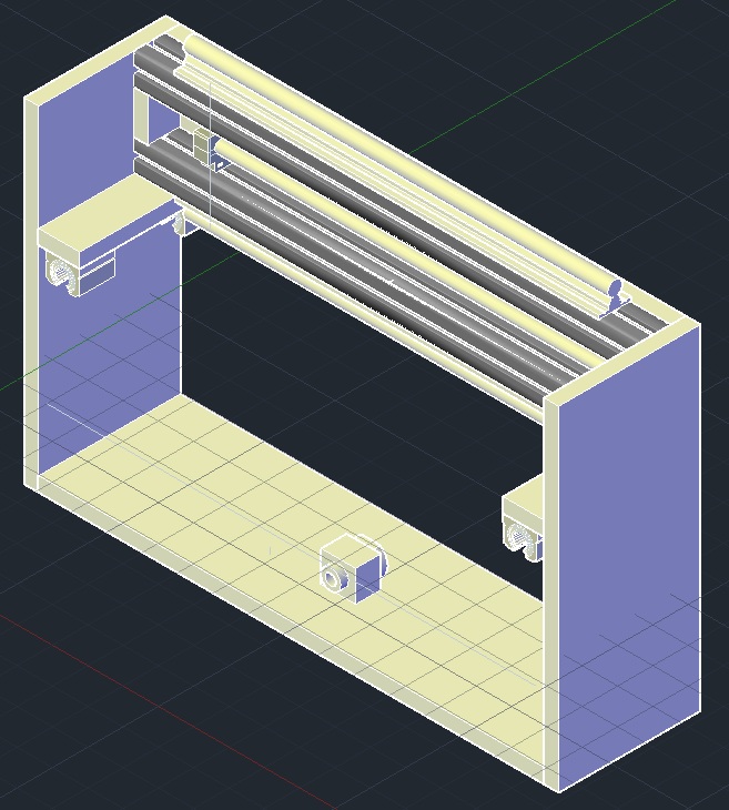

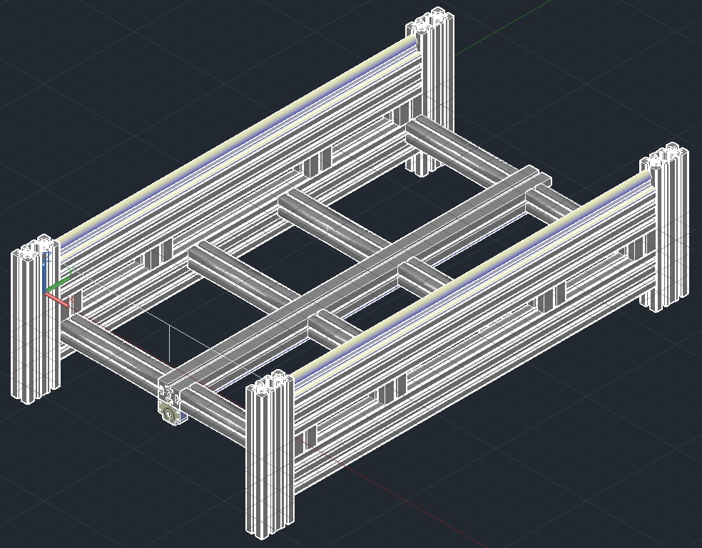

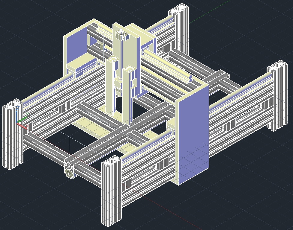

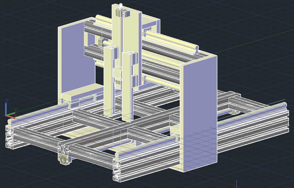

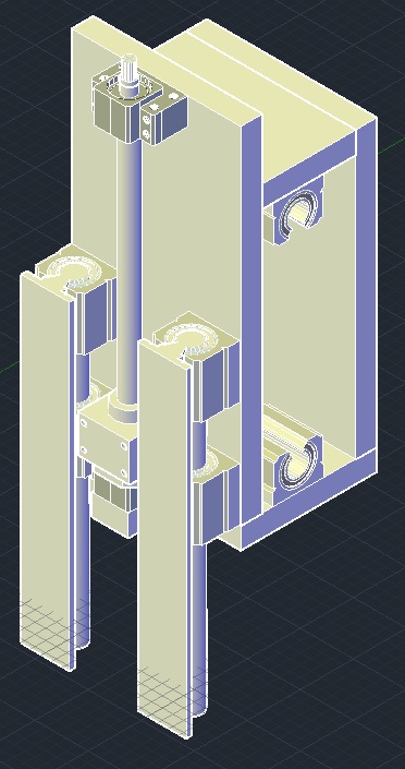

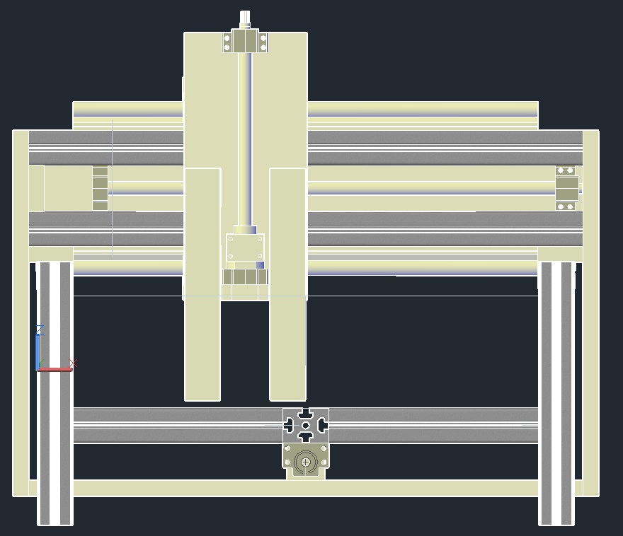

    I've decided to build a metal CNC machine to replace my MDF one.
    I'm going to reuse the supported rail, ballscrews, stepper motors and drivers off it. This means a single ballscrew down the middle of the long axis(I'd call this the Y but I know some people call it the X).
    This is what I've come up with.
    The aluminium extrusion is a mix of 45x45, 45x60 and 45x90. The plate is 20mm. The rails are SBR20 and the ballscrews are RM1605.
    The dimensions are 1180mm x 756mm
    Is it any good?

    Whilst I have access to all sorts of wood working tools and machines the only one that'll be any use building this is the drill press. So I'm hoping someone will be able to machine the plate for me when the time comes?

    In general what you've drawn looks like a pretty strong design, but it's let down by only having one ballscrew on (what you have defined as) the Y-axis. For the width of your machine you really should use two ballscrews, one on either side of the gantry, particularly if you want to cut metals. Currently when the Z-axis is at either side of the gantry (so the limits of the X-axis) and a force is applied parallel to Y, you will get significant deflection. If the bearing spacing on Y is increased, this will help but you would have to increase it a lot to make a significant difference, which is clearly undesirable as you would loose travel.
    Since you need a second ballscrew I strongly advise getting RM1610 and selling the old one since you will get much better feed-rates with the higher pitch screw.
    The Z-axis looks good. You could make the plate on the rear thinner, say 10mm, but it's probably not worth it if you're going to get all the parts cut from a 20mm sheet anyway.

    Thanks for your input Jonathan.
    Do you think the "significant deflection" would be a couple of millimetres or worse than that?
    I wonder if I could make do with one ballscrew to start with and replace it with two later on? Moneys pretty tight at the moment.
    As for the frame design, does having the rails directly under the gantry improve the rigidity, compared to other designs I have seen with tall gantry sides? like this:

    Building it like this would save money but would it compromise the strength of the design?

    Possibly, it's hard to calculate an actual figure as it depends on so many factors. To an extent you can minimise the deflection to an acceptable level by reducing the depth of cut and thus the cutting force, but there's clearly a limit.
    Quote Originally Posted by asbo View Post
    It's not uncommon to do that, although bear in mind the piece of aluminium on the bottom of the gantry is wasted when you do change.
    Your first design with the very short gantry sides is far better than this concept since the gantry sides are effectively replaced by the main frame, which is significantly stronger and can be made so since it is stationary. If you want to save money consider using steel box section for the main frame instead of aluminium extrusion.

    I think perhaps you've convinced me to persevere with the MDF one, although a nice strong metal one is still my ultimate goal. I want it for cutting plastic and wood for custom electronics/computer cases as well as model making. Although I'm sure I'll find the ability to machine aluminium handy as well. :)
    @Jonathan
    I think I'll stick with aluminium extrusion, since it seems a lot easier to work with than steel.
    Thanks for the help, both of you. I'm going to gradually buy bits for metal one, now that I know the design is sound. :D
