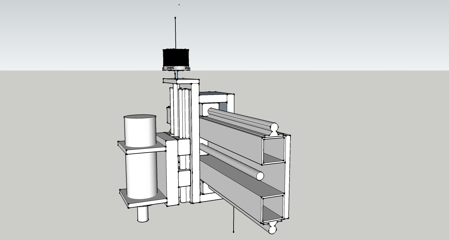

Hi Bruce,
In reply to post #73 I would delete the box section and the 2 angle sections. I would then replace them with either an RHS (rectangular hollow section) of similar depth to the plate, or stack one box section on top of the another and bolt the rails&plate to that. Looks like it would be a reasonable fit based on your drawing.
With the RHS option you could potentially delete the plate, but I think on balance I'd still leave it in.
Hope this helps,
Barry

Jonathan do you ever stop thinking? Between you and mocha I have a pretty good idea about how to progress. I will do a quick sketch and get comments.
Thanks for your help

Right, here is redesign 5-1.
Obviously I will need to figure out the best side pieces for the gantry. Am I, sorry, are we heading in the right direction?

Routercnc - Thanks for that. The latest soluton allows for the screw nut to travel between the rails which keeps the overhang to a minimum. Apparently I still have a bit more work to do on that.:whistling:
Chip - I realise it may be a bit belt and braces but what I have learnt so far is that strength is paramount. The back plate will assit in the end supports and reduce any rotaional force on the boxes....maybe
Thanks for the comments guys
Bruce

Cleaned up the drawing a bit and corrected the plate thickness on the spindle mount. I have placed the rails on the spindle plate. I am not sure that I understand why as the increase in plate dimension and the rails being further from the center of the gantry would surely put more pressure on the gantry rails. I am obviously missing something here.
BruceThe more I know, I know, I know the less. (John Owen)
