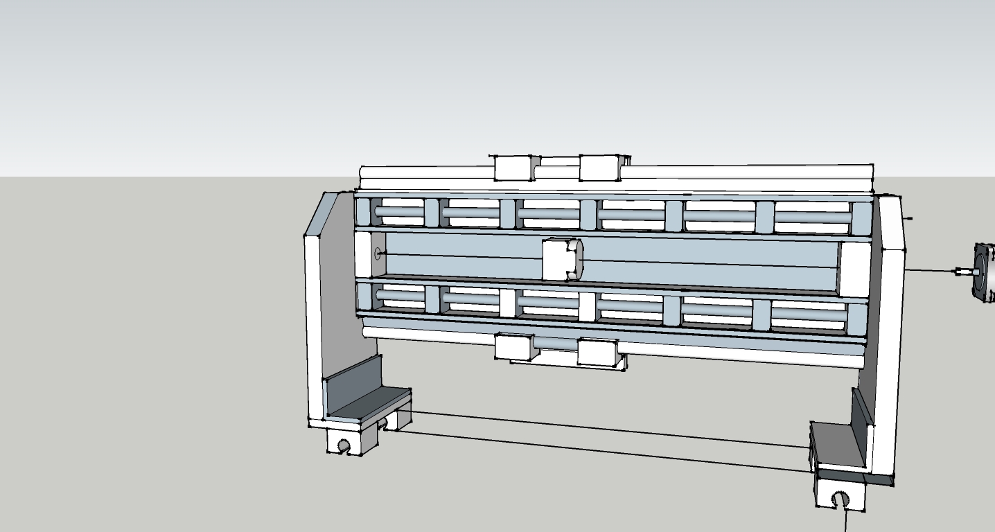

    Okay its sunday afternoon and I have spent an hour chopping wood. You know when you get what you think is a great idea. You rush in and draw it up and think...eerr i'm not so sure.
    I was concerned about getting good fixings in the box even though it is 6mm. Rather then pushing tubes through I came up with the idea of prespacing blocks along a threaded rod and pushing it into the box. Drill through and fix everything. You then have 4 end bolts to clamp up the sides.
    Your thoughts???

    Probably just have a block fixed each end for location and fixing. Drill the opposite side of the box where the rail mounting screws are along the centre line just big enough to hold the nuts to lock the screws through the box. This should not have a detrimental affect on the overall strenght of the box.

    The drawing in post #98 - You should make the joint between the X-axis linear bearings and gantry sides stronger. Currently it's only aluminium angle which will bend at the corner relatively easily, and since the bearings are free to rotate upon the rails that will cause deflection. Perhaps you could use box section there, or better just add some triangular pieces to stiffen it.

    Hi Jonathan, thanks for the heads up on the angle. hard to think I used to be a designer.. Currently being checked over for memory loss problems which probably explains a lot.
