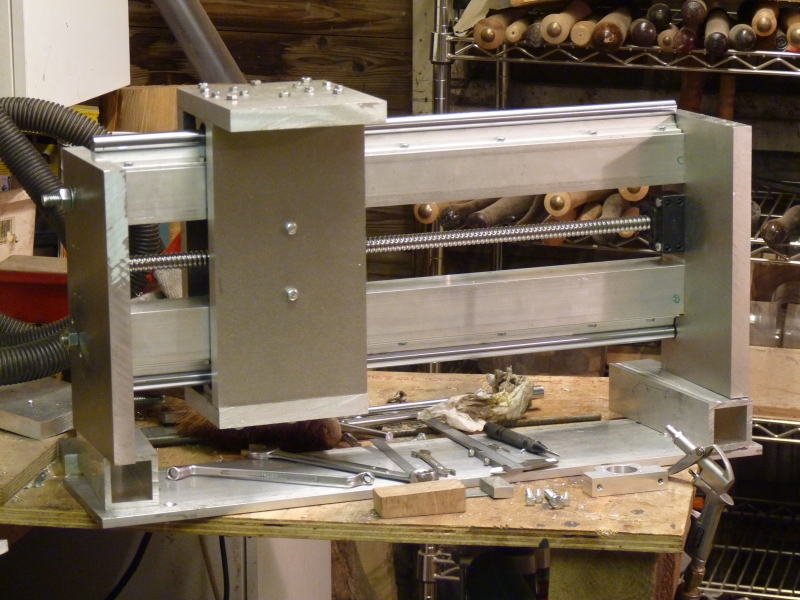

    Just thought you might like to be updated. Thankfully shimming will be at a minimum as most of the crucial measurements seem to be reasonably close less than 0.1 degree.
    Still got to add pads to the base of the sides and bracing on the back.
    Bruce
    In case your wondering I have made sliding fit pads for inside the box. These have been threaded so the tie bars although going right through will not stress the box. Once I am happy with the build these pads will be locked in place with bolts.

  2. Well Done Bruce,
    Coming along well and looking good. Keep it up and it will be running in no time flat.

    Just a quick update. Been busy and work is about to kick in. The y gantry is almost finished, probably another 6 hours should see it done. The z is waiting on Michael Marino's machine becoming available and then we can machine the recesses in the plates.
    Going to see if i can coax my mate to do the welding of the frame for me. So it is progress just a bit slow. Would be quicker if i made less mistakes!
    Bruce
    Next update. Its now a rolling y chassis. The mounting plates above the x bearings will be cut down to size after i know where the ballnut bracket will be located. It does not look much since last time but I must have drilled and tapped 50 or so holes.
