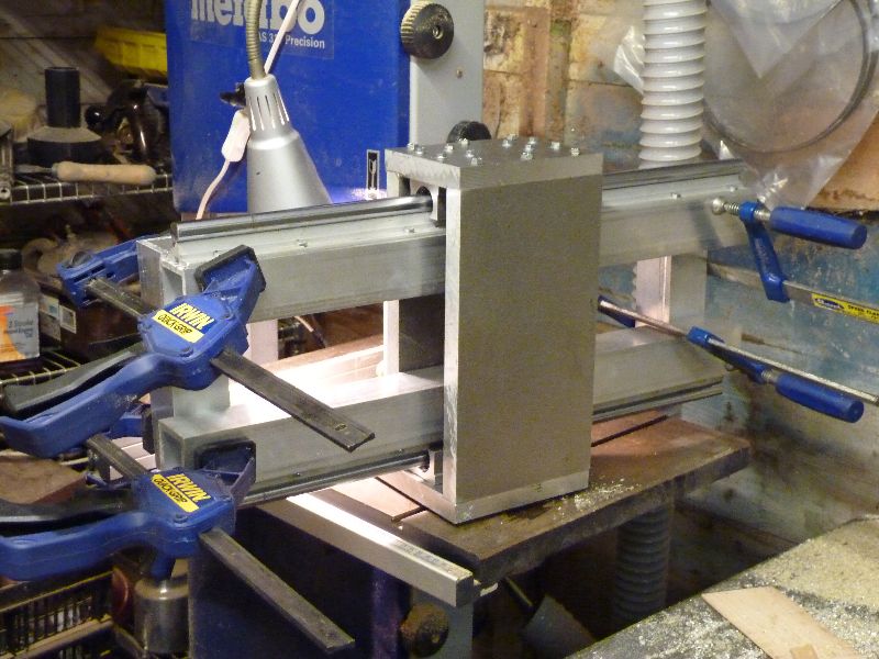

    quick update. Y bearings are in and the rails screwed into the box. I clamped the ends just to push it back and forth and thankfully there is no hint of binding. Mind you I am sure you will tell me what I have done wrong....
    Bruce

    Just thought you might like to be updated. Thankfully shimming will be at a minimum as most of the crucial measurements seem to be reasonably close less than 0.1 degree.
    Still got to add pads to the base of the sides and bracing on the back.
    Bruce
    In case your wondering I have made sliding fit pads for inside the box. These have been threaded so the tie bars although going right through will not stress the box. Once I am happy with the build these pads will be locked in place with bolts.

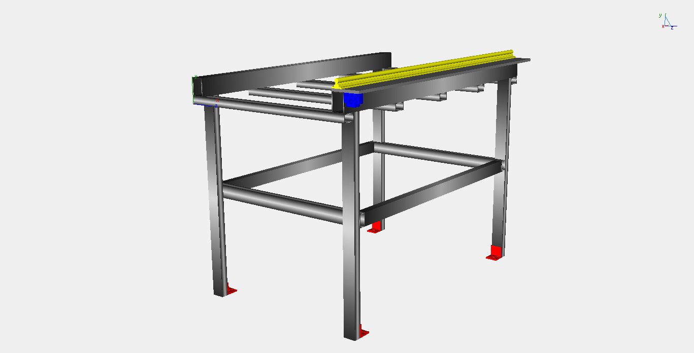

    Just to let you know that this build is not dead I am thinking about the base. Steel box is 50 x 30 and 100 x 50. I intend to fix 10mm ally plate on top with an overhang that will support the screw/ motor. and give it some protection from debris. Therefore the rail and screw are fixed together and the critical factor should be lining up the left and right plates. Fillets will be added on the build.I really ought to start setting up the electrics now but this part does make me a little nervous so listen out for some stupid questions soon. :confused:Bruce
