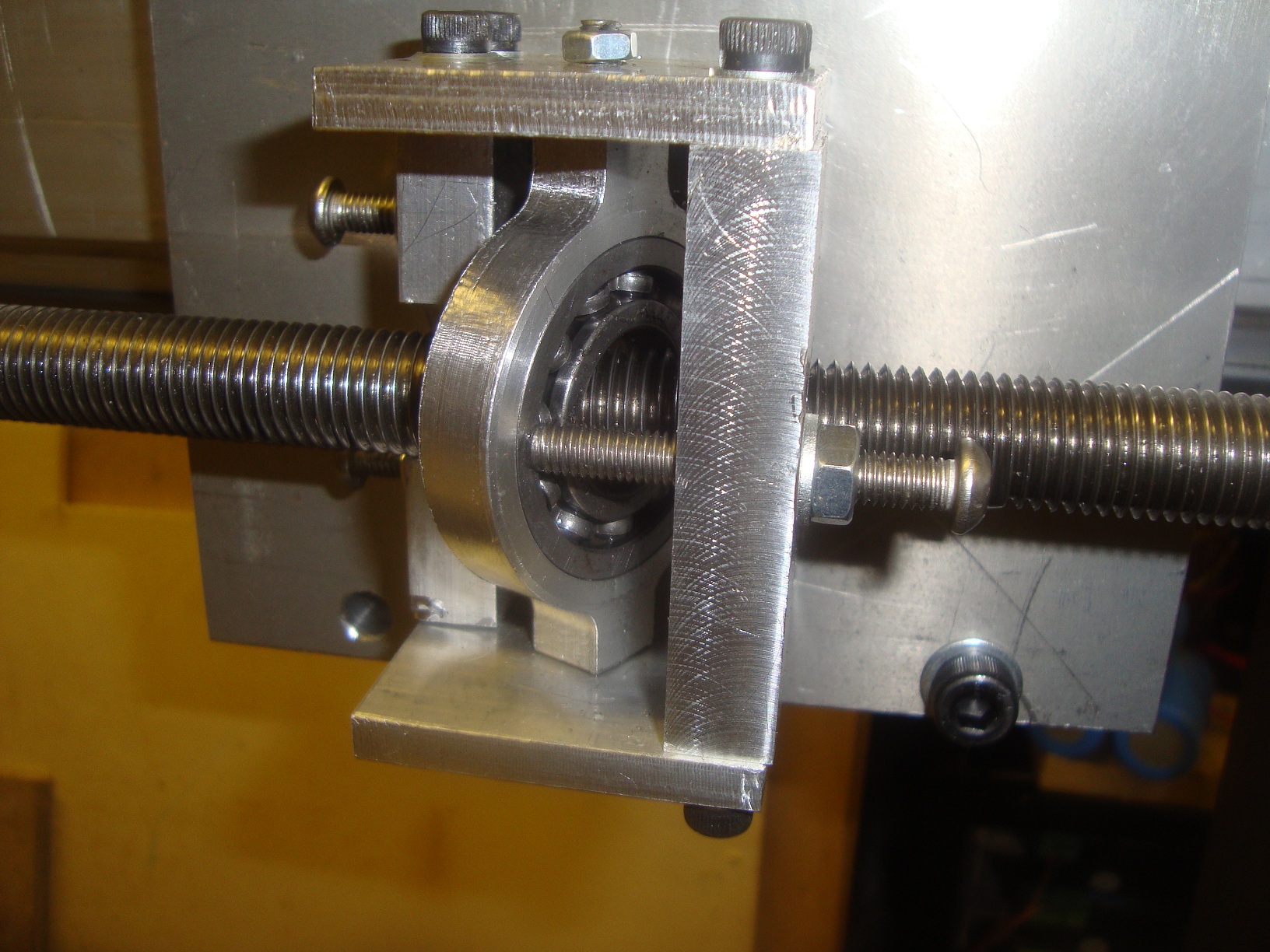

    Jonathan if you read this will your bearing thingy majig work ok on any of these. I'm currently using it on the x with the 16x2 you sold me and it works ok, don't fully understand how it actually works but it does. Would you be able to make a couple of nuts for either of those rods if the bearing does

    It's about £70 including postage for one 1200mm long ballscrew with the ends machined and a nut. About £32 for the trapezoidal screw as you already have the 'nut'. The efficiency of a normal trapezoidal screw/nut is less than half of that of a ballscrew which is why I made the rolling nut as that, like a ballscrew, uses rolling friction.
    The bearing nut thingy (picture below so everyone else knows what we're talking about!) should work better on a trapezoidal screw than the M16x2 threaded rod you're currently using. Just need to make sure it's the right size to engage properly. What's the internal diameter and width of the bearing, or just the number on the bearing?

    Did you add the springs to it as I suggested?
    The bearing nut thingy (picture below so everyone else knows what we're talking about!) should work better on a trapezoidal screw than the M16x2 threaded rod you're currently using. Just need to make sure it's the right size to engage properly. What's the internal diameter and width of the bearing, or just the number on the bearing? Click image for larger version.

ID:	5179 Did you add the springs to it as I suggested?[/QUOTE Thanks for the reply Jonathan, I've not used springs and it seems ok, i will check the bearing tomorrow for a number. The pc running everything gave up today so i went and had a few pints instead. Only just realised what you were saying about the price, i.e trap screw against a ball screw
