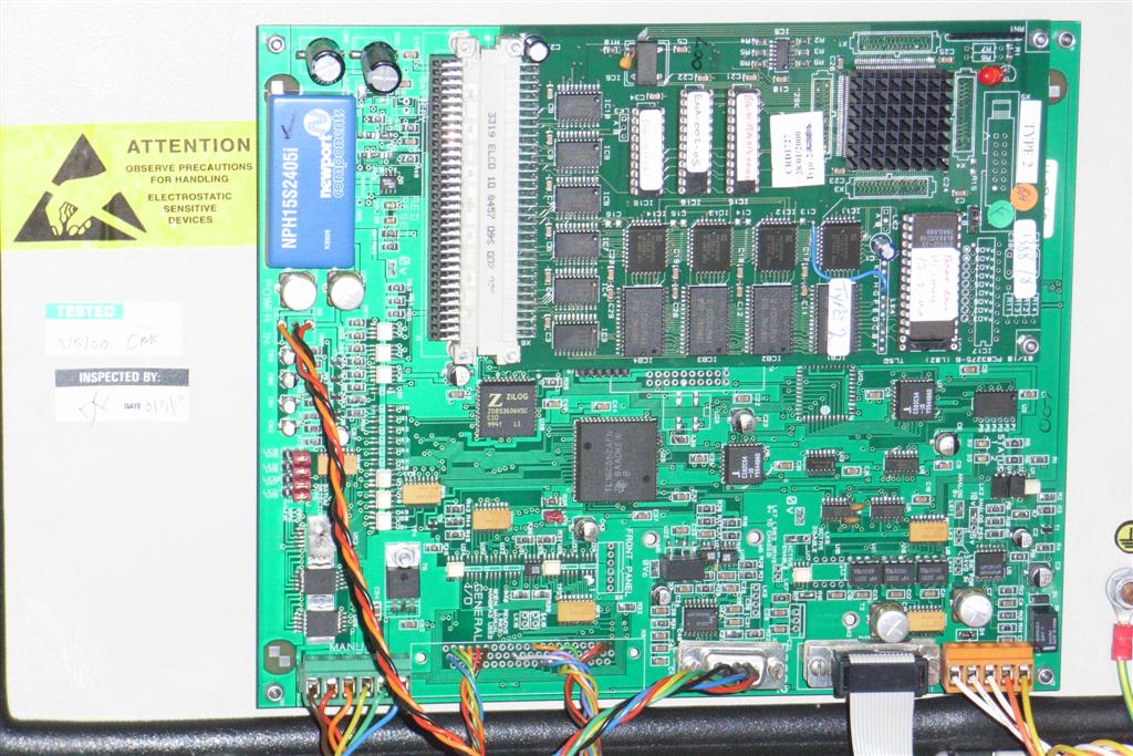

    I recently purchased a second hand HME Technology router with an NEE AMC-E controller fitted. It came supplied with a PC with WinAMC installed and an RS232 cable but so far I have been unable to run it.
    The guy who sold it had no knowledge of it as he never used the machine as it was purchased for a job that later fell through, but he assures me it was working when first installed.
    When powered-up, the controller board has an array of green LEDs with just one red on in the lower right corner of the processor

    Once powered-up in this state there is no power to the steppers with the E-stops cleared. The control software is WinAMC but menu items such as 'options' & 'configurations' are greyed out. The machine functions such as jog & spindle are also greyed out. I have also noticed that in the bottom right hand corner the WinAMC screen there is a yellow triangle with an exclamation mark in it.

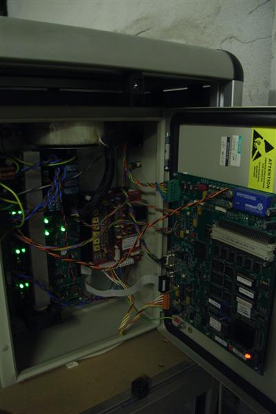

    Well don't get too carried away ripping stuff out as you may only need to replace the line driver part of the circuit boards with a breakout board? Could you put some more detailed pics of the control unit inside? it could be cheaper to upgrade than getting it fixed?

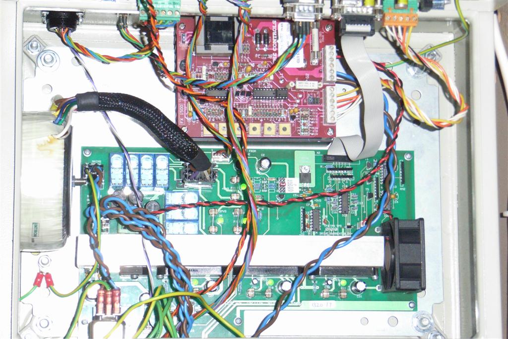

    Here are some better pictures of the control panel:

    To be honest I don't know anything about these except that I'm pretty sure the second picture is the driver board & spindle control (red board). Would I be right in guessing the first board does the processing? Is the function of this board now being replaced by the PC & CNC software?

    Personally I'd strip it out and replace with modern drives, Bob etc and control software like Mach3 or EMC.!
    The time spent chasing how to get this working could be better spent cutting returning your investment quicker. . . . . Probably perform better as well with modern drives.?
    Edit: What model router is it.? . . . . . These educational routers are full of safety feature interlocks etc and it could easily be one of these that's faulty and locking you out.?
    I'd check out all safety switch's limit's, estop's, cabinet door switch's etc or for quicky elimination purpose's even look to tempory by-pass them. . . . Often it's the little things that shut the whole job down.!!
    If the existing stepper motor driver board takes step/direction signals then it's straightforward to get mach3/emc to work and you wont need the big board. However that's not immediately obvious from the photos. I doubt they'll be good drivers anyway - though that's not a problem if you're working within the original specification.
    You could get 3 new stepper drivers and just forget the rest of it, except maybe the spindle board - looks like there's some writing/numbers you could look up to see if there's any info on that? Look what model number and/or ratings are printed on the stepper motors then so long as the datasheet is available we can work out which drivers will be suitable. Also check what voltage and VA (or approx dimensions to guess VA) the toroidal transformer is as you may be able to reuse that.

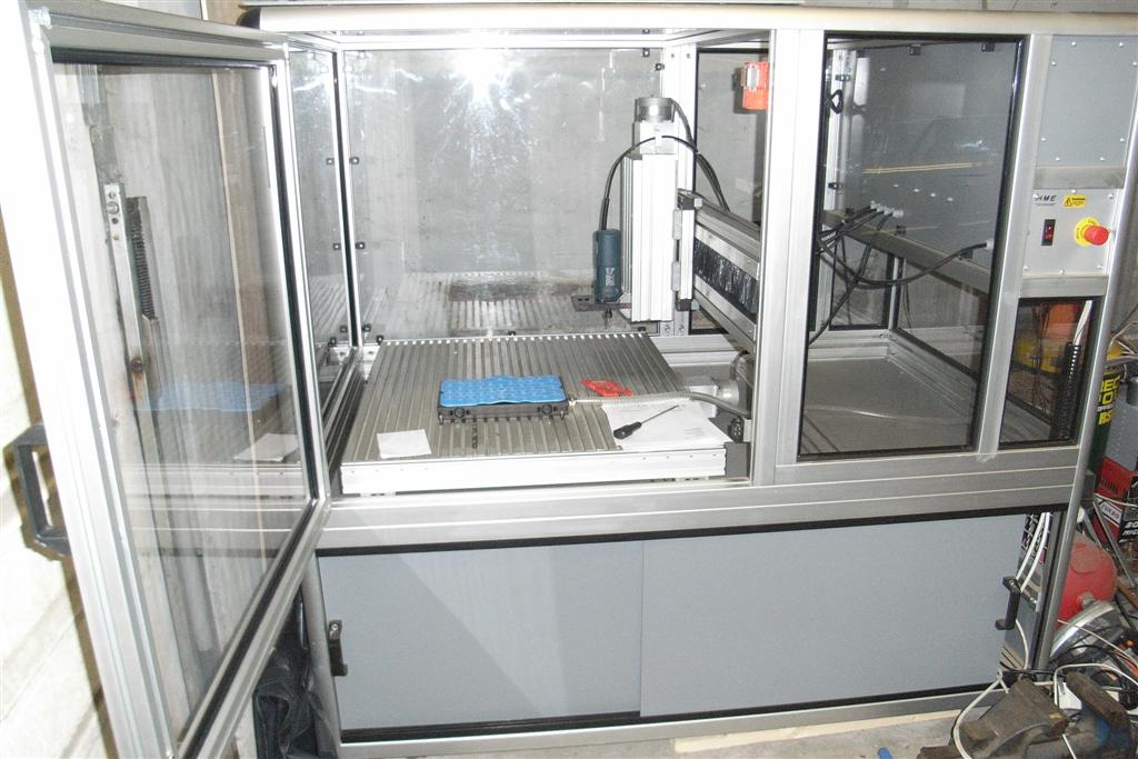

    This is the machine, but no model number anywhere:

ID:	5220 A floor print of 6' x 4' x 5 1/2' tall. I haven't fully stroked the drives as I was scared of sending a reverse voltage through the driver board, but I'm estimating 600x600x200mm.
    So far HME haven't come back to me, but I'm thinking along the same lines as you guys. As Jazz says, it is crawling with safety interlocks that I will disconnect to save my sanity, but I have gone through the safety circuitry & it is all in place. When all contacts are closed the driver board axes all light up green.

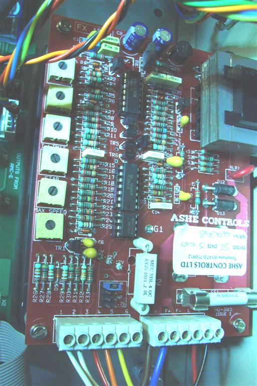

    I forgot about the spindle board!
    This is it, an Ashe Controls FX1500

    The current spindle is a 500W Bosch which looks like the back end of a 4" grinder. Does this board allow for spindle speed control? If it does, that is a feature my Heiz doesn't have with the Kress 1050 motor.
