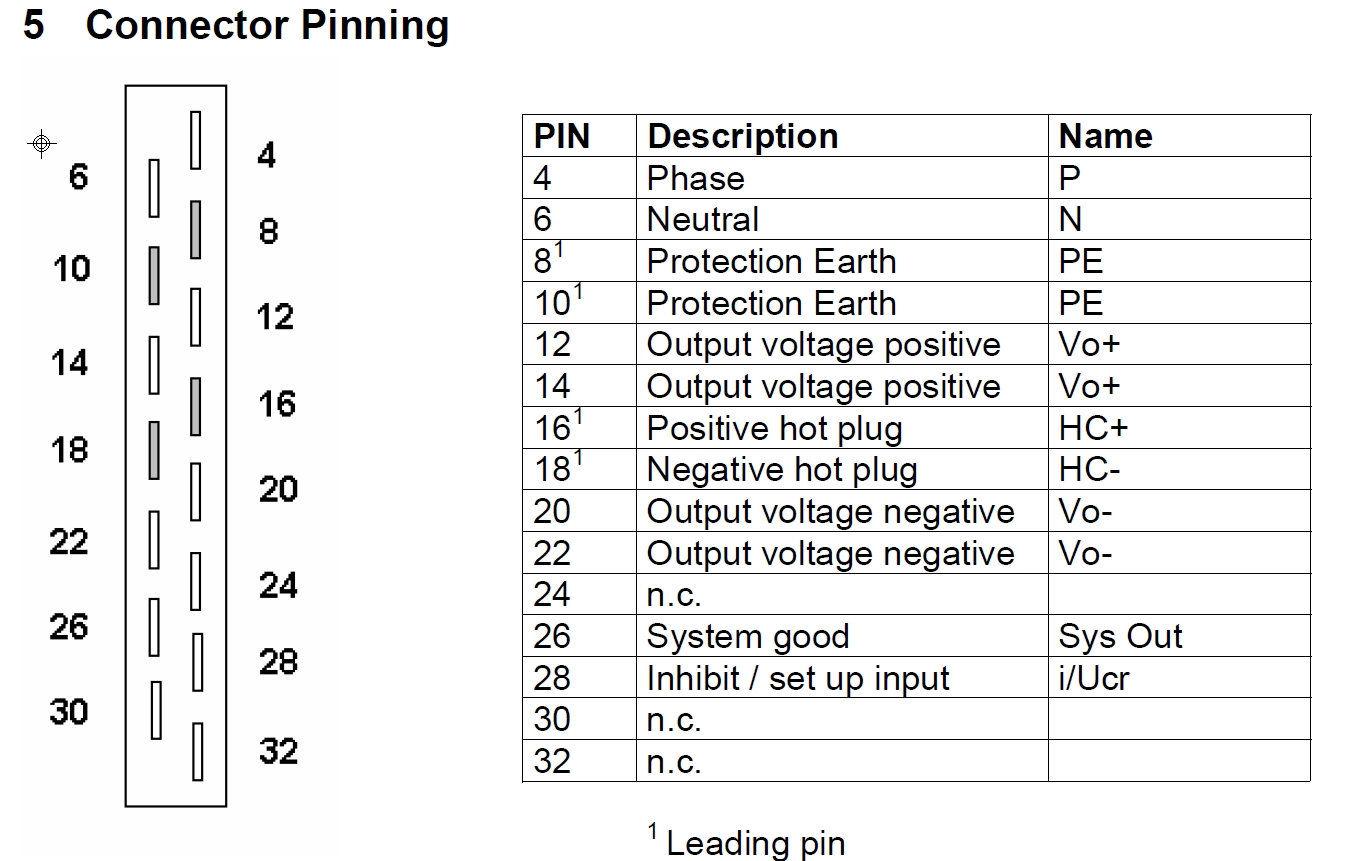

    I received a few bits through the post today, namely an EP002 power supply, 3 PM542 drivers & a 5 axis breakout board. I do have a few questions though if anybody can help please.
    1. On the EP002, do I connect the two 43V O/Ps together in parallel (12 to 14 to driver+ & 20 to 22 to driver-) or is this totally wrong?

    2. Do I need to connect the ENA+/- on the drivers to anything?
    3. With my 8 lead, bi-parallel connected, 1.7A unipolar motors, do I set my Driver O/Ps to 3.31A?
    4. What rating of fuse do I need to connect before each driver? I'm a bit confused whether I need to use 240v fuses & at what current.
    Many thanks in advance!

  6. #36
    Gavin
    Just use either of the spades for + / - on the supply, they are connected together anyway. What motors are they? better to check the spec of them first but if you have no info then better to be just under the current rating and see how they perform. As for fuses i did not use any on mine so won't comment on that but i'm sure one of the others will?

  8. #37
    1,3) As 2e0poz said, but probably 2.4A as bipolar parallel current is 1.4 times unipolar current.
    2) No, floating is fine.
    4) Do not put fuses between the PSU and the stepper drivers as a break in connection between them could damage the driver. They have internal protection, so just put a fuse on the mains input.

    Well I got it running last night
    I had to install EMC2 as I couldn't find anywhere in WinPC-NC to configure the port pins for the motors. I/P & O/Ps yes, but I have a hunch that my version is setup for Heiz machines only. Anyway, I'm finding EMC2 great! It's running, homing, backlash is dialled out of X & Y (0.04mm) & my VCarve pro EMC2 post processor is working great with it. Now I need a spindle. I am thinking about one of the water cooled Chinese ones but I'll order a Kress 1050-1 in the meantime as it will be a backup for the Heiz. My Original Kress has thousands of hours on it with about 6 changes of brushes, so I think it would be a wise move. It'll give me time to think what I'm going to make in this machine :lol:.
    Many, many thanks to you all who helped me out on this project :clap: Such a great forum!
