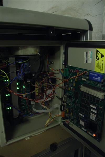

I recently purchased a second hand HME Technology router with an NEE AMC-E controller fitted. It came supplied with a PC with WinAMC installed and an RS232 cable but so far I have been unable to run it.
The guy who sold it had no knowledge of it as he never used the machine as it was purchased for a job that later fell through, but he assures me it was working when first installed.
When powered-up, the controller board has an array of green LEDs with just one red on in the lower right corner of the processor
Name:	AMC-E Controller (Medium).jpg
Once powered-up in this state there is no power to the steppers with the E-stops cleared. The control software is WinAMC but menu items such as 'options' & 'configurations' are greyed out. The machine functions such as jog & spindle are also greyed out. I have also noticed that in the bottom right hand corner the WinAMC screen there is a yellow triangle with an exclamation mark in it.
I don't know the setup of this machine, but I do wonder if the AMC controller requires a signal from WinAMC on the PC to fire up the steppers.
