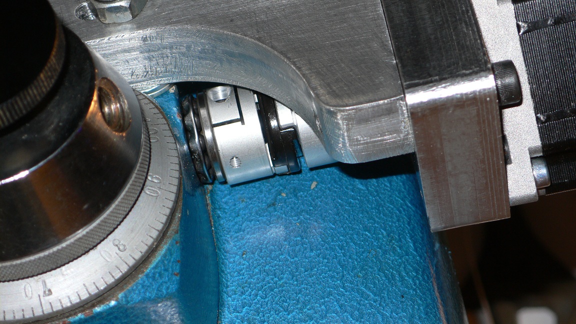

    X axis - doesn't look too bad but the coupler is pretty rubbish so it'll need remaking.

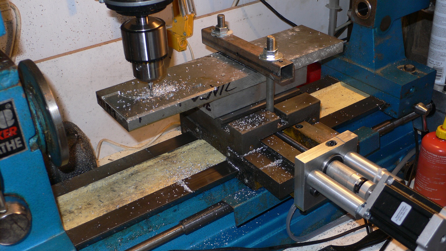

    The Y axis works quite well apart from the tendency of the axis to bind if anything other than the vice is bolted to the milling table.

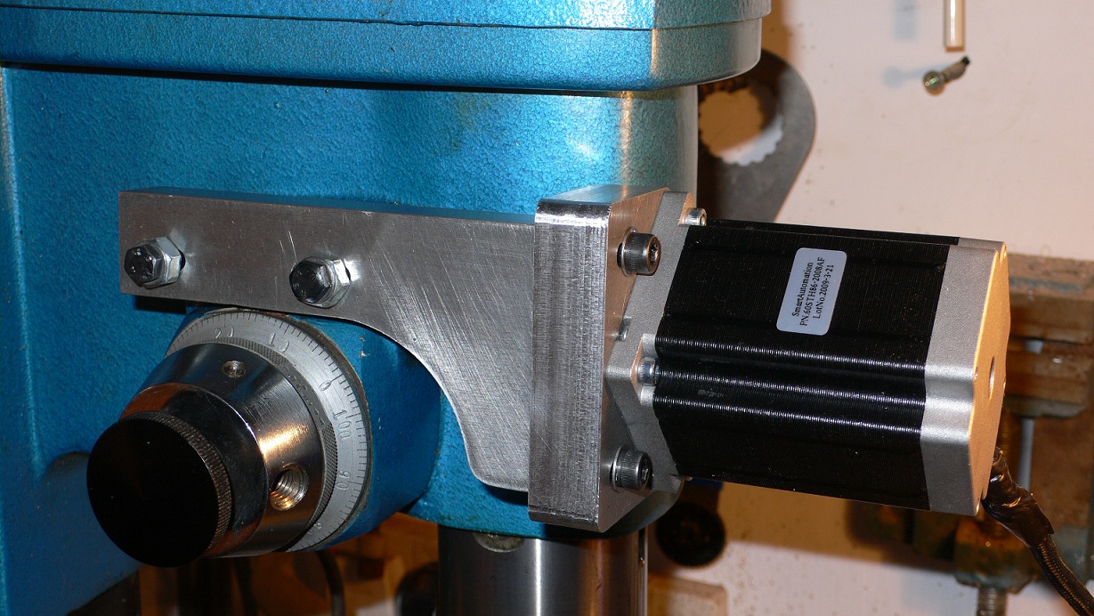

    The Z axis will make you wince but it's accurate enough to make the proper brackets which would take ages by hand.

    It's actually working a lot better than I thought it would. Backlash is approx .016mm on the X and Y axes and about 1 mm on the Z (and it wobbles) but that should be sorted soon. The worm gear from the existing fine feed will never provide great accuracy though so I may need to go to an external leadscrew.

    Looking good, next i would look at making a new mount for the last pic/motor. Maybe somthing that fits better to the shape of the machine, like the part you have made in wood but turned the other way with a flat to mount the motor to ?

    I should have made myself clearer - the quill is fine (good even which is a surprise) it's the bracket that wobbles (very visibly when plunging). I've already used it to make another one in aluminium which I hope to fit tonight. There is a return spring on the quill which, as you say, could be stronger - I think machining grabby materials could be a problem but there is a lock on the quill I can use if necessary and the idea of a supplementary spring is a good one.

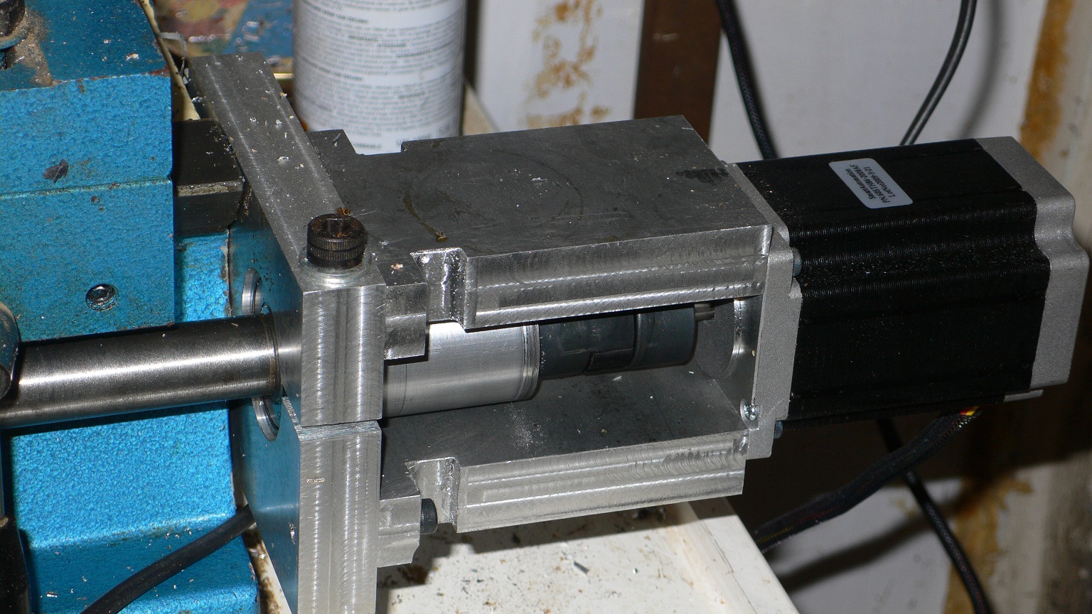

    Well the Z axis bracket has made a big improvement.

    Though the exposed thrust bearing with one race missing is still a bit grim :-) Must get a needle roller equivalent.

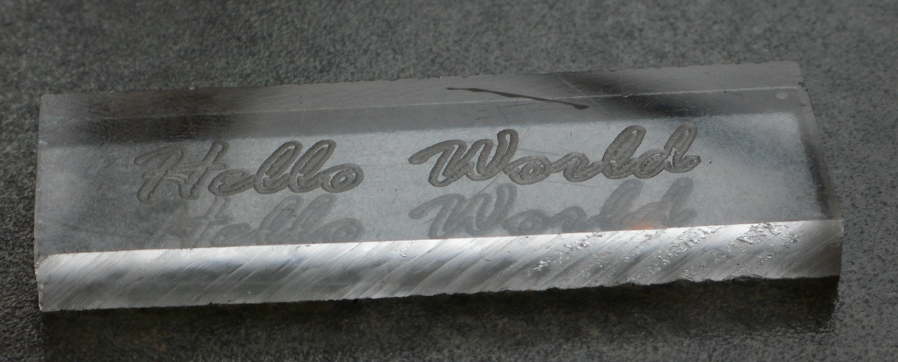

    Running an 8mm spotting drill at far too slow a speed got me this

    Need to look into smaller bits and a Dremel adaptor for this sort of work but I'm quite impressed so far - the EMC2 anti backlash algorithm was very evidently working during the making of this.
