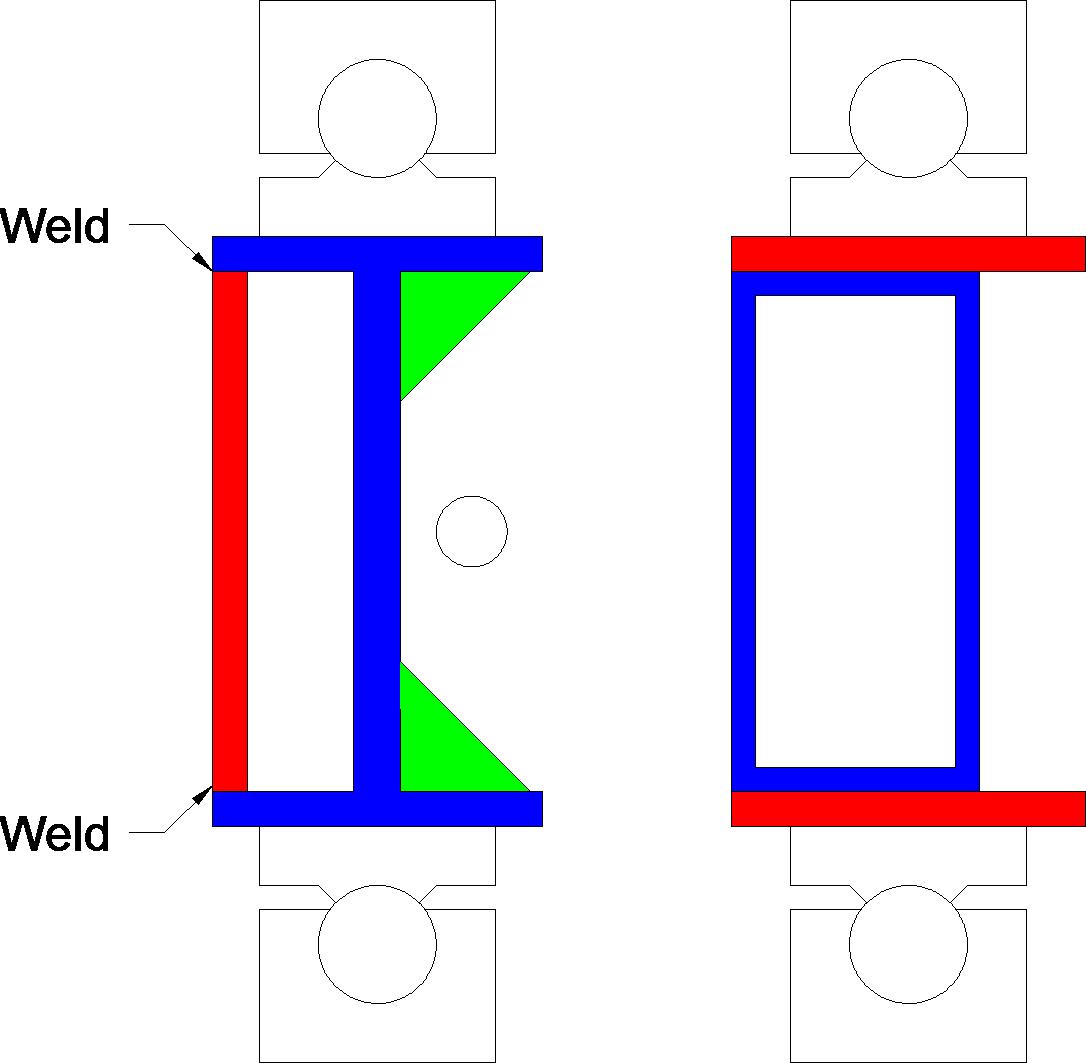

Same here. Thought that it was obvious that you just make it as strong as you can afford. I made mine as strong as I could afford at the time, but not as well as I could and I've been waiting for the funds to improve it for some time.
One last thought:
You could weld a steel sheet (red) on to the back of the RSJ (blue). Then you've got the torsional stiffness of box section and the convenience of RSJ. It needn't be very thick, I think 3-4mm sheet would be fine. Adding several of the green triangular pieces might help, but it's a lot of effort to cut them out without a guillotine. Only problem with all this is the welding might distort the top surfaces, so it's best to do it from the start.
Other option is use box section but add plates on the top and bottom so that you can put the linear bearings off center to get the ballscrew in a good position. Not sure which would cost more...
