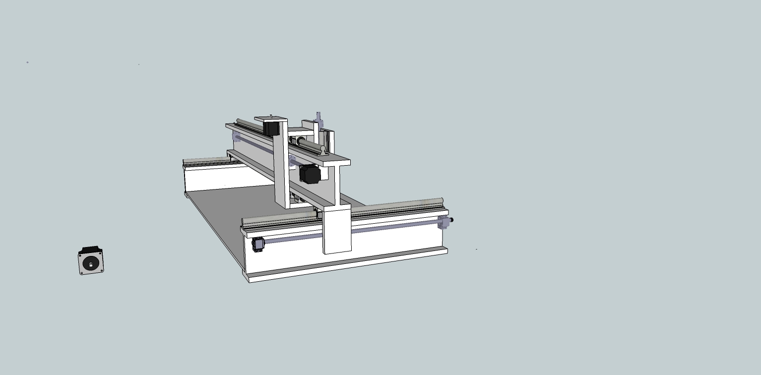

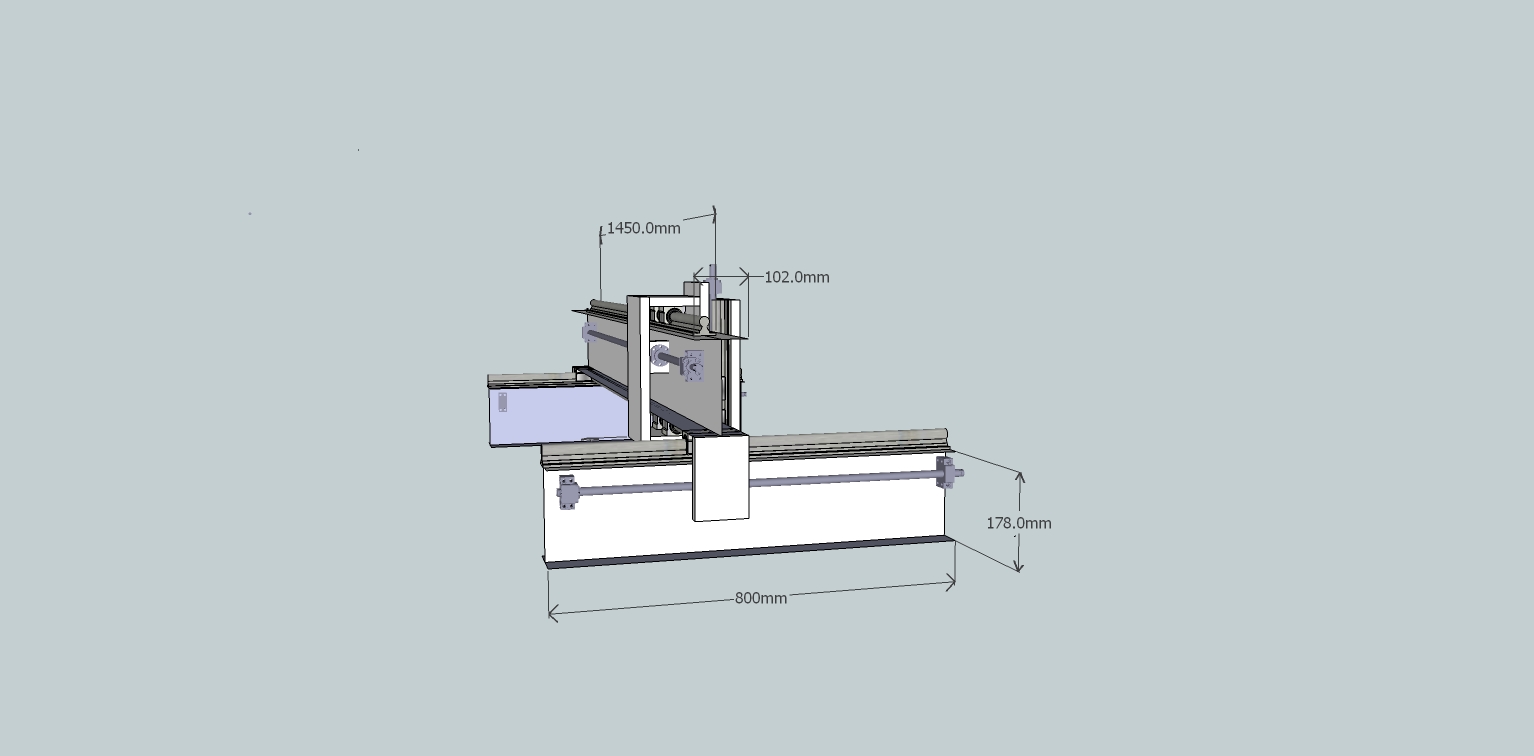

    Ok, here is my latest attempt, trying to incorporate every thing that has been suggested. So i will be using 20mm supported rails on every axis and 1610 ballscrews on every axis, along with belts and pulleys. The 2 rsj's will be 178mmx102mmx19mm and the gantry is 100mmx60mmx3mm steel box section. The gantry end plates and bearing plates are 20mm steel. The Z axis will be using 20mm ali plate. I have spread the gantry bearings out as been advised. Hopefully the drawings with dimensions will help.

    The rails are 300mm,800mm and 1400mm. The screws are 350mm,800mm and 1450mm long
    Also now confused after reading comments on the other post about the "effect of forces on gantry cross sections" and the following was mentioned-
    I don't like box section for gantry's has it can produce resonance and vibration unless thick walled.? The bolted together extrusions are far denser therefore absorb vibrations far better.!! . . .Any resonance will transfer thru to the finish.
    Am i going round in circles
    Ok thats good but bring the screw to the front, will be much stronger having the ball-nut close the Z Axis back plate.
    Have you got the 20mm steel plate.? If not I think you'll maybe change your mind when you see the price.!! It's not really needed either and I'd use ali for easy working.
    Ok, thats no problem, i will do that. Is this to prevent racking etc
    No i haven't got any steel plate and a quick google has made me change my mind, but if i use ali how would I join this to the steel gantry?

    Dean don't worry about it your only cutting wood the box section will easily handle it. The box can resonate but cutting wood it won't really matter or show.
    There are also ways around this if it does by filling with sand. So long has the resonance doesn't affect the motors then you won't have problem and because your using belts then this won't happen and why it's good idea to use belts.

    Dean if your intention is still the same has before to only cut wood then ignore Jonathan he's talking over complicated bollocks again and it will easily do the job.
    If you can get the Large box section for a tenner then obviously it's a no brainier and go for it.! . . Not disputing Box section won't be stronger but no where near has cheap or easy unless you can drop on something like this.
    The RSJ will do the Job no problem the extra mass will help with cutting but does cost in acceleration and speeds.
    I would how ever change the way you have the X axis bearings and use wider plate than the RSJ which bolts to it. I would then have gantry end plates which bolt to the RSJ and the bearings plates dropping down so the ballscrews can connect. This will help stiffen things up a bit.!! . . . Pretty much like I drew before.!
