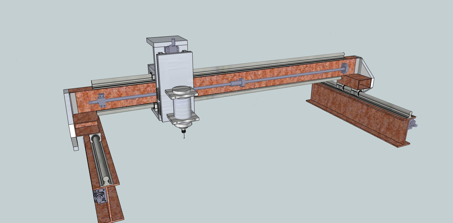

    Hopefully this will work. I hoping to have the Y axis 1500mm long and the x 850mm, this will help with the space i have available and will make it easy with placing the work material. i have 16mm rails,16mm screw on the x. 20mm screw and 25mm rails on the Y axis and i was thinking 16mm screw and 16mm rails on the x axis. This will sit on a steel box section frame. Have i got it right or wrong:confused:. Also going to use belts and pulleys, that's 45x 45 ali profile and 20mm ali plate as well

    Hi Deanos,
    Looks like a 'landscape' format machine with such a long Y axis gantry. 1500mm is quite a long span for a pair of 45mm profile sections. You could double the (torsional) stiffness if you go for 'portrait' format and have an 850mm gantry, although you do mention that you want to make it easy to load material.
    If you want to continue with this style then here's Joe's cnc in case you haven't seen it, which is very popular:
    http://www.joescnc.com/themachines-hybrid.php
    Any thoughts on how you will attach the X axis drive system (pair of leadscrews I assume) to the gantry sides?

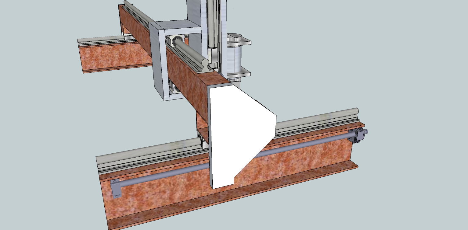

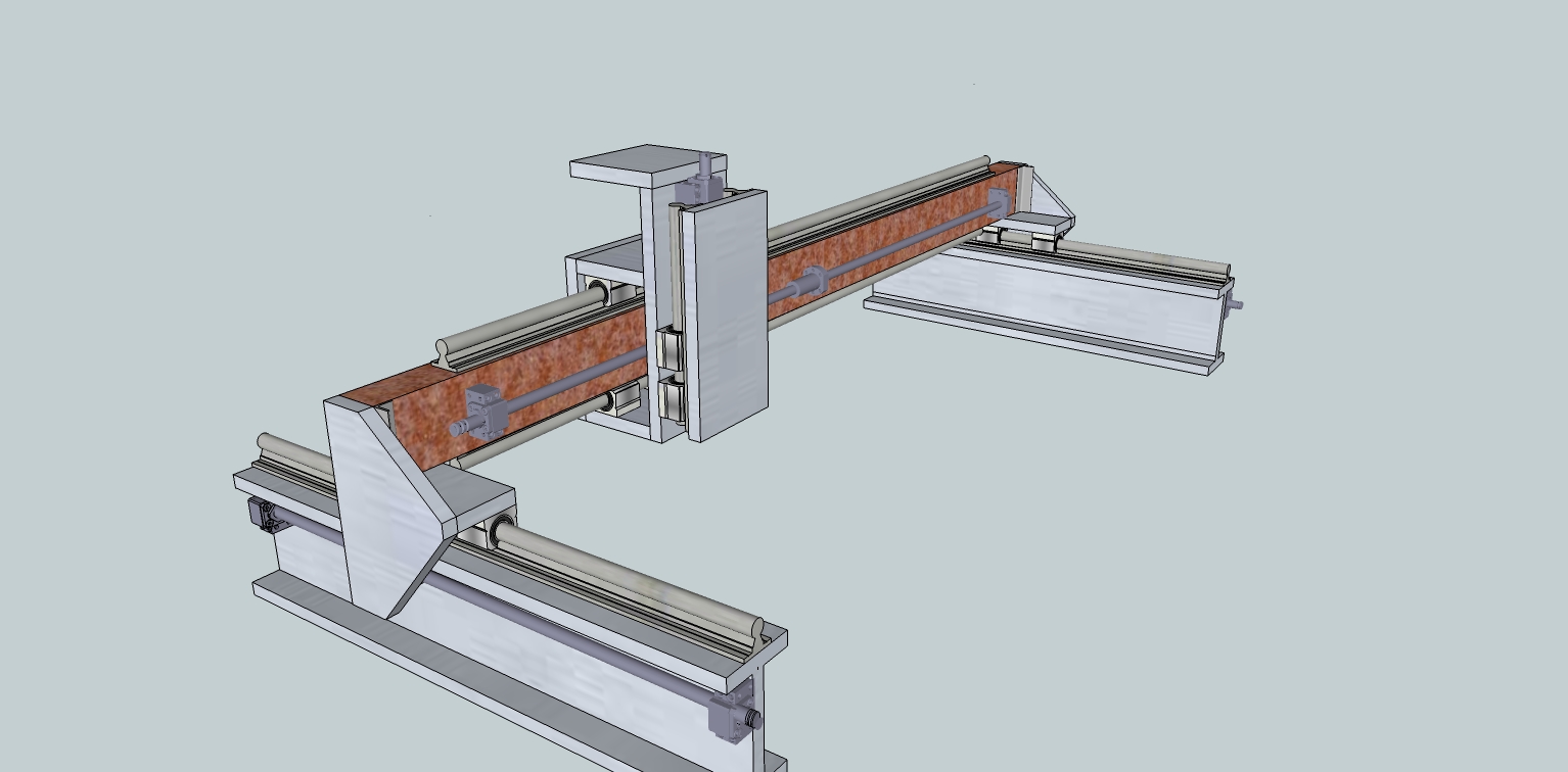

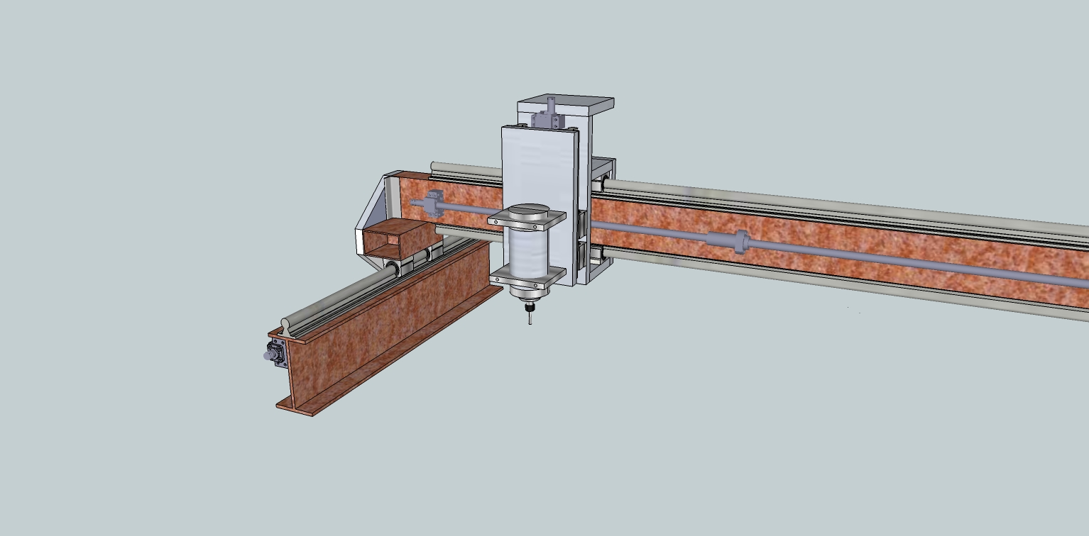

    Hi Dean,
    There's pro's and cons to both portrait and landscape designs. Landscape is good for reasons like only having one long screw on Y axis rather than 2 long screws on X axis which is a problem with large format machines, space saving and easy loading are just a bonus IMO.
    The down side is that you need to really beef up the gantry and your choice of 45mm profile fastened to a single plate will leave the machine very weak IMO.
    Nothing wrong with the format great for light duty wood use but I would seriously look to beef up the gantry.
    If you must use profile then why not use 45x90 sandwiched between 2 plates like the pics below.
    The wider profile helps with ridgidity and mixed with the extra plate it would be very strong. Plus It has the advantage of protecting the screw with just a slot for the Y aixs ball nut mount bracket which is covered with simple brush draft excluders but still allowing ballnut bracket to slip by.Access is simple by unscrewing the rear plate.
    The slot is easy cut into the plate by drilling hole either end then simply running circular saw up each side.
    Keep up the good work. .

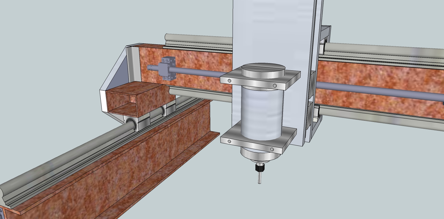

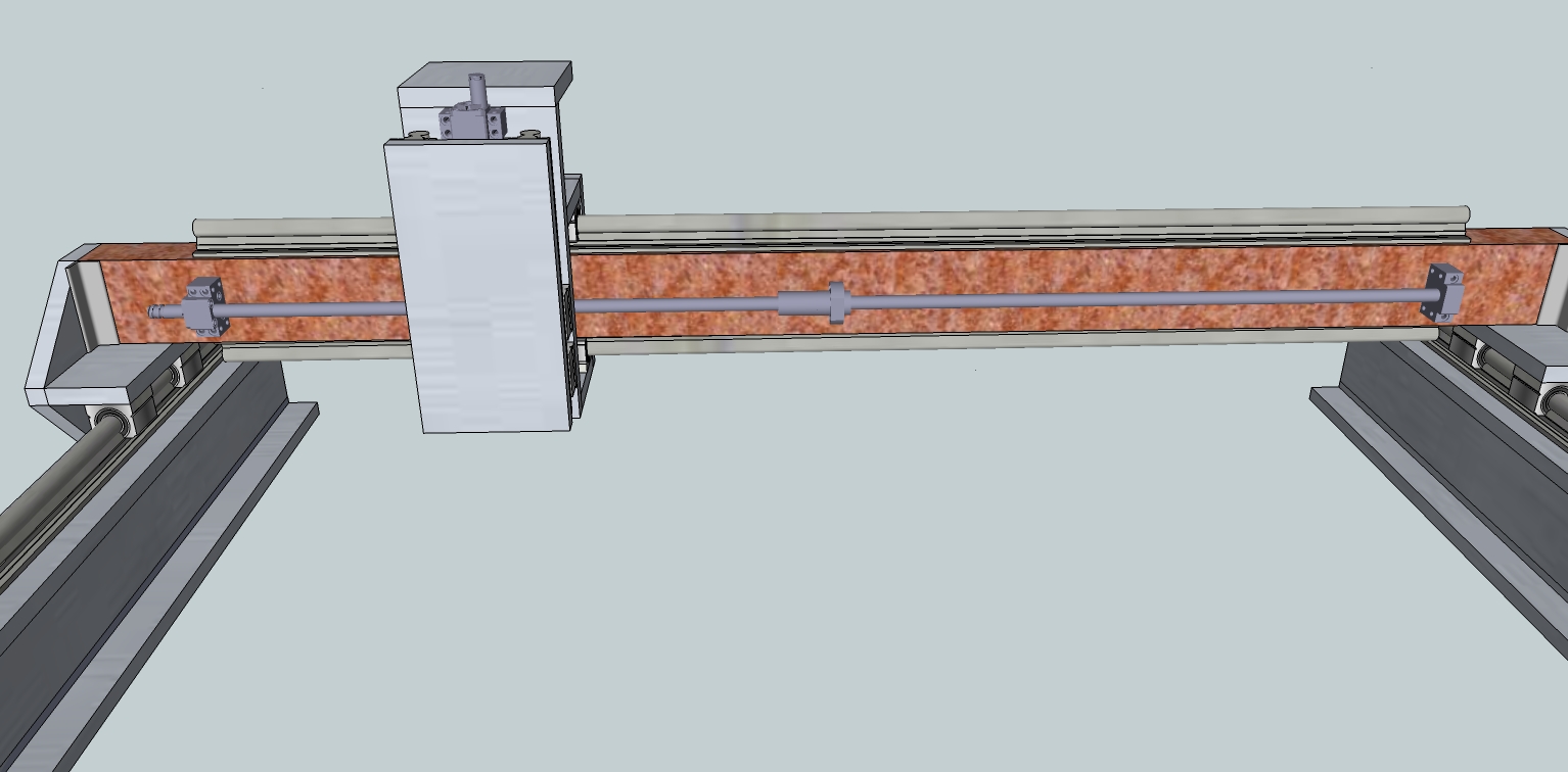

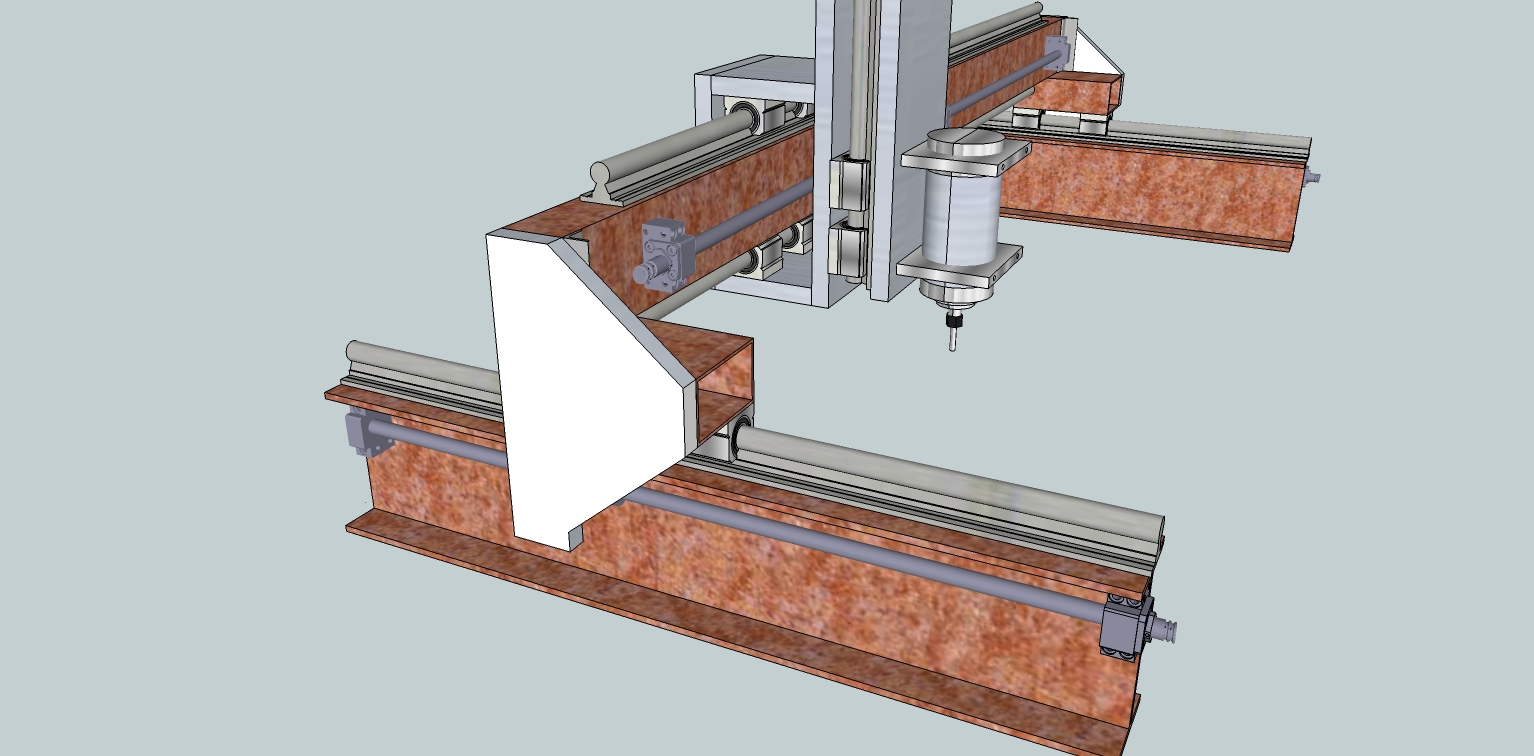

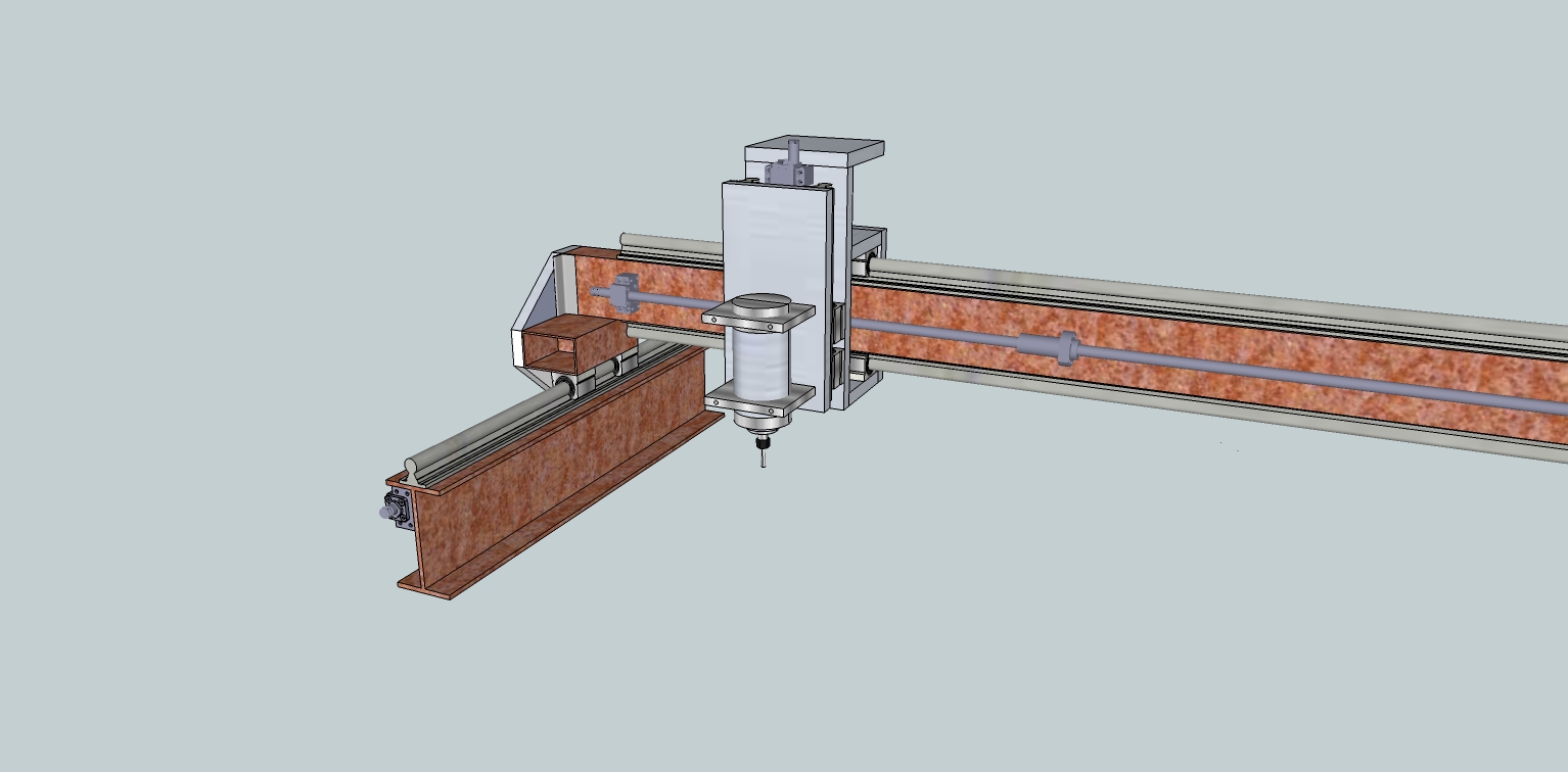

  8. #7
    Jazz,
    I don't mind whether i use profile or not is there something else i could use
  9. #8
    Quote Originally Posted by deannos View Post
    Jazz,
    Well seen as your using steel for the frame then I'd probably look towards using that. Simplest way would be an I beam RSJ type beam.
    Would get 180x100 for about £30 if your buying steel for rest of machine. You can buy 1500mm length from Metals4U for £37 plus postage.
    This would be an easy option and plenty strong enough for your needs, easy to fasten rails, screws etc.
    You will need to make sure you get a nice straight and flat piece then may still have to do a bit of cleanup with grinder/sander and straight edge to make it's flat but it makes a very strong gantry. (Don't be fooled into thinking profile is always straight or flat.!!)
    The weight will be slightly higher but to be honest for a wood router if mixed with a strong spindle/big router the extra weight can be an advantage and allow deeper cuts which offsets the slightly lower feeds.
    The other way is to use 80x40 box section in a similair setup to the Cad model using profile, just slightly cheaper than profile at £35 for 7.5mtr.
  10. #9
    I like the idea of using the RSJ, less for me to do. I assume i wouldn't need to box this in and it can be left as is, would it need support or stiffeners at each end.
