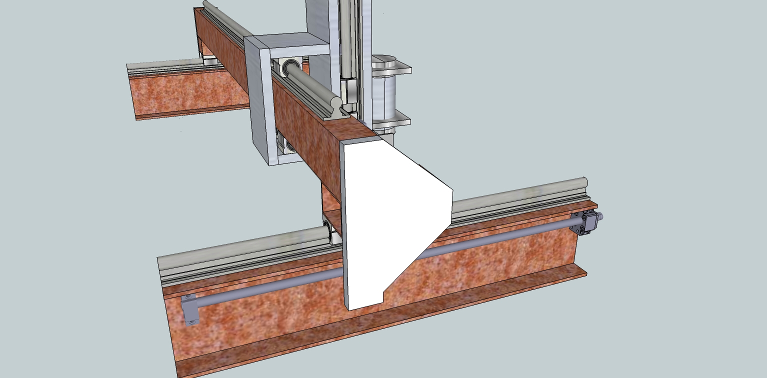

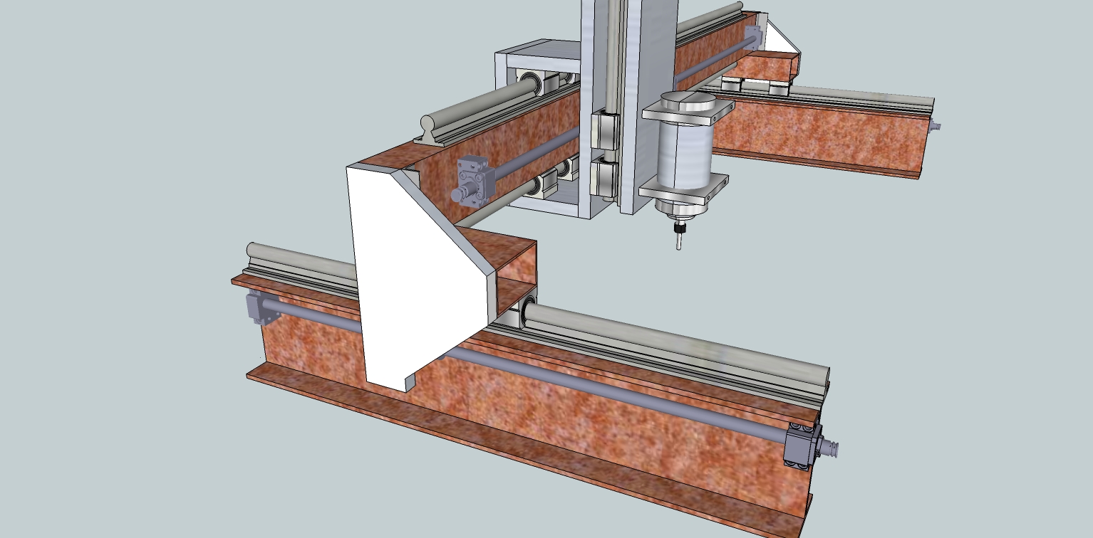

    Ok thats good but bring the screw to the front, will be much stronger having the ball-nut close the Z Axis back plate.
    Have you got the 20mm steel plate.? If not I think you'll maybe change your mind when you see the price.!! It's not really needed either and I'd use ali for easy working.
  4. #73
    Ok, thats no problem, i will do that. Is this to prevent racking etc
    No i haven't got any steel plate and a quick google has made me change my mind, but if i use ali how would I join this to the steel gantry?

  7. #75
    Quote Originally Posted by deannos View Post
    Bolt or weld Angle brackets to box then bolt thru Ali plate into brackets.
  8. #76
    Excellent, an easy solution i didn't even think of.
    cheers Dean
  9. #77
    I have moved the ballscrew to the front of the gantry and will be using 20mm ali instead of steel plate, too costly. Have added some steel angle to corners to connect gantry to end plates.Click image for larger version.

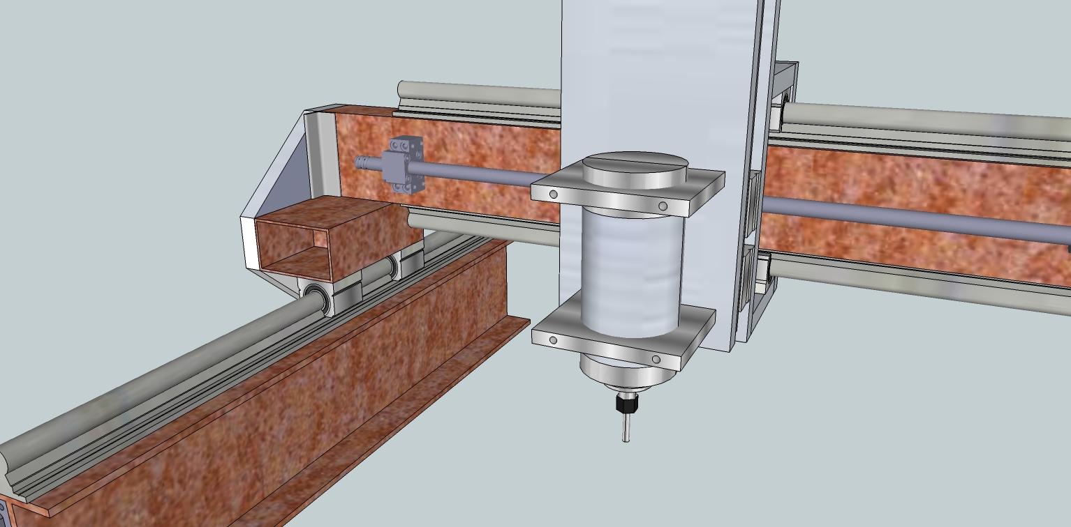

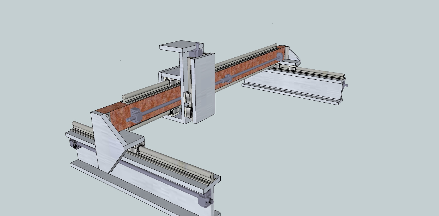

  10. #78
    Would this design be ok, i thought i would use some 100x60 box section as bearing plates. I would have some left over from the gantry and it saves on the Ali plate. The extra height would help with the bed, bit more room to play with. This box section is only 3mm thick, is that ok. I have used 300mm, 2 x 800mm and 1400 SBR20mm rails. The ball screws are 350mm, 2 x 800mm and a 1450mm length.
Name:	final with box section and corner plates and rsj(160x90) front.jpg
ID:	6582Click image for larger version.
Name:	final with box section and corner plates and rsj(160x90) rear.jpg

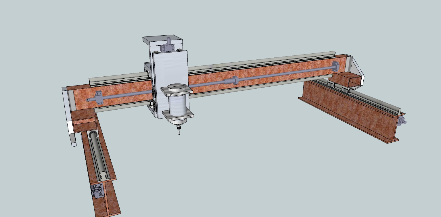

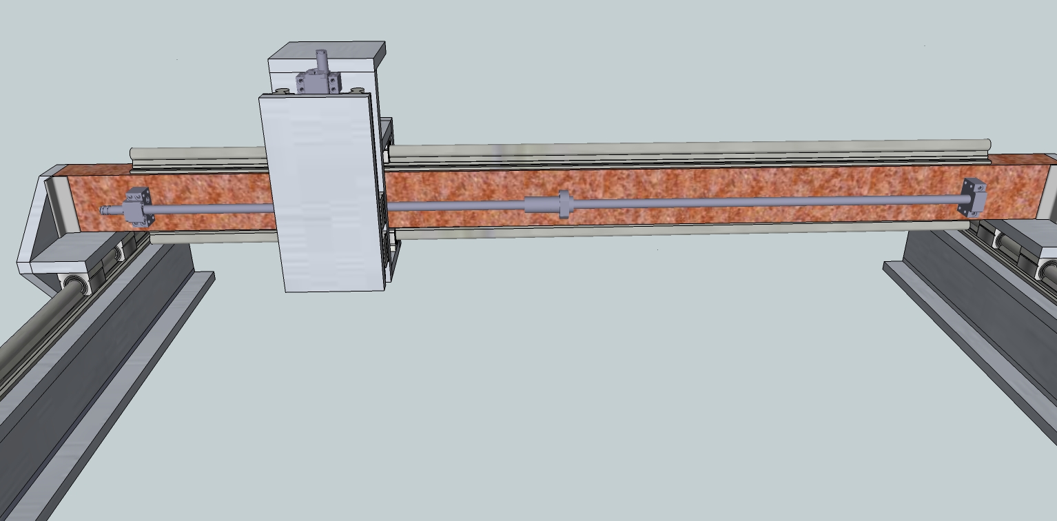

  11. #79
    2 questions for me that dont mean much to your build sorry :D firstly is that still an RSJ you got across the Y if so your second picture doesnt make it look like that... petty i know..
    EDIT: oh scrap that i just read it's box section... my misunderastanding eek... either way second question applies
    secondly how do you plan on fixing the box section to what i think is the RSJ?
  12. #80
    The gantry is box section and this will be bolted/welded to the bearing plates. I have put some steel angle holding the Gantry ends to the end plates as well, but the plates will also be bolted to the bearing plates. Rsj is only used on the base "X"
    A couple more pics, it might helpClick image for larger version.
