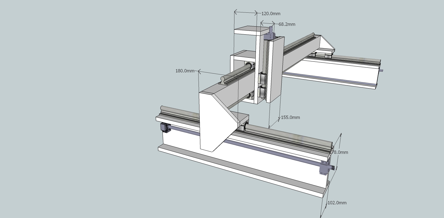

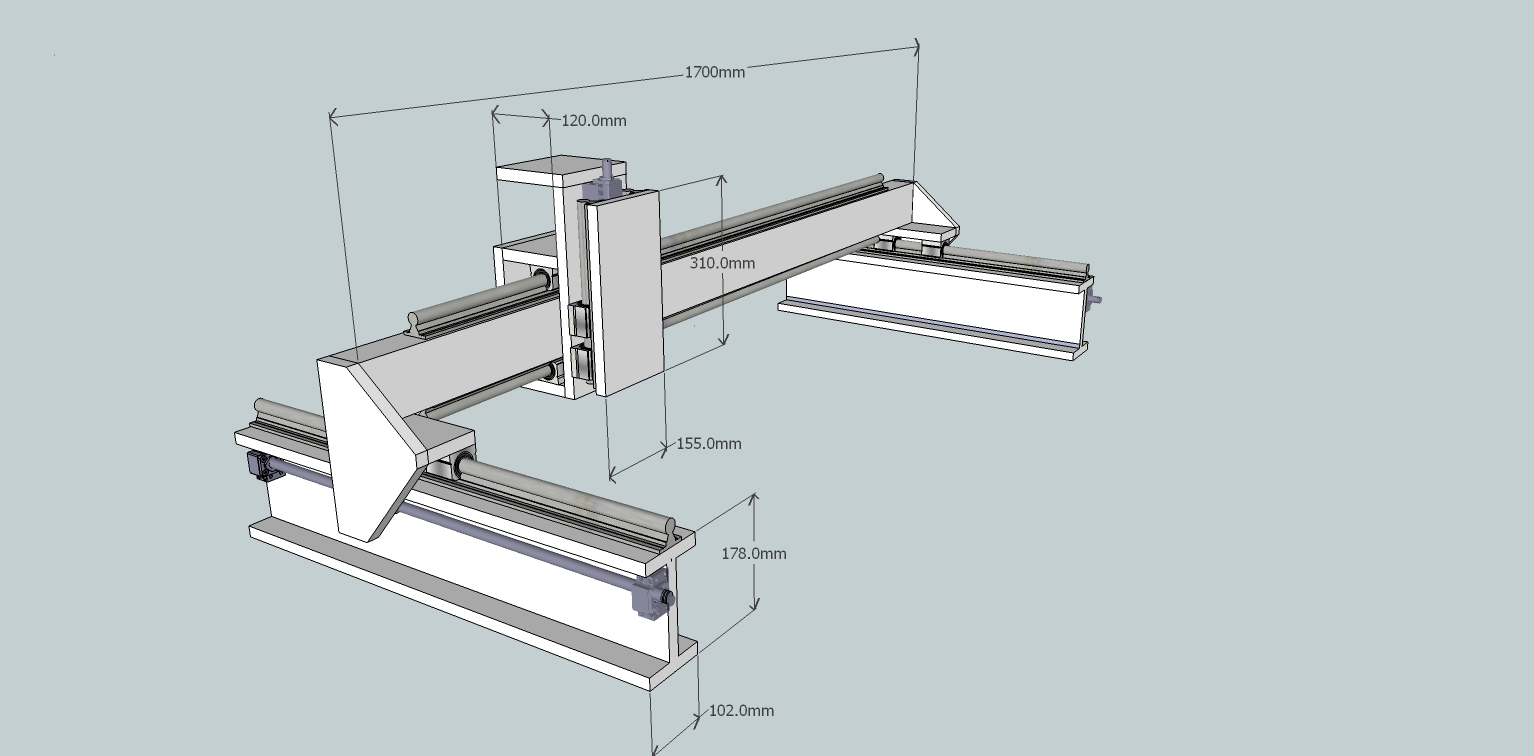

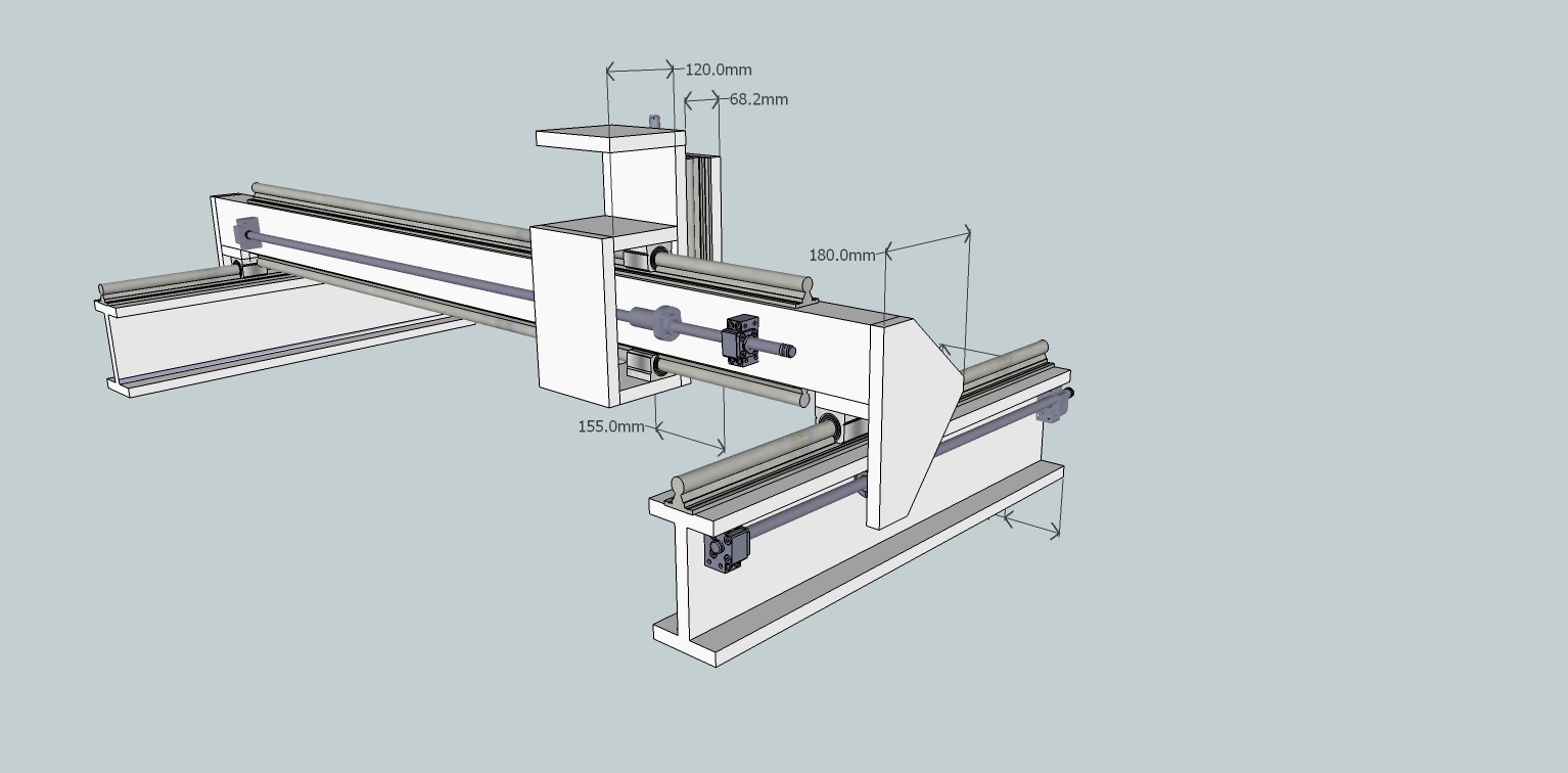

    Ok, here is my latest attempt, trying to incorporate every thing that has been suggested. So i will be using 20mm supported rails on every axis and 1610 ballscrews on every axis, along with belts and pulleys. The 2 rsj's will be 178mmx102mmx19mm and the gantry is 100mmx60mmx3mm steel box section. The gantry end plates and bearing plates are 20mm steel. The Z axis will be using 20mm ali plate. I have spread the gantry bearings out as been advised. Hopefully the drawings with dimensions will help.

    The rails are 300mm,800mm and 1400mm. The screws are 350mm,800mm and 1450mm long
    Also now confused after reading comments on the other post about the "effect of forces on gantry cross sections" and the following was mentioned-
    I don't like box section for gantry's has it can produce resonance and vibration unless thick walled.? The bolted together extrusions are far denser therefore absorb vibrations far better.!! . . .Any resonance will transfer thru to the finish.
    Am i going round in circles
