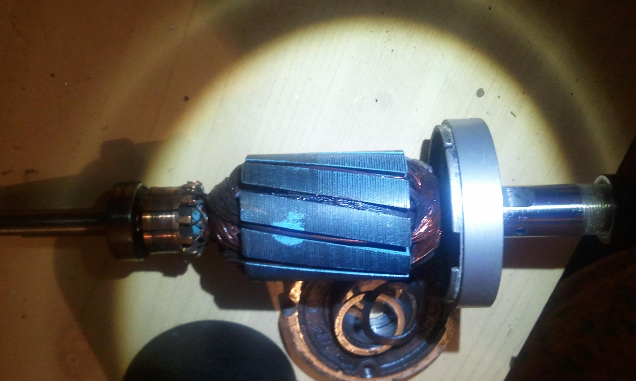

    The spindle has dead, it started to smell really bad and after that (2h of non continuous use) it stopped working, one coil is burnt. Click image for larger version.

    Have you measured the resistance across the coil to confirm it is broken? If it is, then you might be lucky enough to find the break and solder in a bit of new wire. However that is probably hoping too much as the wire has enamel on it to stop it shorting to the other strands next to it, and if it got hot enough to brake, then the enamel around that wire and others near it will also be melted. You will have a number of shorted turns. Anyway you might manage a repair but most likely to need a replacement.
    ... if you do, can I have the broken motor?

    Yes, I measured the resistance to confirm it's broken. As you mentioned it seems it has melted so it can be very difficult to fix. I will contact the eBay seller (love-happyshopping) and I'll try to get a new one (the product page says: "1 years free warranty"). I'll keep you posted.

    Do you think it was a "refurbished" unit? Is there any sign of wear around the area where the brushes run?
    Did the spindle jam on a cut?
