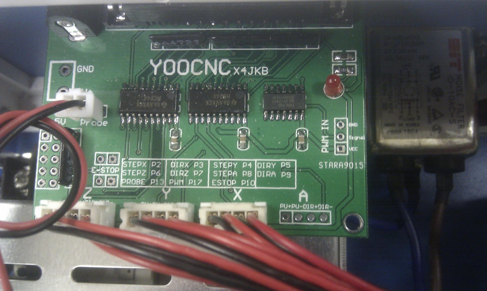

    Care to share a picture of your spindle drive circuit? :)
    Quote Originally Posted by Tenson View Post
    will get some lid off shots tomorrow :-)
    Lid off pics, Yoo CNC controller:
    spindle control;
    Device numbers been scrubbed off the two power trannys, it does the job of controlling speed but a decent D.C. drive or change to VFD spindle somewhere down the road.
    Paralell in breakout, now know why E-Stop does nowt, its physically connected to the probe pins ;-)
