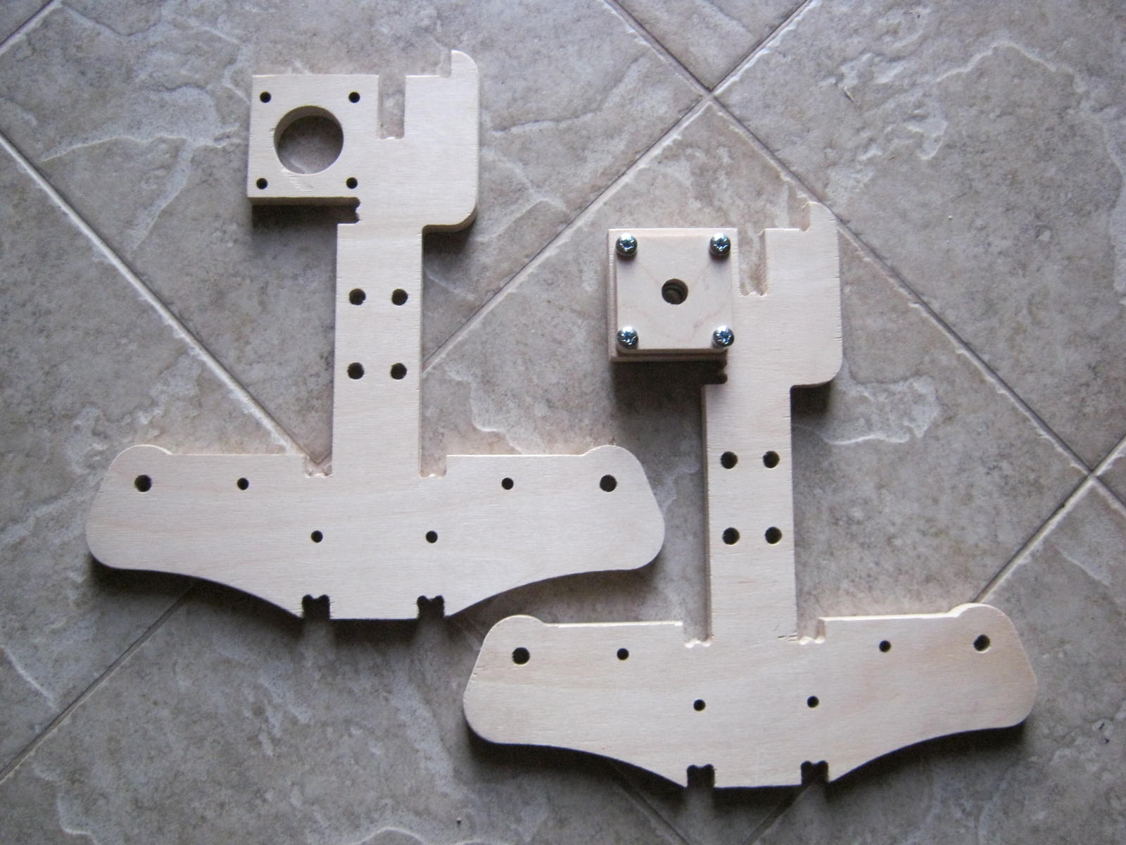

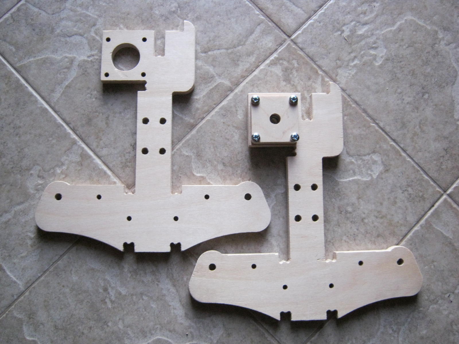

    New gantry sides,made with this machine.

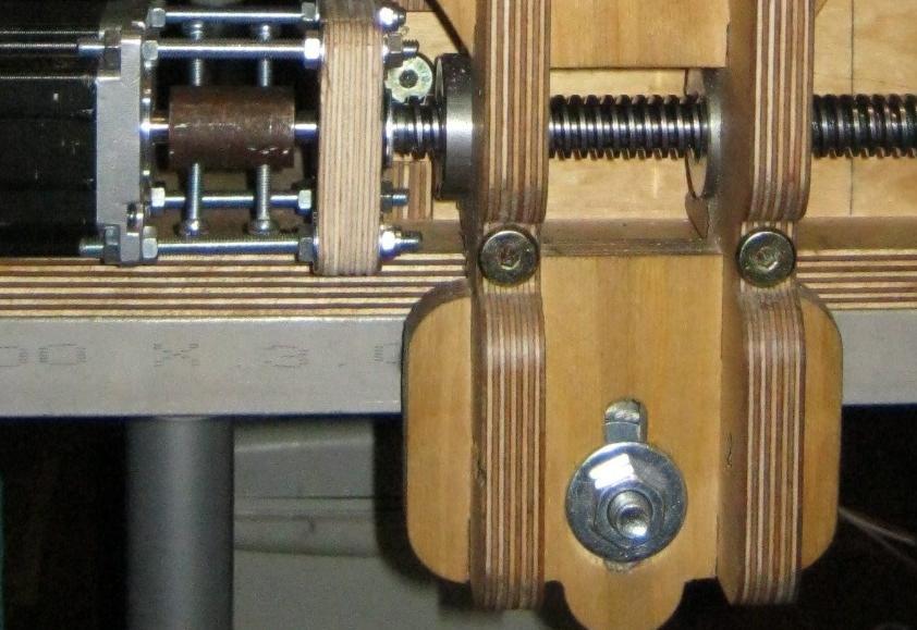

    Two trapezoidal nut per screw

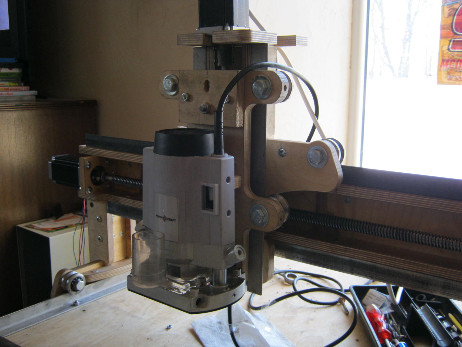

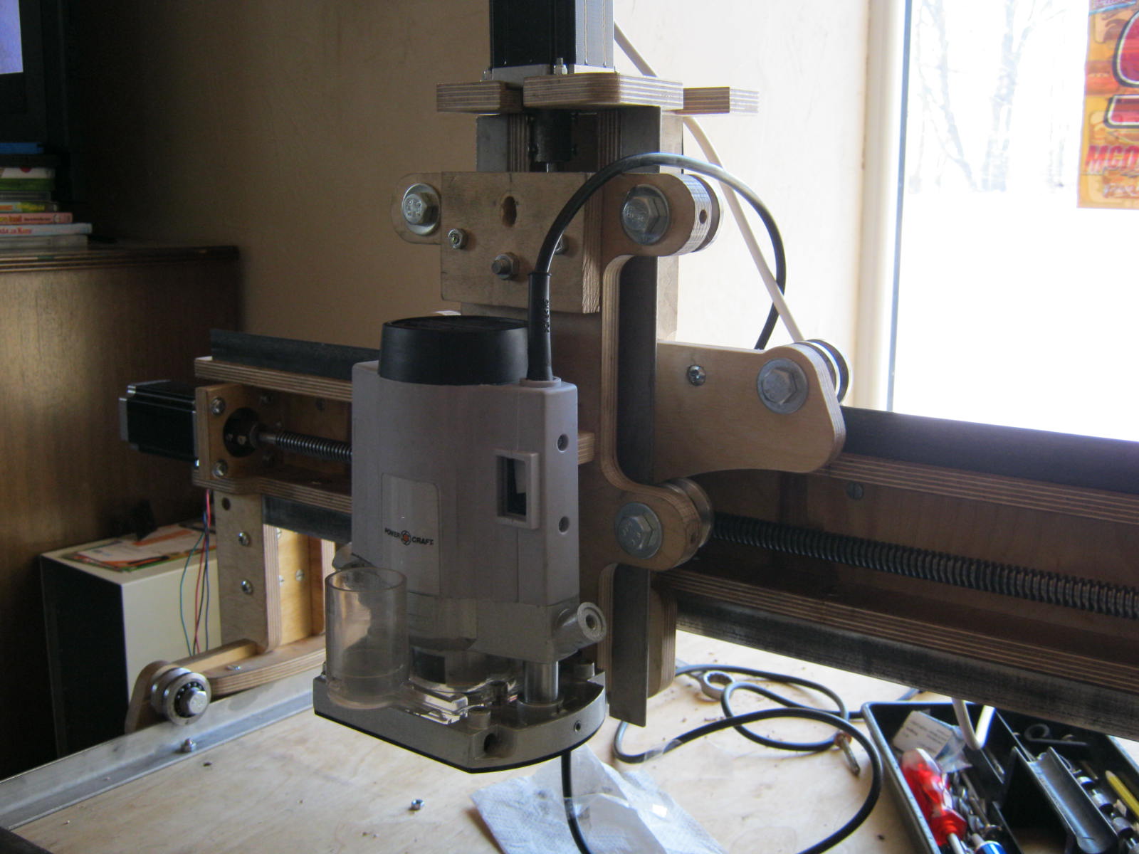

    Router from hobby store

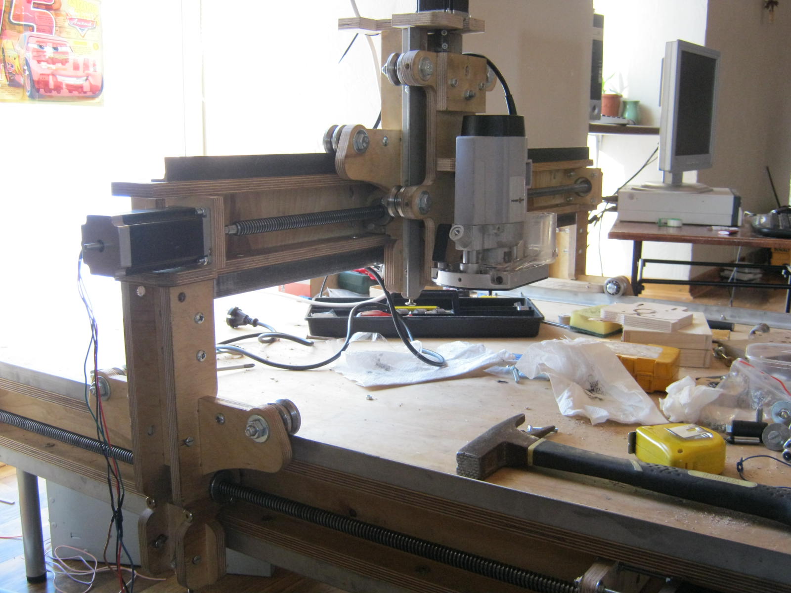

    x-axis
    Hammer,if something does not work :)
    Trapezoidal nuts 2 per screw
