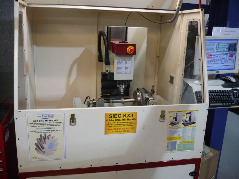

    Also £600 for the enclosure doesn't sound high to me. These guys are working for a living, not pissing about in a garden shed and that stuff isn't cheap. I built two enclosures for the KX series machines to go in at the shows for ARC. I'll bet he wished I'd only charged him £600 quid a pop
    What I meant is I'd never recommend paying that much for an enclosure when it's something anyone can make. You don't really need to know anything about CNC to make an enclosure, as it's just a box. Plus if you're going to charge £600 for an enclosure why make it from extrusion when you get a bigger profit with other materials :lol:

    As john rightly says, you cant expect a company to make a bespoke enclosure for near nothing, £600 is not bad, we all need to make a living.

    Where there's clear panels, they've used Lexan too rather than just clear perspex. I've had a quick look at prices for a 4 x 8ft sheet and its not cheap. The machine is 1.8m D x 1.8m W so your looking at a couple of sheets of that if you arrange your cuts sensibly. Overall I was happy at £600.
    I know what you guys are saying though. I DIY too (not CNC machine though) and don't consider my time spent as a commodity so £600 for a cover would seem expensive compared to something I could knock up. In this case though I wanted a neat package that ran straight out of the box.
