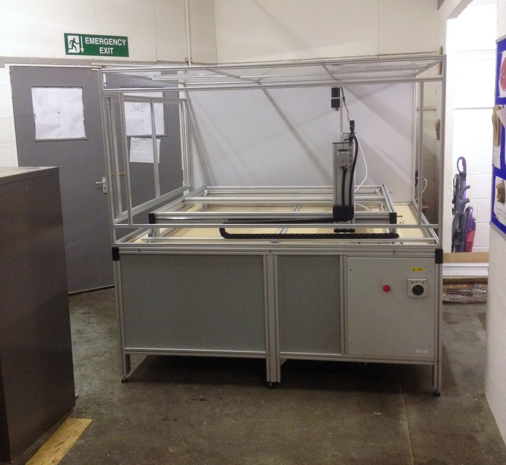

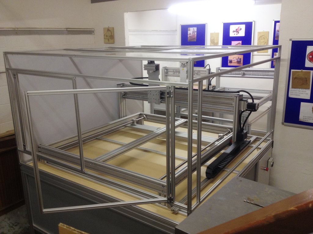

    Machine was delayed for a week. Now due this Wednesday. Have attached a couple more images that I got from Strike to show the finished machine.

    Z Axis:. . .Yes I agree with John S, Gary unsupported round rail is ok for short Z Axis. . . But this hisn't short, It's quite long.!
    The over hang from bearings to tool tip looks to be a far bit creating a long-ish lever, also the front and rear plate don't look very thick. The other thing is the rear plate length and the amount of unsupported over hang from Y axis bearings, again too much without support IMO. Yes this will be ok for the little Kress but if you want to upgrade to water cooled or larger spindle then I think it will show it's weakness. . . It will certainly restrict the depth of cut(DOC) and feed rates (Fr), even in wood.
    Tho it's not easy to see from the pics I get the feeling the Y Axis top gantry cross brace is just a piece of Aluminium plate with the rails bolted onto to it for support.? Say this because cant see any slots that would be present if it was wide profile.!! . . . If so then with that heigh/width gantry combo at this width of machine then it needs bracing up more IMO.
    Don't like the ratio between gantry height and gantry side width, the bearing spacing hisn't very much. Yes it's driven from both sides but the height and width don't gel nice and if like I belive the gantry cross piece is just Ali plate with no bracing and just relying on the rails for support then flex will show when cutting hard or deep.!!. . Again restricting DOC & FR.
    The frame under the bed hisn't supported enough with just one central support for this wide a machine IMO.
    Not a major issue but not keen on them little nema23 motors spinning 25mm ballscrews, they are going to be working over time with the extra inertia of 25mm ballscrews.!

    It does look like alu plate that forms the gantry but its alu extrusion. I'm not sure about the exact dimensions but it looked like about 160mm x 30mm or possibly 160x20mm.
    This was a concern of mine in recent days since I started looking at some of the DIY builds on here - much more substantial beds. I can't see an easy way of bracing it more thoroughly though, especially in the direction parallel to the gantry, because the ball screws are in the way make a decent and useful cross section of bracing impossible to fit in there.
    I was led to believe these are nema28 on the x and y with 4Nm rating. However when I do a good search for nema28 I get nothing. Only nema23 and 34 return useful results. Unsure now.
