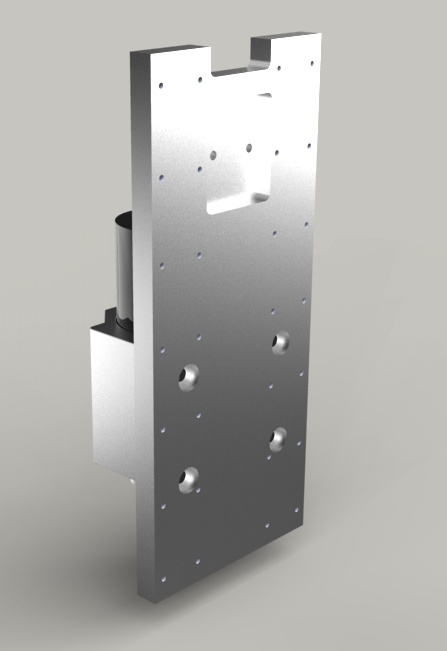

    Redone the Z front plate. Anyone help with cutting this? I'll pay of course!

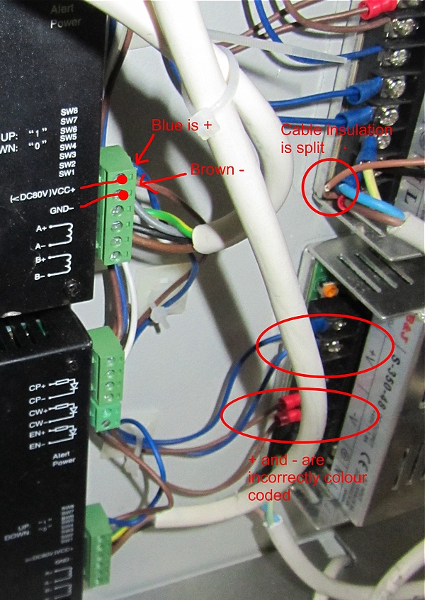

    Here's a list of problems so far:
    • Gantry back constructed out of 6 sections of 30x30mm extrusion loosely coupled together and each only captured in the gantry uprights by a single bolt at each end. Result was a large amount of slop in the Z-axis and therefore cutting accuracy.
    • All ballscrews only captured by relying on bearings preventing movement of the ballscrew. This is inadequate build quality giving rise to allowing 'backlash' from said movement. Proper mounting methods is genuine ballscrew supports which use a nut on the threaded portion of the ballscrew to capture.
    • Advertised speeds were misleading at time of purchase. I was advised I'd get rapids of at least 5m/min when in reality this was 3m/min to run reliably and without stalling.

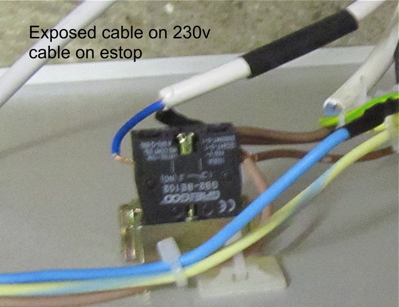

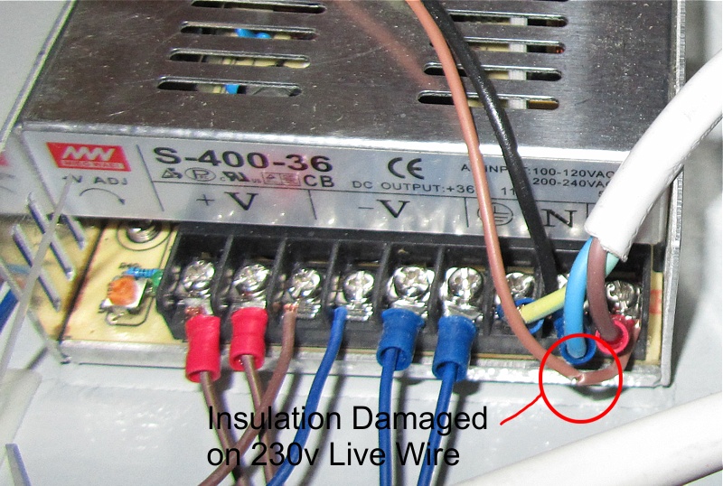

    • Electrical wiring substandard and has not been installed by a certified electrician nor does it meet the required safety standards by British law on a commercially sold machine. One example is broken wire insulation exposing live cable which could potentially come into contact with the chassis. No grounding on the chassis either. If I bought something like that from Currys, I wouldn't have shown the patience I have with Strike.
    • Various loose bolts, a few missing bolts and inaccurately machine parts. When you buy something for approx £4500 you expect better.
    • Replacement parts supposed to address most of the previous issues failed to do so and only introduced more problems. So far I've had to replace the Z axis front plate with a new part because the previous's mounting method for the supported rails meant it was impossible to adequately tighten due to recessed nuts. A big oversight for such a critical component. Also having to replace the Y axis ballscrew as its bent and causes severe vibration of the machine.
    You might be wondering why on earth haven't I done something about all this before now? Well I'm a nice guy and only want what I paid for. I've been incredibly patient with Strike and gone out of my way to help them help me. I've Travelled 300 miles to and from Chesterfield to Micheldean not once but twice to courier parts around. Also for the past few months I've been playing the role of repair guy because they offer little support outside of "Send it back at your cost, we'll fix it and then bill you for delivery". Well to send the machine back would cost £300 each way as its a 500kg nearly 2m cubed lump. You read the fine print when buying and this is stated so I wasn't surprised but when it comes from incompetence and care building your machine then it does become a very annoying issue. Its other things too like the fact they had a month to make replacement parts and once done I arranged to collect on a set date and was told they were tested and ready. I arrived on the agreed date and time only to find they hadn't tested and problems were ensuing that meant I had to sit in the car for 5 hours outside their premises waiting. Stuff like that shouldn't happen and was the last thing I wanted after a 150 mile drive there whilst facing the same to get back home.

    To be honest Ant is being far too lenient with his description about the level of build quality. The lack of engineering care and build quality goes beyond inept to the point of down right dangerous regards the electrics.
    If this machine had been electrically tested or inspected to comply with BS EN 60204-1:2006 + Amendment1:2009 for working machinery or any of the HSE BS EN codes relating to machinery safety it would have had the plug cut-off and a big sticker saying "Condemned".
    If the HSE got involved someone would be in for a hefty fine or heaven for bid worse case someone got injured or electrocuted then a free holiday at HMP would be given I'm sure.!
    If an engineering test to determine "Fit for purpose" then it would have a BIG fail sticker along with a hefty list of fail points.!!
