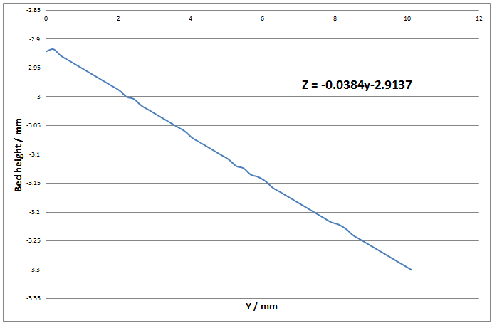

    Basically, I've got Z errors creeping in ....but I don't know where they are creeping in from!
    The CNC software I use - CNC-USB has a way of 'auto Z probing' & storing the points, so what I did was leveled my bed (thanks for the endmill Jonathan!) then mounted some copper board on it - I'm pretty sure the board is flat (both because I levelled the bed, but after mounting the copper, I also did a shallow test cut from Y0->Y10 & it was perfect.
    So I then then did auto Z probing at 0.2mm spacing along the Y0->Y10 line ...by the end of the 10mm probing the error recorded between 1st & last probe was 0.3875mm!! (see the list below.....that'll be the last Z probe recorded (3.30) minus the first probe recorded (2.92125)) ...this is a massive amount of difference over such a short distance of 10mm ...and like I say, in parallel with this 'probed line' I'd already done a shallow test cut & the cut was perfect (in other words the bed is very level along this 10mm line)
    I am literally tearing my hair out here......the CNC machine I bought touts itself on repeatability (http://www.youtube.com/watch?v=6HZnKCrpCkI ...2m25s) ...so it might not be my machine (or maybe they just lie!) - it may be my stepper board? (an easy CNC 3 axis)...I'm just a bit puzzled where to start & if there's any diagnostic/test anyone can think of it'd be most welcome!
    Here are the Z probe points along the 10mm line Y0->Y10 (I chose 0.2mm spacing to ensure there were a lot of Z moves up/down/up/down etc), every line introduces a little bit of cumulative error by the looks of it....

    I just plotted the point list:

    That doesn't look very random! In fact that's an excellent linear correlation (R2=0.9996) so it looks like an alignment problem to me. If you hadn't said that the bed was surfaced I would say that it is the gantry that's not level and if you hadn't said that the cut with a V-cutter looked fine I'd say it was the bed/PCB that's not level as a straight line like that implies one or the other is inclined.
    One way to test if it's a cumulative error, for instance missing a couple of steps for every down move (seems unlikely but you never know), is to just do two points. One at Y0 and one at Y10 and see if the error is a 50th of what you just got from measuring 50 points.

    Hank The error is too consistant to be noise issue.! . . .It's repeating 0.0075.
    I presume you have done the obvious checking binding, slipping couplings etc.!
    This sounds very much like pulse timing issue.? basicly it's not completeing the full step before it starts the next step.!
    Before doing anything else I would check simple things like wire connections, make sure the wire polarity of the motor phase's are correct regards drive connections IE: A+ B+ A- B- from motors go to same on drives. They will still work ok if switched and it can cause silly issue's like this with some setups.
    If the USB Software as a similar Dir/step pulse timing setting that mach does then I'd try increasing this time.!
    Back off the velocity/Acclereation and see if it still happens, you could just be over tuned.?
    Are 100% sure the motor is Man enough for the Job.? Some times if the motor is on the edge regards holding Torque they can "spring" steps while going slow or near stop, again this would do this kind of repetative error.!
    Can you try swapping the Axis to see if it moves or goes away.!
    If you have one I would even try swapping the USB cable, I have had silly things like this with dodgy PP cables. I had a small noise issue with my smooth stepper and one of the tricks or work rounds was to remove the shielding at one end.!! . . . .Basicly the shielding at each end was causing ground loop problems. I know it sound like a long shot but worth a shot.?
    hope you find it quick I know how these things can drive you crazy . . . . . . . Keeps us informed.!
    Yes Machine setup was my first thought Jonathan but the leveling of the bed rules this out.! Not sure the pcb would be so consistant increasing thickness.?
    Thats why I turned to pulse timing issue.? This would be repeatable to this level.!
    I feel for hank because things like this can drive you crazy.!!
    Yep, the PCB itself has good thickness tolerance so I was more thinking the PCB itself might not be stuck down flat, but as we both said... that makes no sense! Maybe the gantry slipped at one end? Again unlikely.
    I doubt it's the USB cable as interference or interruption in the USB signal would cause all sorts of problems, not a nice linear error. Similarly if the motor is connected wrong it'll either break, not spin at all or spin the wrong way.
    Out of the causes you suggested I think the acceleration setting is the most likely cause as that could well induce a consistent error. Testing on a different axis, or even probing a grid so we can plot a plane is also a good plan.
    Try running the probing routine exactly as before, but twice in a row ... probe from Y0 to Y10, then start again at Y0. If the two point lists are virtually identical you know it's not a motor or motor tuning problem as those problems would make the second probing routine output different to the first.

    Guys, I've just picked up your posts (been out all day), will take a trip back into my workshop with a clear head (won't last long though!), I actually have high hopes that this will be sorted tonight, a couple of things I did late on last night was ....
    1. Changed my Z resolution (from full step to 1/8 step...my Z 'pitch' is 1.5mm so steps per mm has gone from 133222.3 to 1066.6666)...at least this way i'm figuring, if I'm missing stepos then the error won't be so huge!
    2. I calibrated my Z axis (not even sure whether this could affect the outcome, bt it was out.
    Re the pcb kmaterial....clearly I've leveled the bed, but the copper board is double sided sticky taped down to some 5mm (flat) acrylic spoiler material...this in turn is clamped to the bed...so there is the possibility for an unplane copper work surface error...it shouldn't amount to what I was seeing which was 0.35mm over just 10mm (also, the fact that I took my V cutter down to 'just' scratch the copper & then tyraversed 10mm to Y10 ....the line disappeared half way along (since there's no ascent/descent going on here, then this must be board level error)
    The CNC software itself can't be ruled out...this auto Z probing is a *very* recent feature in CNC-USB software.
