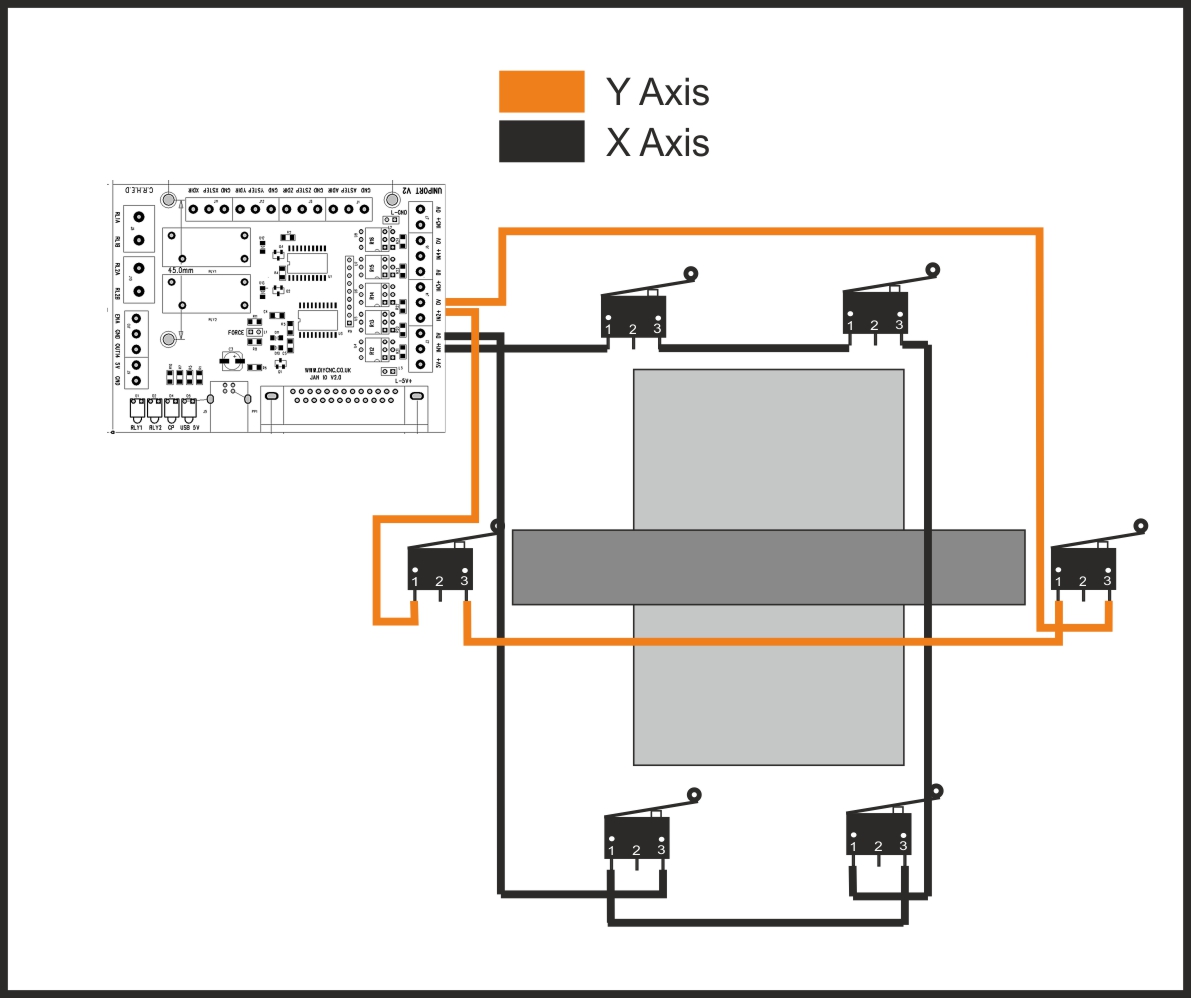

    Hey guys, im having a problem with wiring my limit switches up to the uniport.
    Do any of you good guys have a wiring diagram which i could go off or possibly give me a fool proof option :whistling:
    sorry maybe i should mention i would like the switches to act as home switches also. i had one test switch hooked up and homed the machine pressed the switch and it backed off but didnt stop until i let off the switch

    Quote Originally Posted by D-man View Post
    Thats how home switches are supposed to work.! They hit the switch which triggers the signal state then reverse until the switch releases's and signal changes back to it's original state. Depending how you have them wired IE Normally open (NO) or Normally closed(NC) the signal will go Hi or Low the control software(Mach etc) just watch's for this change.
    Wire them NC for safe operation then if a wire breaks or comes lose then the signals lost and machine stops.
    The wiring is easy just wire them in series IE + - + - + - + -
    Do i have the right idea with this?
    Yes but you can if you want to save inputs put them all on the same input X,Y & Z Axis.
    The switch's 3 terminals would go something like this:
    Terminal 1 = input
    Terminal 2= output normaly closed or Terminal 3= output normally open.
    To check which is which just use a multimeter set to continuity then probe between pin 1 and any of the others, one should show continuity when switch is NOT pressed, this is the NC switch, the other will show no continiuty untill switch IS pressed. This the NC switch.
    Personally I would wire all the limits in series X,Y & Z to 1 input and the home switch's to another.
