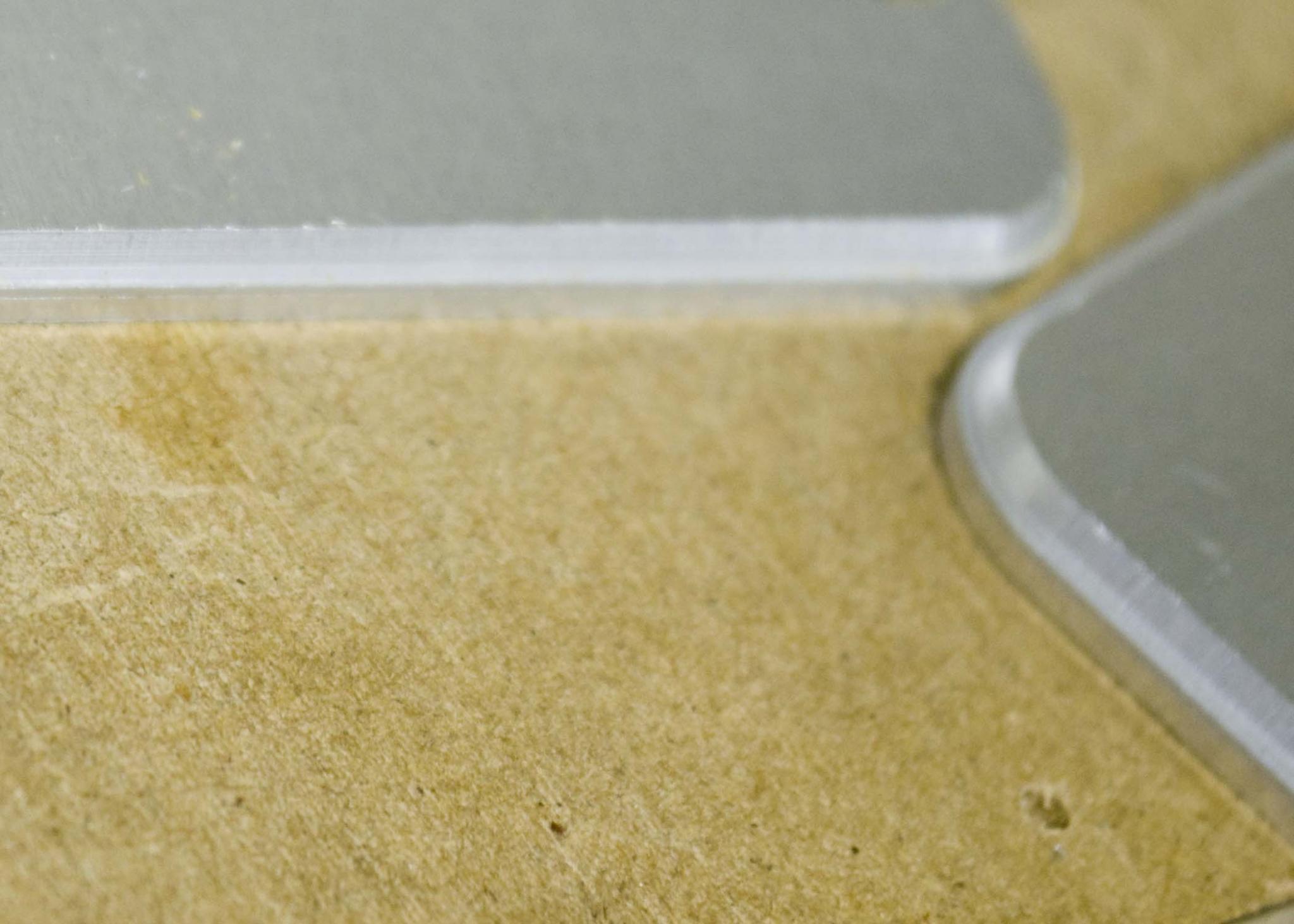

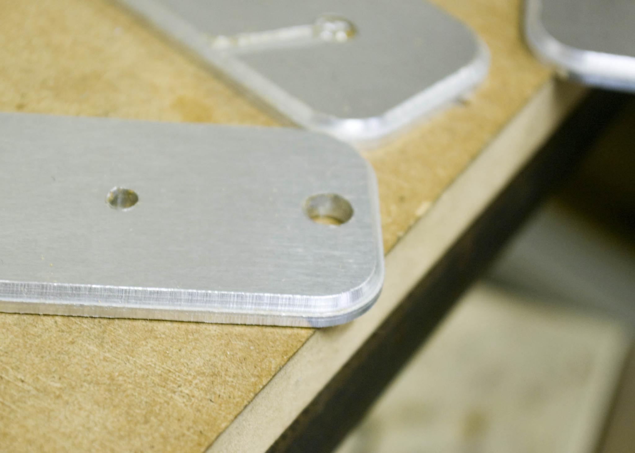

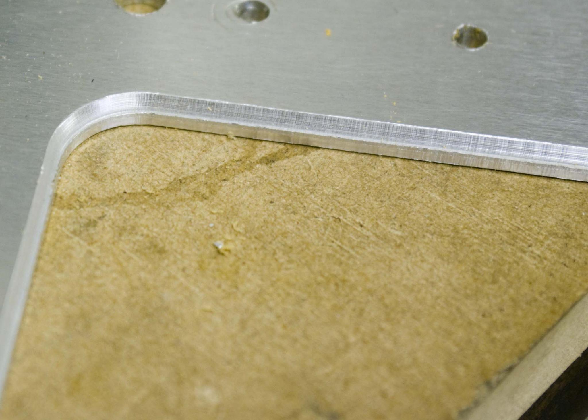

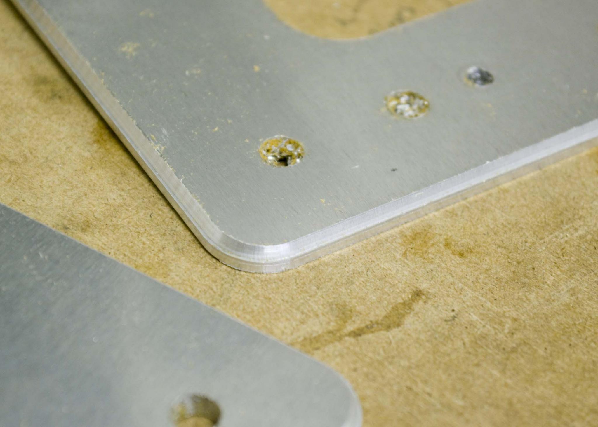

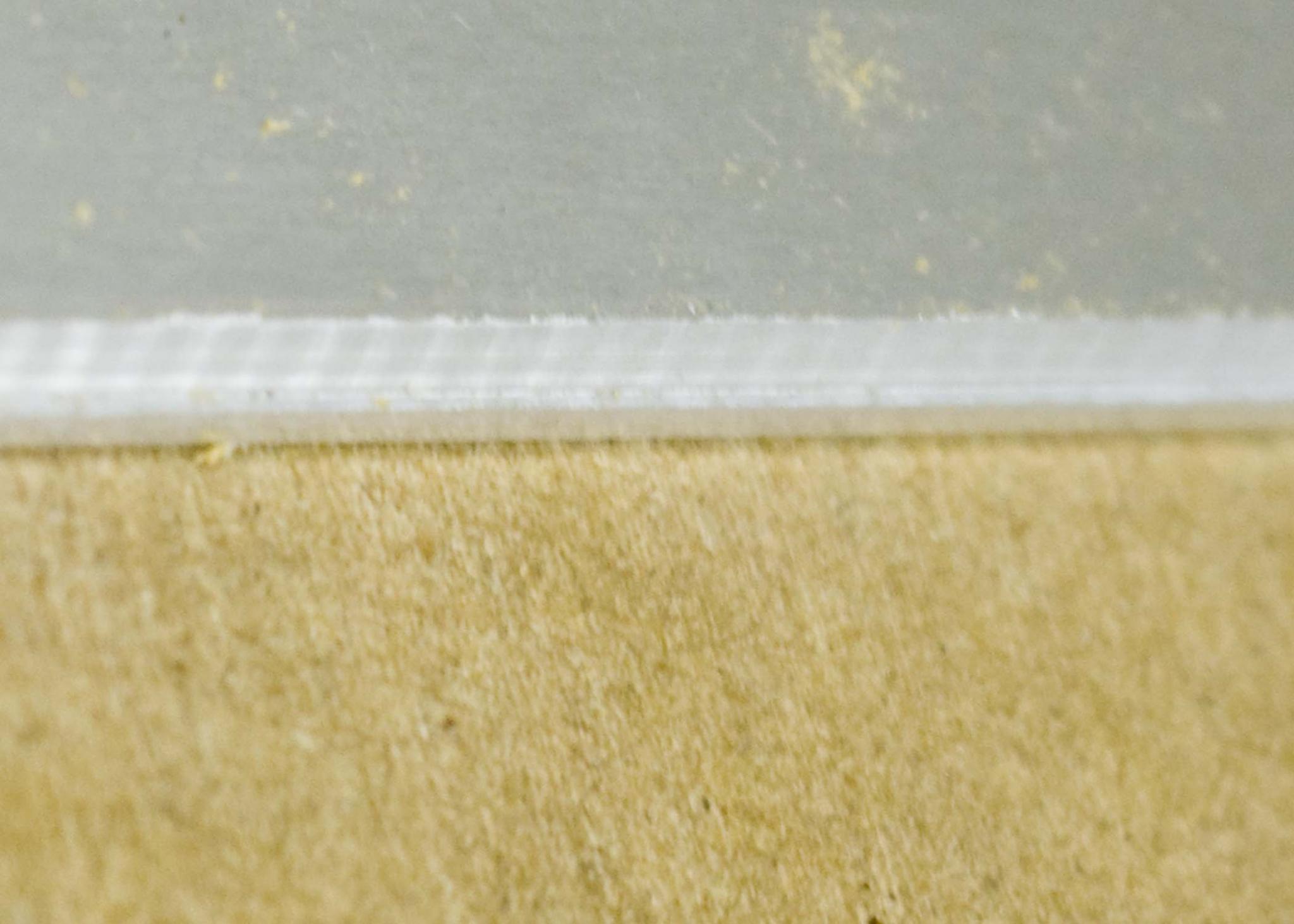

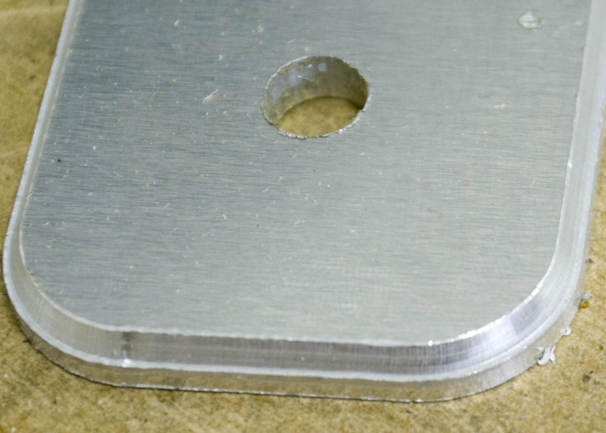

    well after I've finish patting myself on the back I have a question about the cutting I've done
    this is only apply's to the x-axis cut. I seam to have a ribbing affect on the cut line and this is constant through out the job.
    Any Ideas on what has happened
    I will post a image later

    I Hope you can see the ribbing this ribbing was cut from the X-Axis
    Was the machine feed rate to fast ??
