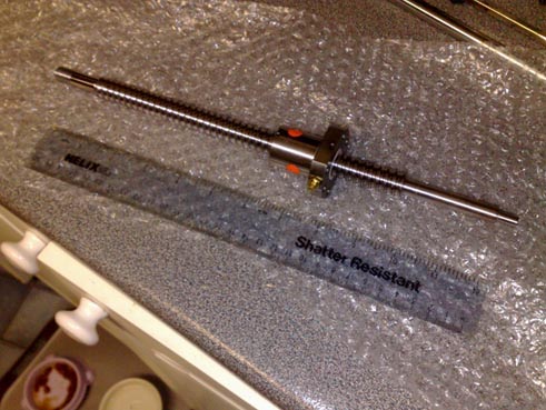

    As it turns out its not 400mm, more like 340mm, 230mm usable thread. 16mm diameter at the threaded bit, 10mm shaft, and 6.35 tip. I'll double check that later. Pic attached, with a 300mm ruler next to the screw.

    Does your Z axis screw have a 'zero backlash' nut? How much are you looking to get for it?

    I had the ballscrew on ebay for £50, but no one was interested, so I guess I'll take £45 for it. After all a new ballnut alone from Zapp is that much, and it is new. Single nut.
