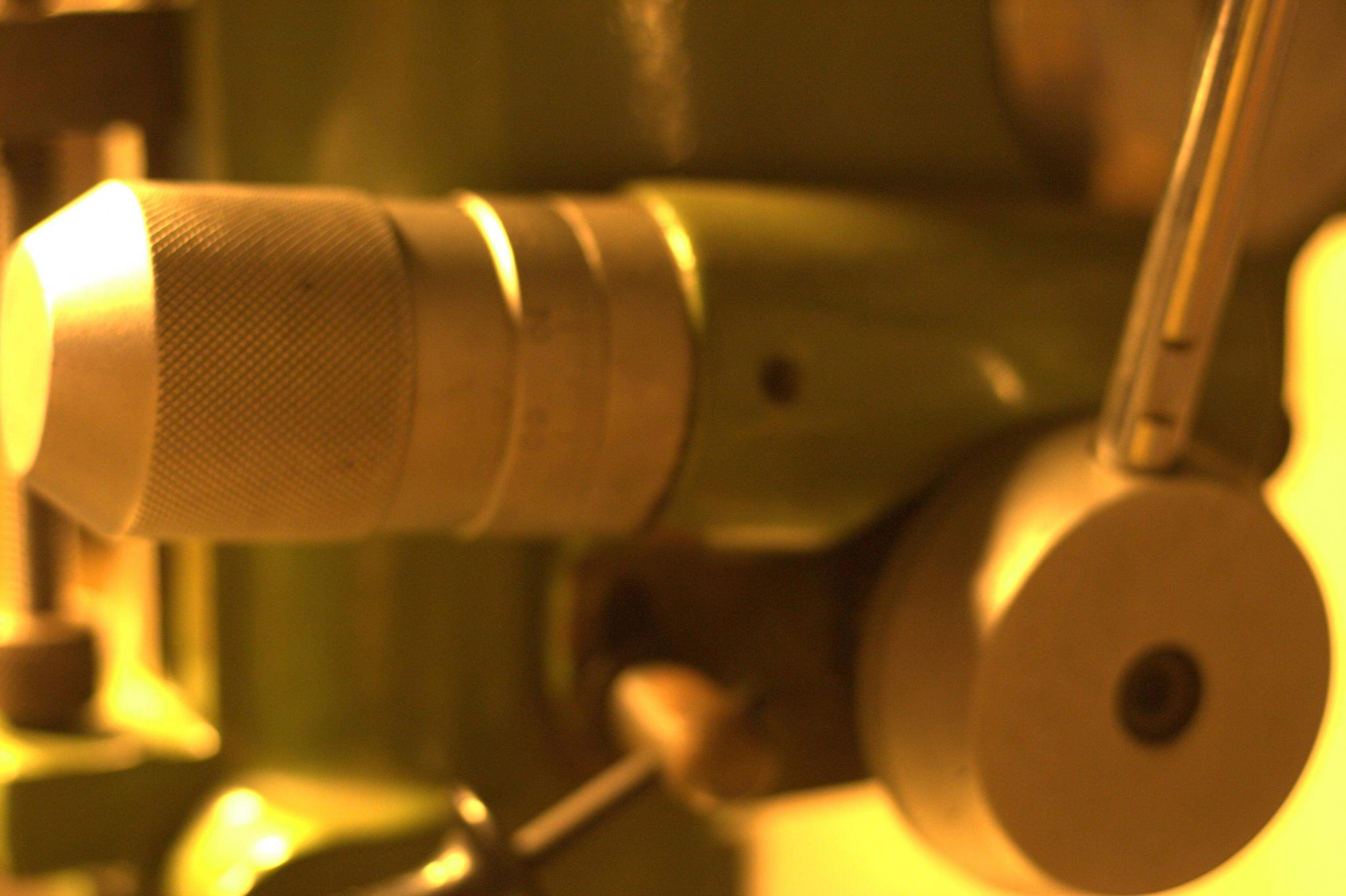

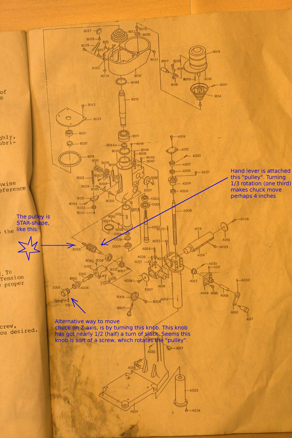

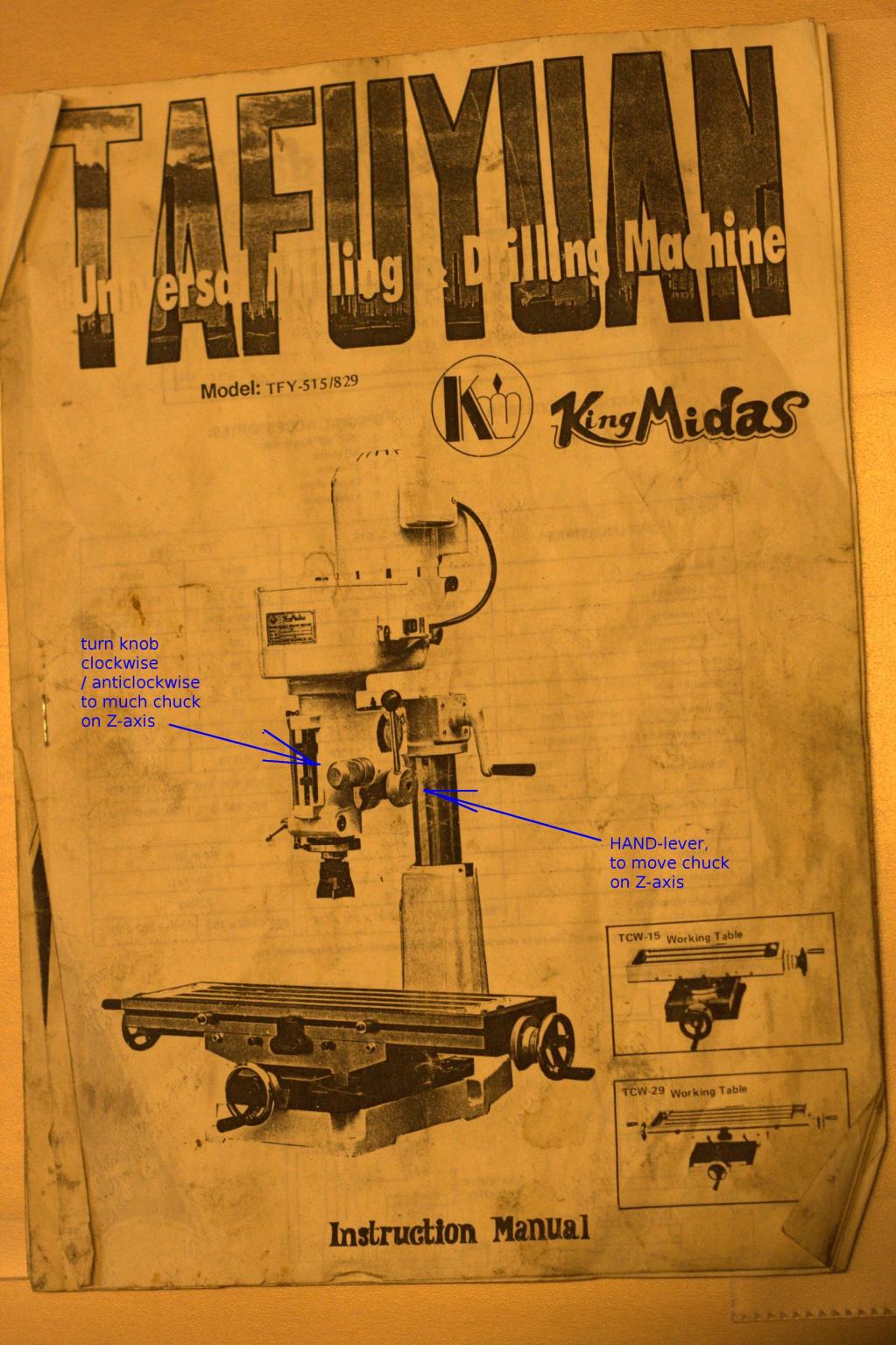

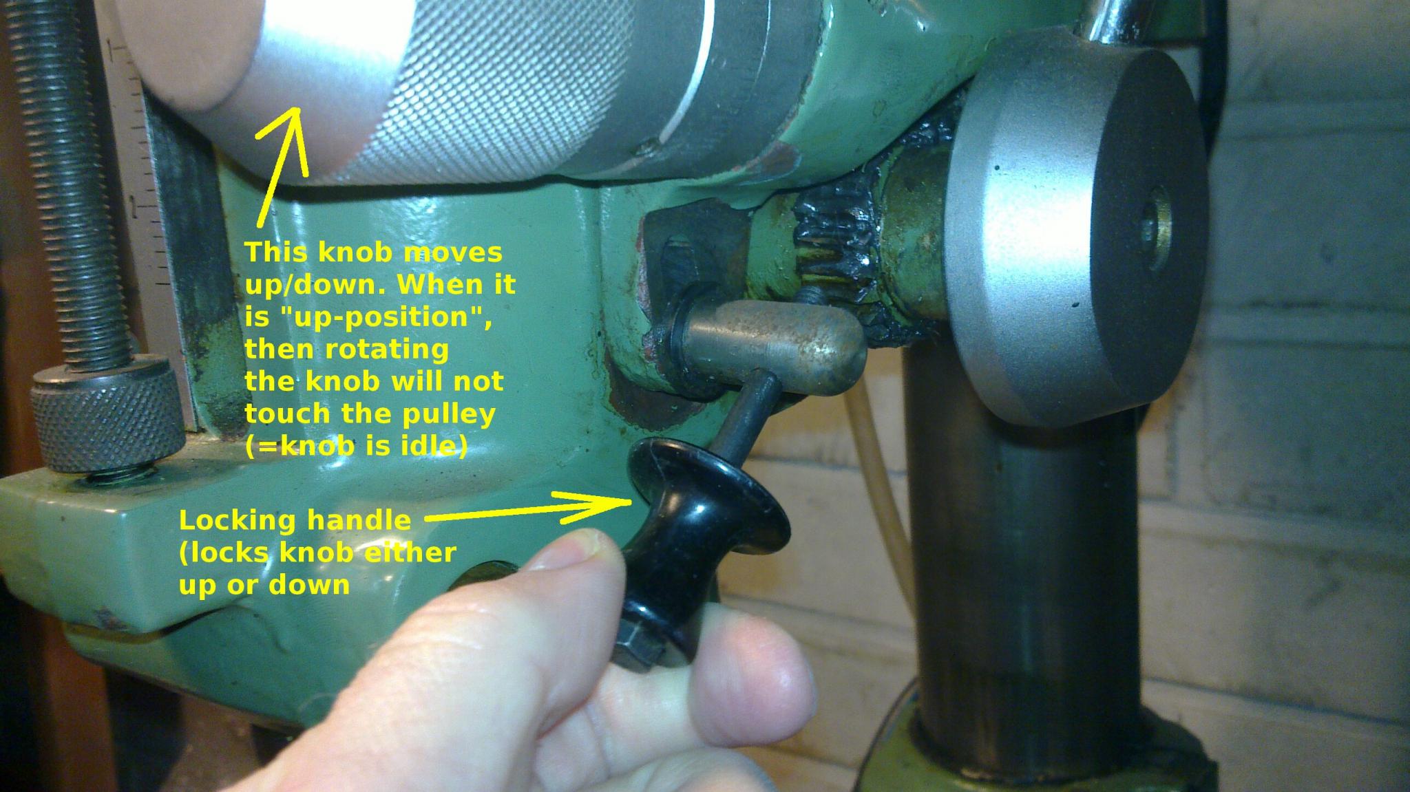

    Problem is a huge slack in Z-axis.
    - One can either use a knob, turning clockwise / anticlockwise (there is a lot of slack, when changing direction, eg. first move down, then move upwards, slack is in changing direction)
    - OR: alternatively use a lever aside. There is not much slack there. (but movement of lever pulley is only some 1/3 of a full turn, so guess one could not attach a motor to it...)
    Attached a couple of photos of my mill. (this is the one which is my own :) )
    Please suggest, where can I go from here?
    - Source another mill?
    - something else ____ ?

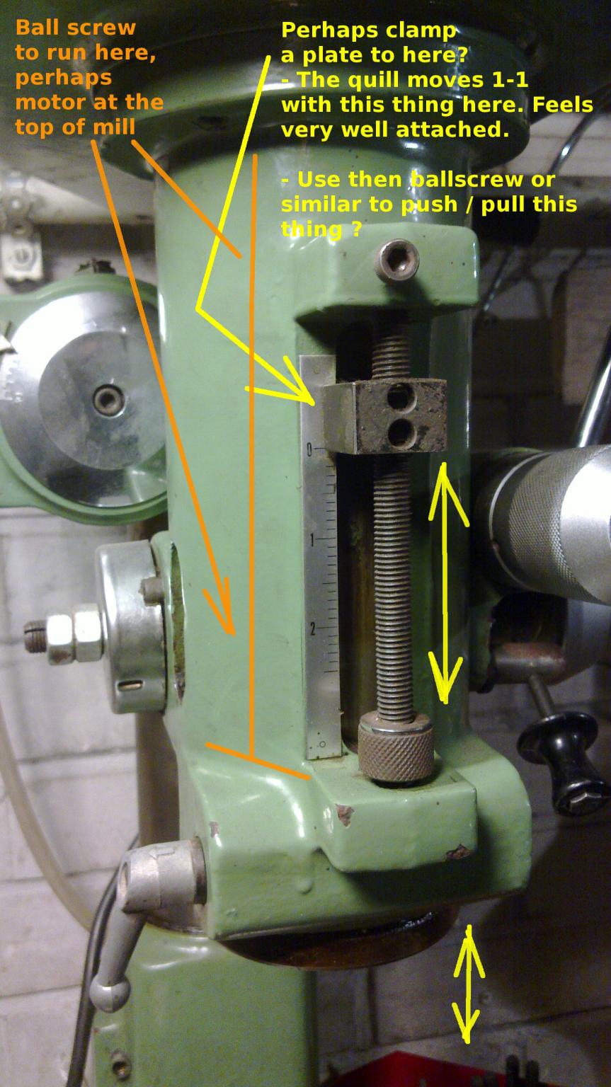

    In a case like this the easiest way would be to clamp a plate around the quill at the bottom and use a ballscrew or similar to push / pull this plate and bracket. The existing pinion would be discarded.
    John S -
    I would have a go at replacing that pinion first made up of some MOD gear and rod or just another one machined?
    Hi. I have a Myford/Rodney mill mounted on a very nice base. This is always a problem with rack and pinion z axis. My Myford drives the rack thought a worm and wheel which is hinged so it can be diss engage. I tighten up the vertical and always approach in from the same direction (very normal on a lead screws). The hand wheels marked in thou, I reckon about 5 accuracy but its a challenge. But it drives the rack via a worm to gear everything down.
    Tom
    Sherline lathe, Chester DB11V lathe, Myford/ Rodney mill, CNC mill Isel/ home made, Sealy Hack Saw, Meddings Pillar drill.
    I agree with John S. If you leave any springs or gears in the Z drive you will come to regret them.
    Best to make the plate detatchable from the screw. That way you can still use the sensitive drill handle and you don't have to hammer against the screw when you dislodge taper tooling.
    Thanks, like this advice, this is what I wanted to hear. For a while thought this is it, need another mill, but now there is some light.

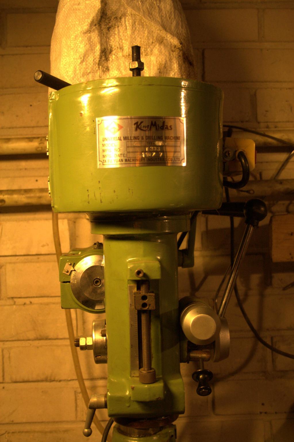

    Had another look at the mill today.
    1) Z-axis (the original question)
    - Do you think it might be best to fit the ball -screw as in picture?
    -- (and yes make attachment -plate detachable from screw)
    - Or perhaps try to hide the screw inside the "tower"?
    - Or attachment to the quill ?

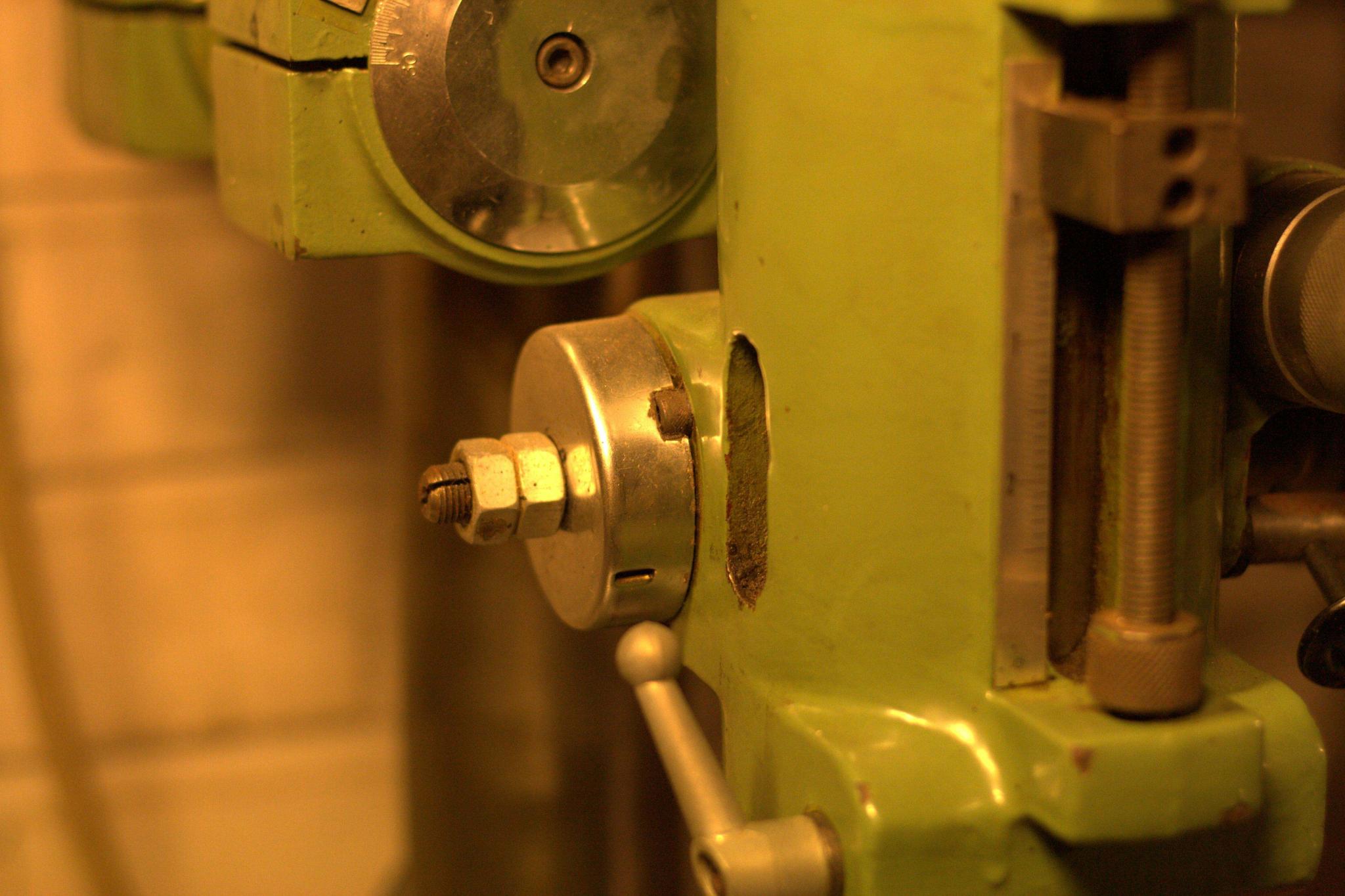

    2) The Z-axis screw is possible to disable. (picture)
    - perhaps one could leave it there, then?
    - or would you take that out altogether?

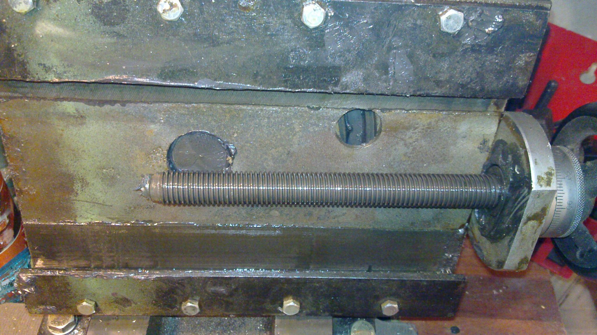

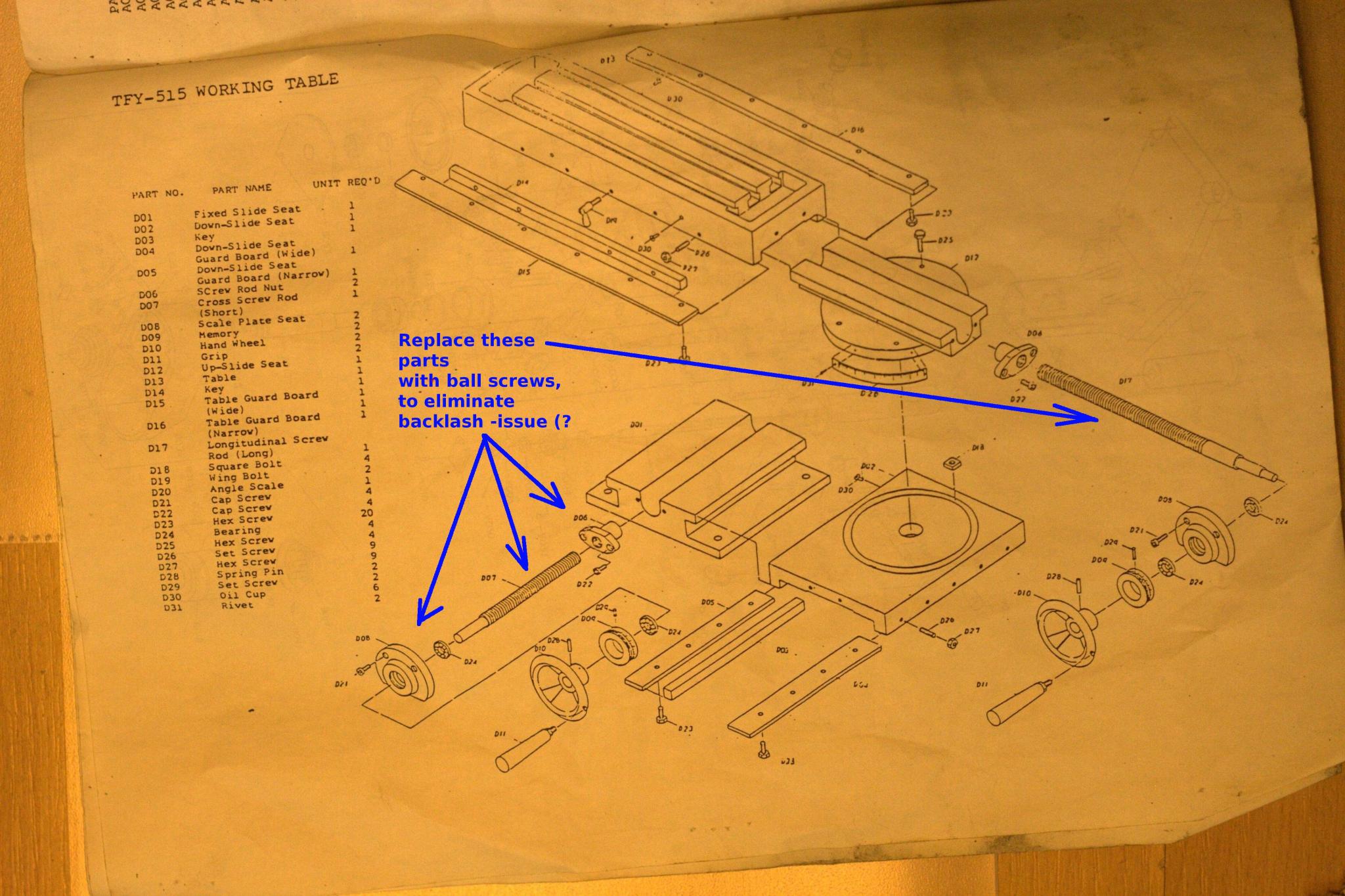

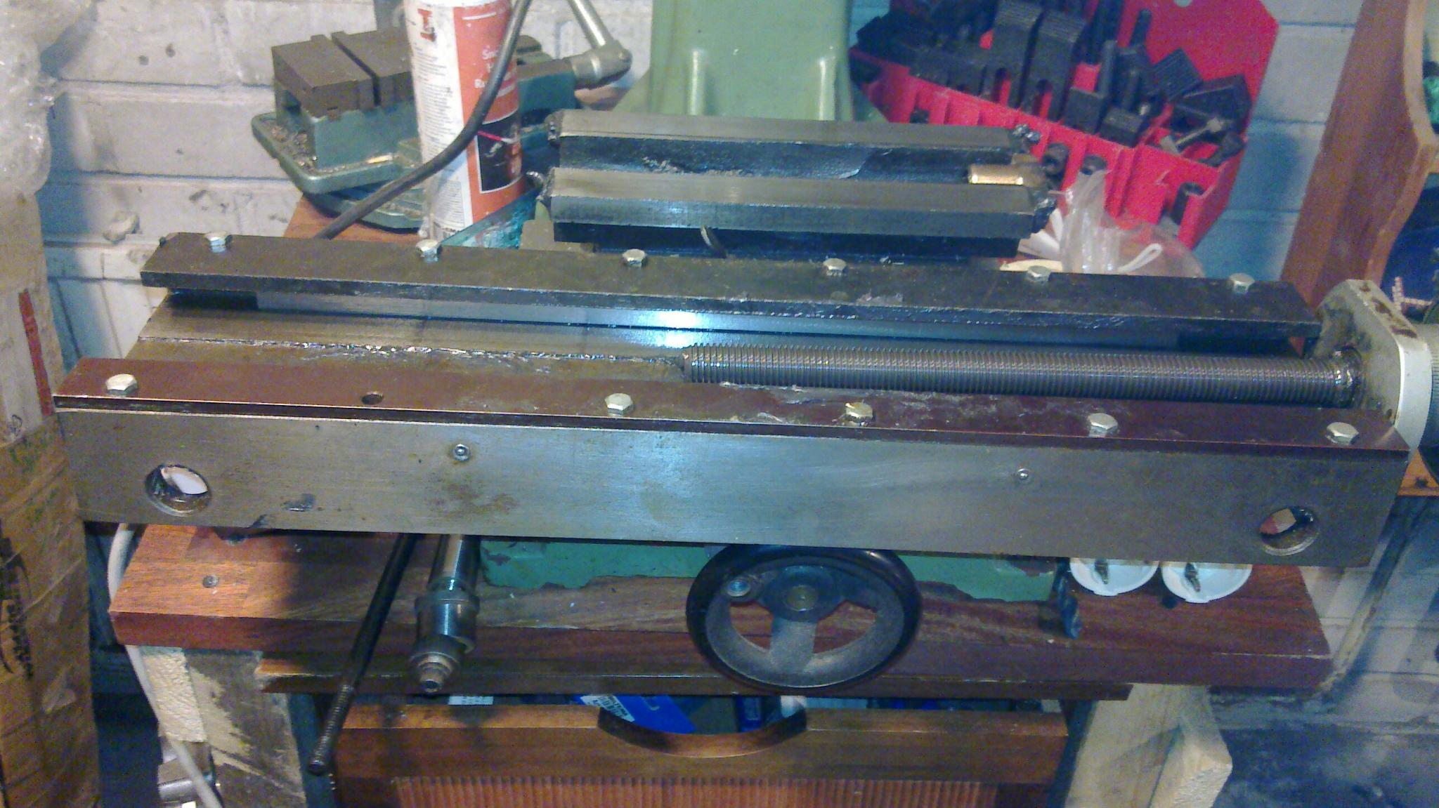

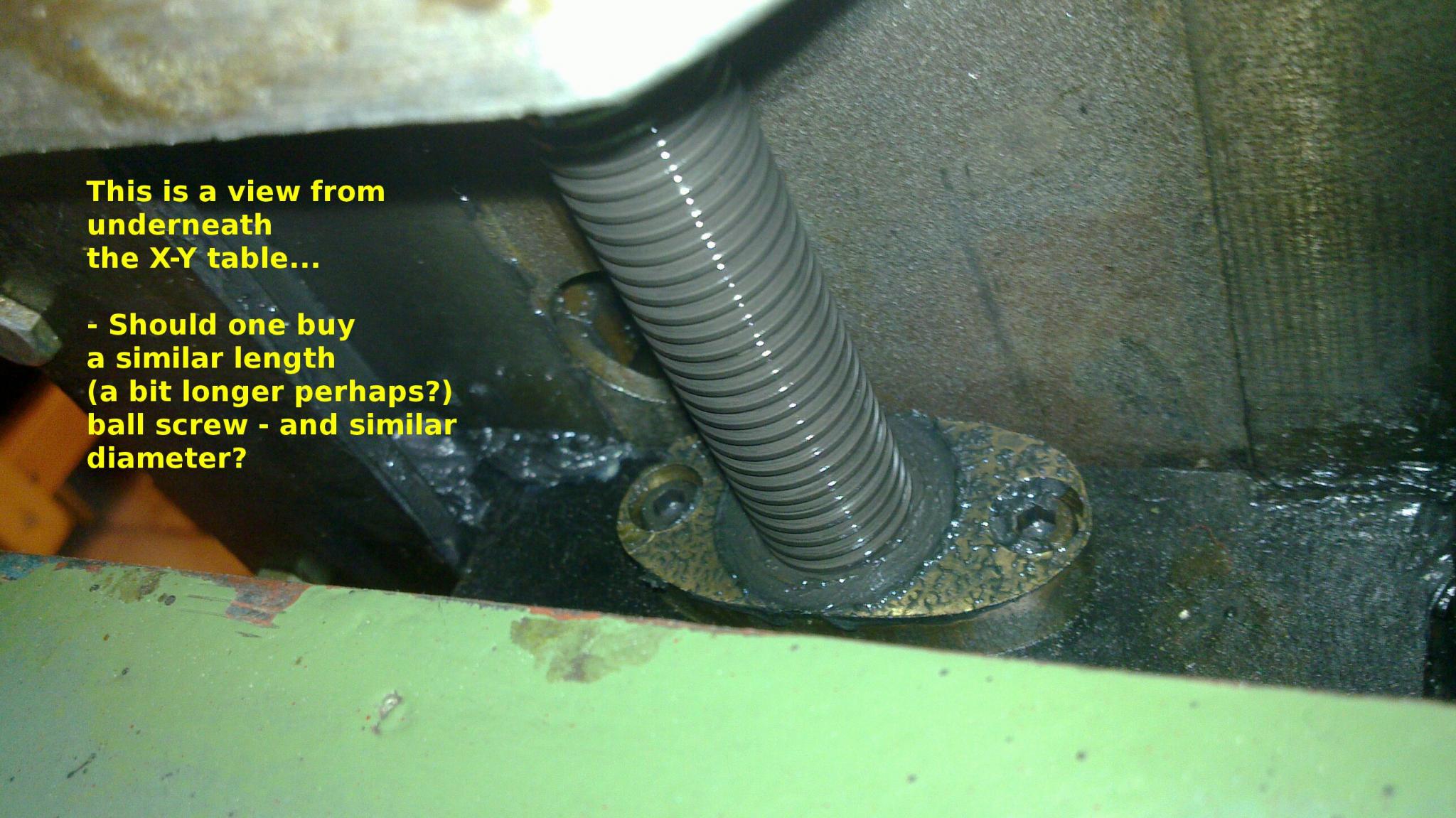

    3) Noticed, actually there is slack in X/Y -axes,too.
    - So while we are at it, maybe retrofit ball screws, there too?
    - How to choose correct ball-screws?
    -- Length: existing screws + a bit more?
    -- Diameter: similar to existing screws? (does it matter if they are not quite the same?)
    -- Where to go from here? Take the table apart, to measure existing screw? Make a mockup / sketch?

    4) X/Y -table drawing / plan of parts to change?

    A friend of mine converted his vicroy and here is what he did:
    1.left original screw in the lower knee Z and a powered this (backlash is less of an issue here)
    2.left the spindle Z as manual so at to always keep this up and maintain as much rigidity as possible during milling ops (still had the option to lower if needed)

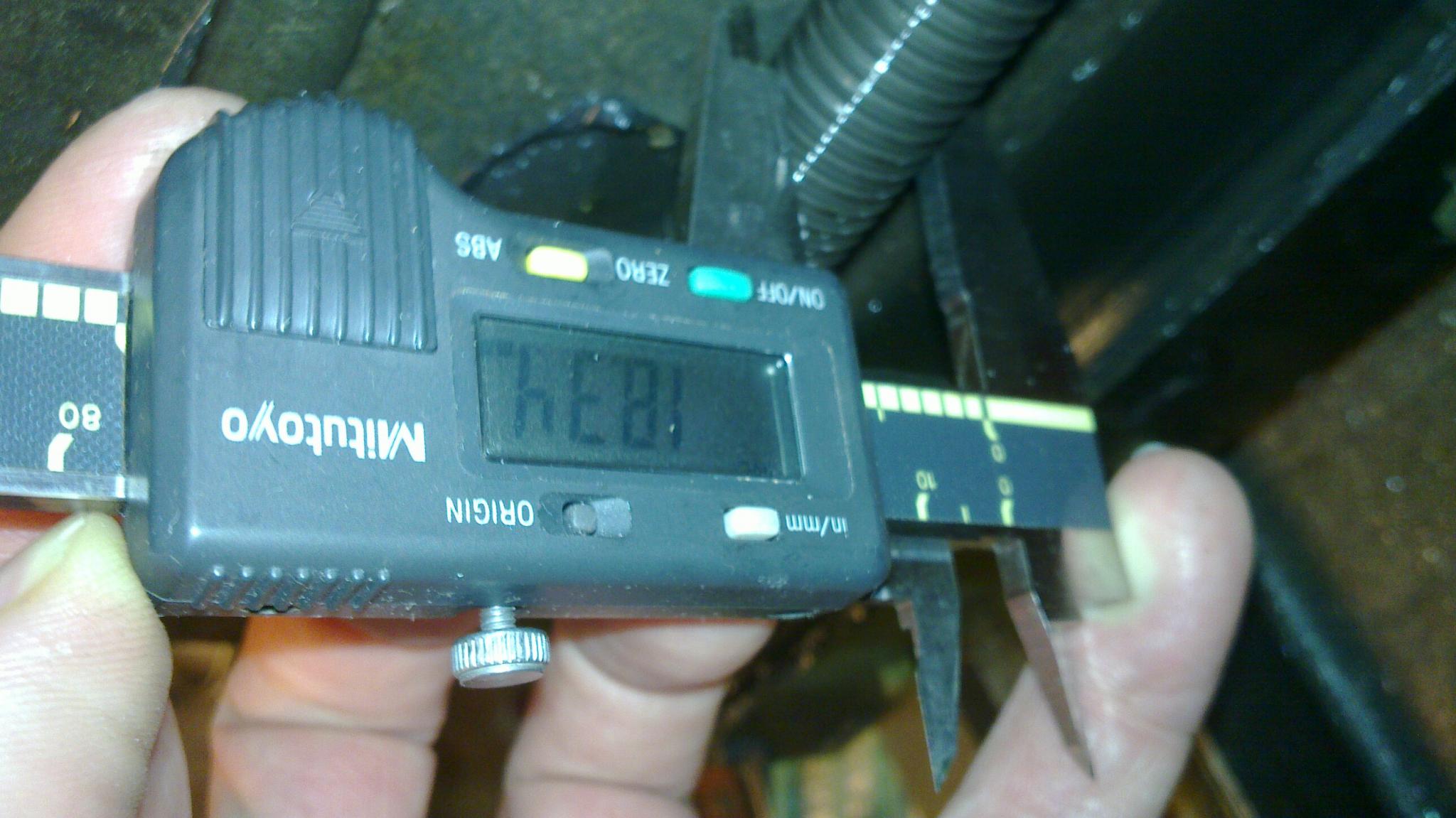

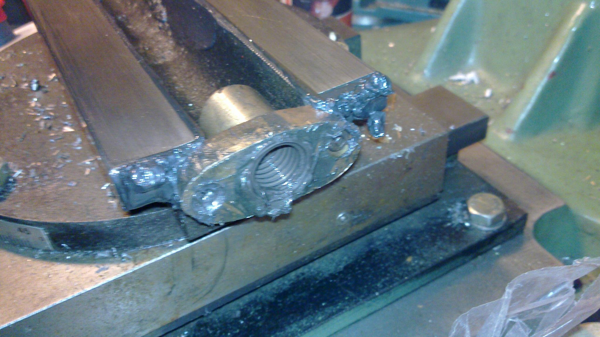

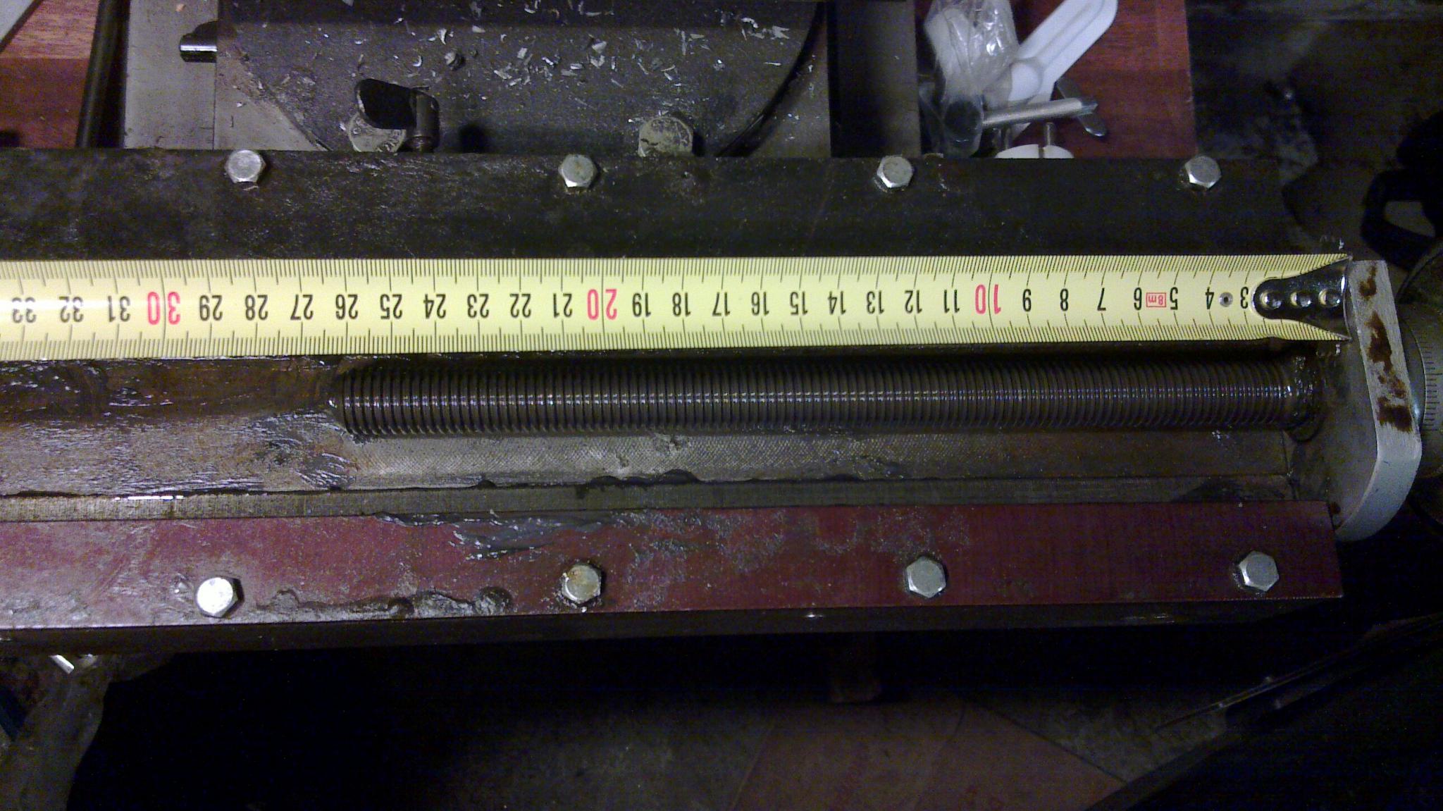

    1) Take measurements of the mill (King Midas)
    - take photos too.
    - Here are a couple of greasy pics, from dismantling the X/Y -table (From left to right: 1) overview; 2) X-axis dismantled; 3) X-axis leadscrew is 260mm, think it could be a bit longer; 4) x-axis one end; 5) Leadscrews are 18.34 mm thick; 6) Y-axis leadscrew at 175mm, think it could be longer)

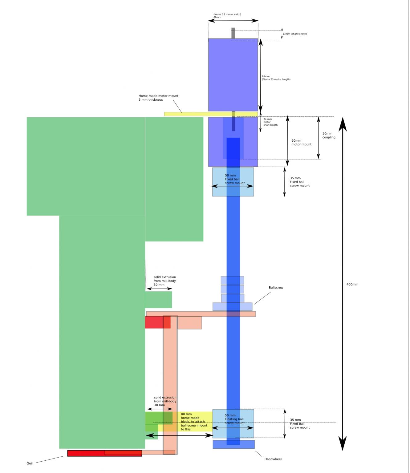

    2) Make a sketch of the Z-axis ballscrew -conversion
    - think how the motor would be mounted
    - how long ballscrew one might want
    - how the thing would work
    - This sketch is from side of the mill. (used inkscape to create the original graphics)
    - Green is the body of the mill
    - Blue bits are those that I'd try to buy ready made
    - Red bits move up/down as "one unit", with the quill (and ballnut)
    I am a bit concerned about the (horizontal) distance between the ballscrew, and the quill.
    - the King Midas -milling machine is a bit difficult shape, like a mushroom.
    -- Thought about using pulleys/belts, to bring ballscrew horizontally closer to the quill. But then, if possible I would like to avoid any added complexity, because of my non-existing experience with these beauties.
    -- Another concern I have is the length of the Z-ballscrew (somewhere around 370mm), and no support in middle.
