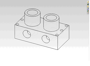

    Many thanks for the very informative reply and taking time out to help me , I have included a copy of a screen shot that a design chap put together for me a while ago.. He drew it up for me as a favour during his lunch time last year , I passed him a stack of photography books and helping him out with a camera... I have a STL file for it and can open it with a copy of freemill.. The part needs some re work but I cant see that as a problem back to the design chaps, which should not cost too much as I have the file already.
    This is the type of thing I would like to make , it will be made from Acetal along with about another 7 or 8 jobs I am working on , I was made redundant in the middle of last year so the parts are for some equipment I am working on. I have had some of the parts out for quote from some of the engineering companies I used in the past but the prices that come back are a little frightening .. To be honest they are small batch work that’s probably more of a pain to make.. which I fully understand ... I have made up a test part by hand “ knife and forking it “ has my friend Ray would have said . Would this be classed as 3d or 2 ½ d

    So come have a cuppa, bring your acetal and we'll knock them off in no time. They are 2D/2.5D by the way.

    I reckon if you can machine a solid with straight sides that just have depth or pockets/protrusions then it would be a 2 1/2D part. Your part has pockets (holes) in the sides as well but that just means you need to turn the part through 90 deg to do the drilling or milling for them. So it is still 2 1/2D.
    5 axis machines would pump these things out like there is no tomorrow.
    3D parts have curved surfaces or complex surfaces like the parts from for3d on the Russian site. They are all 3D.
    The manufacturers would be charging you for set up time and programming the part. The actual part is pretty easy to make but making a jig or setting it up in a vice accurately every time is where the money comes into it. And you are right, they don't make much money on small runs so usually go for the larger runs to maximise profit.
