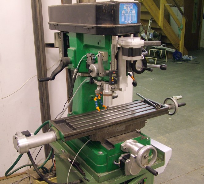

    Subject of conversion in this thread is a mill from 1980's.
    There are some underlying issues that I would hope to address during the conversion:
    - huge slack on Z-axis (covered here in detail: http://www.mycncuk.com/forums/showth...g-a-conversion )
    - large slack on both X and Y -axis

    In view of the mill, please can anyone spot here
    1) Something clearly wrong ? (something one would regret later?)
    - eg. size of motors
    2) USB vs. parallel port
    - that is something I keep on thinking. Have read about arguments for / against.
    - Kind of would like to go USB, but I have read parallel port is the right thing to do.
    3) Cables and sundries
    - worried about little bits missing from the list. (trying to buy all in one go, to save on shipping fees)
    For now I have left out from shopping list "pulleys" and "belts". Hope could have this machine running some day, then later add belts/pulleys. Not sure how this conversion is going to turn out, will it run or not.
    Motors and drivers are a good choice. What voltage is that 400W PSU?
    I would substitute the couplings (4) for timing belts and pulleys. It makes it much easier to mount the motors as no faffing about getting them on concentric, reduces resonance and allows you to choose the ratio to get either better resolution or speed.
    For (5),(6),(11),(12) make your own as you can use the milling machine to make them better than the commercial ones and much much cheaper.
    USB / Parallel. If you use USB I doubt you'll regret it, but why not try the parallel port first as it costs virtually nothing to try?
    For the stepper motor cables most people use 4-Core CY, 1.5mm^2 cable. Also add E-stop switch, limit switches and connectors for stepper motors.

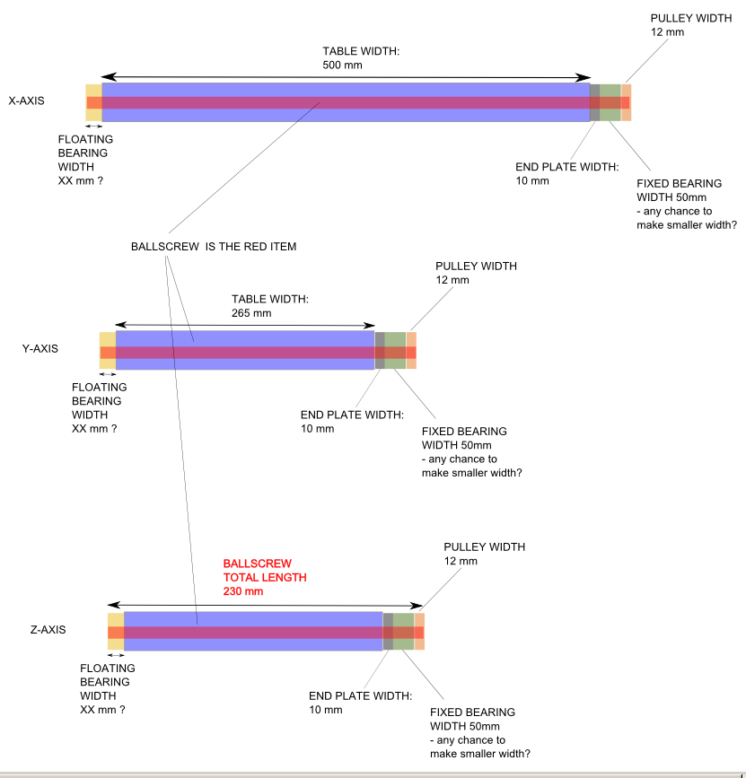

    Here is a new draft of the ballscrews. Lengths change a bit, from going to pulleys/belts instead of directly driving the screws

    A ball screw is best held in tension by Belleville washers to compensate for thermal expansion, one thrust race at either end.
    If you lengthen the XY shafts at one end you can keep the handles.
    Run the table to it's ful travel and ask yourself where the CNC parts are going to fit in the available space.
    Experience tells me that being new to this you are very unlikely to believe this is necessary. You feel a compelling desire to see it cutting, don't want to go back to the drawing board now and spend extra money on machining screws. I only mention it so I can say, "Told you so" later on :naughty:
    Yes Robin, back to drawing board it is. Really appreciate your advice, glad I didn't yet buy wrong length ballscrews.
    Went to garage, moved X/Y -axis back and forth full travel. Need to lengthen the ballscrews, pulleys would now crash to the table.
    Not only that, but realized that it might be possible to extend X/Y -axis travel a good couple of inches, with minor changes.
    - Had not really thought, where one would fit the ballnut, and where screw would be mounted. (attach ballnut to upper part (the one sliding), or lower part vs. the other way around, that kind of things)
    - Below is a sketch of the Y-axis movement (current vs. possibly future). Changes would be: 1) a longer ballscrew; 2) attach ballscrew to the table that does not move; 3) attach ballnut to the table that moves, at the centre.
    This is all new to me. Thanks will look for pics from google. Another thing I don't quite understand yet, is the construction of the "fixed mount" for the ballscrew. (still thinking whether to buy ready made, or DIY).
    Quote Originally Posted by diy-john View Post
    Wow! If you are okay to take advice you can make one hell of a machine. I got it right on my third set of screws when the penny finally dropped.
    Problem is, you need a CNC mill to make a pretty CNC mill which is why I was suggesting you cobble something together first. Hope you have a lathe, really do need a lathe.
    I used pairs of Belleville washers to apply a preload of 500 lbf. One pair for each screw to hold the axial bearings in tension, one pair for each double ball nut.
    That means there is no play in the system, apart from the column bending, so long as the load does not exceed 500 lbf. It was a lot of work but is quite delightful to use and all self adjusting.
