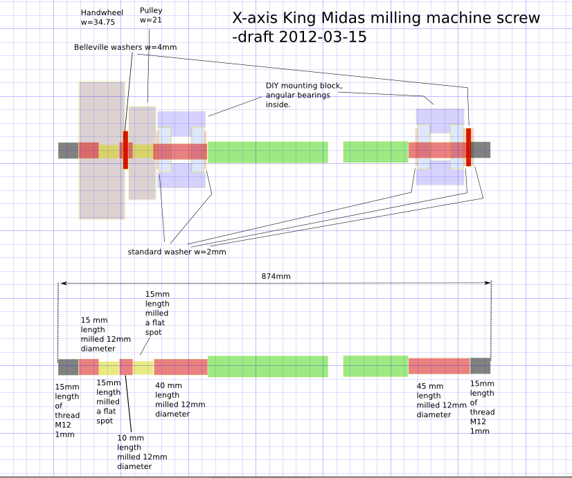

    Made another draft of X-axis screw. Please is this any good now?
    - added a thread to the other end. And also a similar "structure, a fixed mount" for the ballscrew. So there are now two such mounts, one at either end of the screw.
    - there are two (2) screws in picture below, but it is the same one single screw.
    -- The other one just highlights, what components would fit, and where. Like hand-wheel, pulley, shims, Belleville washers.
    Not sure about the dynamics, kind of figured out, that with this setup, the Belleville -washers + half nuts at either end of the screw ---> would tension the screw sort of around either end fixed mounts. Please correct if you think one has mis-understood the principle.

    To put the screw in tension you don't want to have pairs of angular contact bearings at both ends, as that fixes both. You need a pair of angular contact bearings at one end, and a standard deep groove bearing plus Belleville washers and thrust bearing at the other end to provide contact force for the tension. If both ends were fixed rigidly with angular contact bearings the tension in the screw would depend on the relative spacing of the bearing blocks and the length of the screw between them, so there's no way to set it.
    By 'standard washer' I assume you mean an accurately machined washer with parallel faces. You don't need a washer between the ballscrew end and angular contact bearing as the bearing is most accurate resting on the machined shoulder on the screw.
    That looks horrible. I'm obviously not explaining this at all well.
    To put the screw in tension you just need one angular contact bearing at either end. The Bellevilles try to stretch the entire screw end to end. Adding more bearings just gives you an alignment nightmare. There is hardly any side loading on the screw to worry about, so don't worry. I used one bearing at either end of my overlength X screw and it was fine and dandy.

    ... and only one pair of Belleville washers, you don't want to balance the screw between two springs because that can move.
    Thanks again Robin
    Please would this setup make the X-ballscrew dandy? (is this what you mean?)

    Sorry if this obvious to some of you. I tried to figure it out, that
    - if you now tighten the screws at each end of the X-axis screw ---> the nut(s) will push the Belleville washer ---> the Belleville washer will push the bearing ---> the bearing will push the fixed bearing mount. But because the bearing mount is fixed, then tightening the nut(s) will pull (try to stretch) the screw from either end.
    Please correct. (is this getting better or worse? Tell me)

    Good, only one small mistake. You only leave a gap on the left hand side, the tension end. On the right you want the 12mm nut to grip the angular bearing inner ring against the step in the screw. That gives you something to tighten the nut against so it stays where you put it. Don't want that right end nut free to unscrew itself.
    The gap on the left only needs to be long enough to stop the 16mm part of the screw ever touching the bearing. If it does touch then the Belleville washers stop pulling on the screw.
