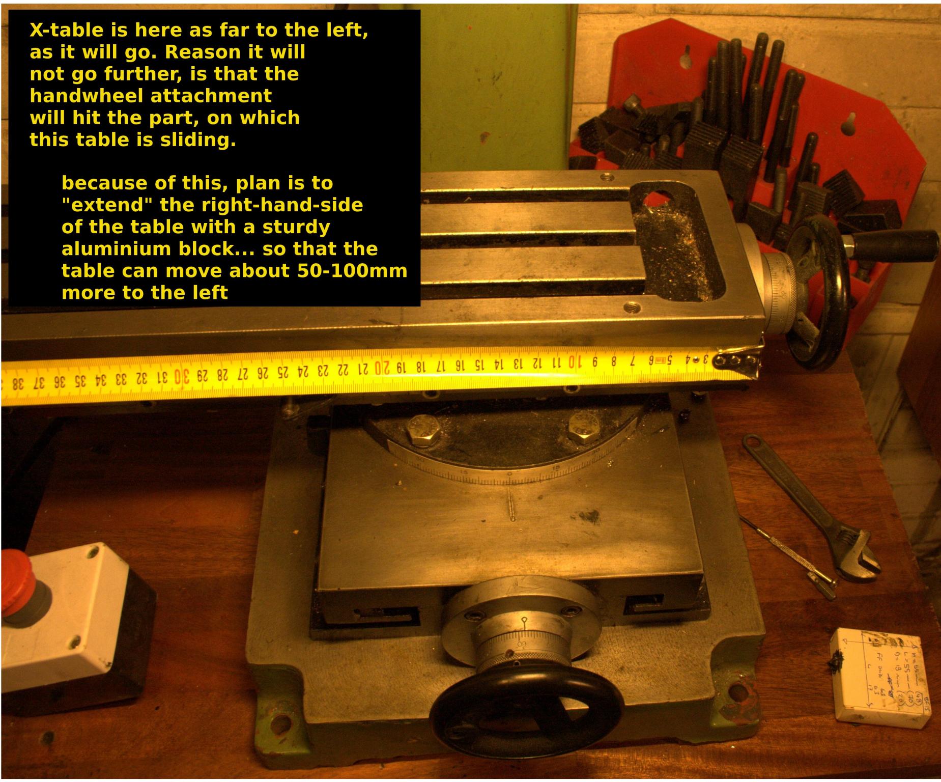

    Subject of conversion in this thread is a mill from 1980's.
    There are some underlying issues that I would hope to address during the conversion:
    - huge slack on Z-axis (covered here in detail: http://www.mycncuk.com/forums/showth...g-a-conversion )
    - large slack on both X and Y -axis

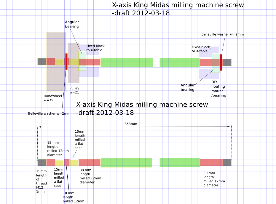

    Here is a new draft of the ballscrews. Lengths change a bit, from going to pulleys/belts instead of directly driving the screws
    .Click image for larger version.
