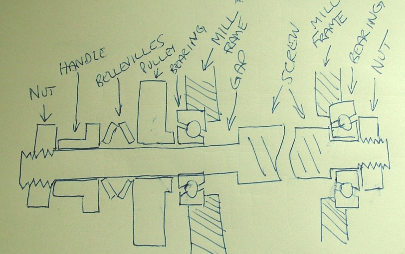

    ... and only one pair of Belleville washers, you don't want to balance the screw between two springs because that can move.
    A few design tips.
    I bolted the X screw pulley solid to the inner race. I sprung the sleeve that takes the handle at the other end. This reduced the bearing overhang I couldn't avoid on the Y.
    Putting the handle on a sleeve means I can pop the handle off without detensioning the screw. Handy if I want to work on something that overhangs the end of the bed.
    I mounted the X motor facing the unlikely way round and extended the screw to get clearance on it. This makes it a lot easier to mount, easier to change the belt and easy to pop a cover over to keep the crut and fingers out.
    My X motor mount isn't actually bolted to the machine, it's free to turn. I was going to Loctite it in place but found the 500 lbf screw tension quite sufficient to hold it. I lean on it occasionally, if it ever moves I will know I have lost tension.
  3. #33
    To put the screw in tension you just need one angular contact bearing at either end. The Bellevilles try to stretch the entire screw end to end.
    I used one bearing at either end of my overlength X screw and it was fine and dandy.
    Thanks again Robin

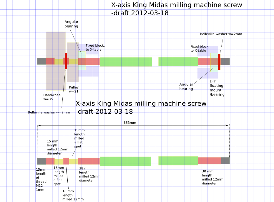

    Please would this setup make the X-ballscrew dandy? (is this what you mean?)
    Sorry if this obvious to some of you. I tried to figure it out, that
    - if you now tighten the screws at each end of the X-axis screw ---> the nut(s) will push the Belleville washer ---> the Belleville washer will push the bearing ---> the bearing will push the fixed bearing mount. But because the bearing mount is fixed, then tightening the nut(s) will pull (try to stretch) the screw from either end.
    Please correct. (is this getting better or worse? Tell me)
    Thanks!

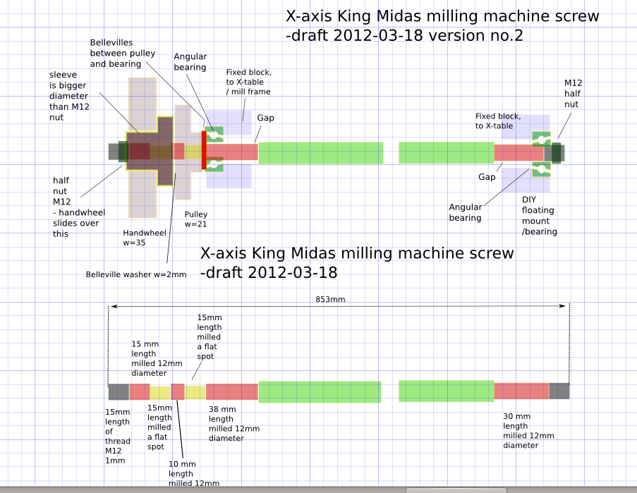

    Try this pic for the X screw in tension...
    Right hand nut down tight.
    Left hand nut tensions the screw.
    Personally I'd put the pulley at the other end to reduce the overhang.
    I should have drawn the handle fitting bigger than the nut. That way you can put the handle on and off without removing the nut.
    Edit: I should also have put the Belleville washers on the other side of the pulley so the pulley grub screw doesn't have to slide. I can redraw it if you want.

    Cool Robin :) - Thanks!
    That picture is worth a thousand words. Updated X-axis draft accordingly.
    - added Belleville -washers on the other side of the pulley, like you say
    - the sleeve, on top of which the handwheel comes is a nice feature.

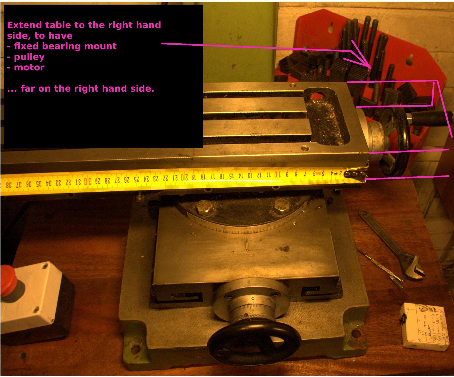

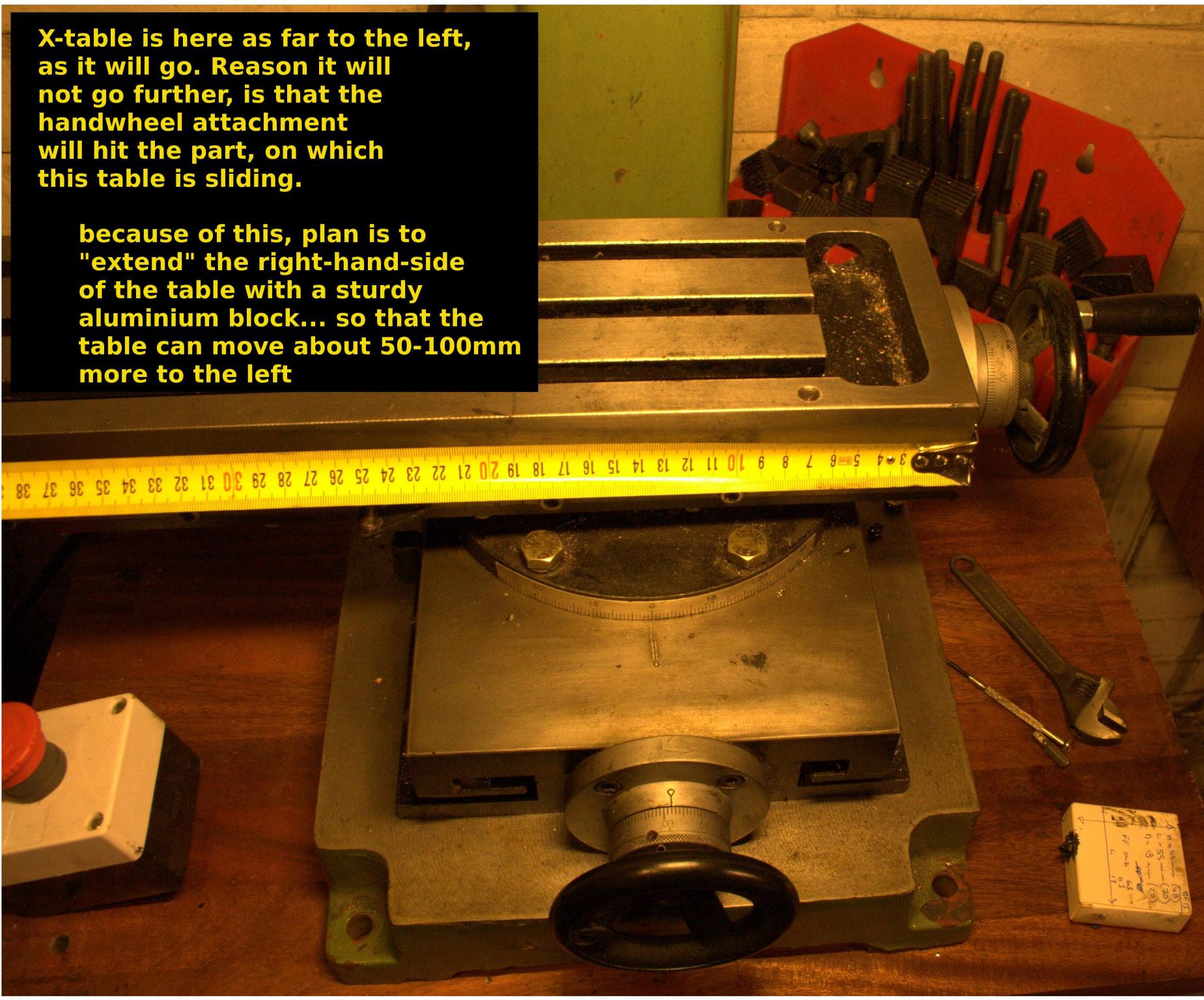

    Now, have thought about this overhang. Might as well say now, what I have had in mind, but before reading further, make sure you sit tight and don't spill any coffee.. :lol:
    The challenge is, that the X-axis movement is a mere 220mm, though the table is 500mm wide.
    Thought of moving the
    - handwheel
    - pulley
    - motor
    way out of the end of the table, on the right hand side.

    This "extension" would change X-axis movement from 220mm to around 400mm. Think there might be challenges ahead, with accuracy/slack, at the far end of the X-table movements. However, I have reasoned, that perhaps one could bring the slack down with careful adjustment. Just have been thinking, that there may be situations, I would rather live with a small slack at far end, than reposition the object on the table (because of lack of X-axis movement).
    Of course people will wonder, why one didn't buy a larger mill in the first place. But what do you think, is this "extension" something one definitely should not do? Please comment :)
    - extension would not be for attaching, or supporting pieces on table, but rather bring out the X-axis motor, pulley, bearing block.

    On my mill the original handle / bearing arrangement already clears the casting that the bed runs on. The extra travel that 'gains' has proven invaluable on numerous occasions. As you say it's bound to not be as rigid as using the standard travel, but I've never noticed it.
    You could use some decent size aluminium bar for the extension and use it to house the bearings. Convenient as you can do it all on a lathe.
    Is it convenient to add another (e.g. 6201) bearing at the driven end of the screw? I'd prefer to have the screw supported with two bearings at one end as otherwise I suspect the significant radial force due to the tension of the timing belt will tend to bend the screw about the single angular contact bearing. Might be negligible in reality as clearly it works for Robin without ... ?
  7. #37
    Good, only one small mistake. You only leave a gap on the left hand side, the tension end. On the right you want the 12mm nut to grip the angular bearing inner ring against the step in the screw. That gives you something to tighten the nut against so it stays where you put it. Don't want that right end nut free to unscrew itself.
    The gap on the left only needs to be long enough to stop the 16mm part of the screw ever touching the bearing. If it does touch then the Belleville washers stop pulling on the screw.
    My handle fitted inside the saddle, if it didn't I would have extended it. My X motor didn't fit so I extended that end a long way.
    The extension can be as long as you need, it doesn't have to be wide.
    A wide extension could get in the way of the motor. Allow room for the motor, you don't want the motor hitting the saddle or getting in the way when you want to turn the handle.
    The extension has to take a big axial load from the Bellevilles.
    The radial load is the motor torque.
    The side loading is ordinary workshop bumps and knocks.
    It has to hold the bearing square, otherwise the screw will flex when you turn it.
    It is comforting if the extension carries any motor heat in to the bed, so the screw doesn't warm up.
