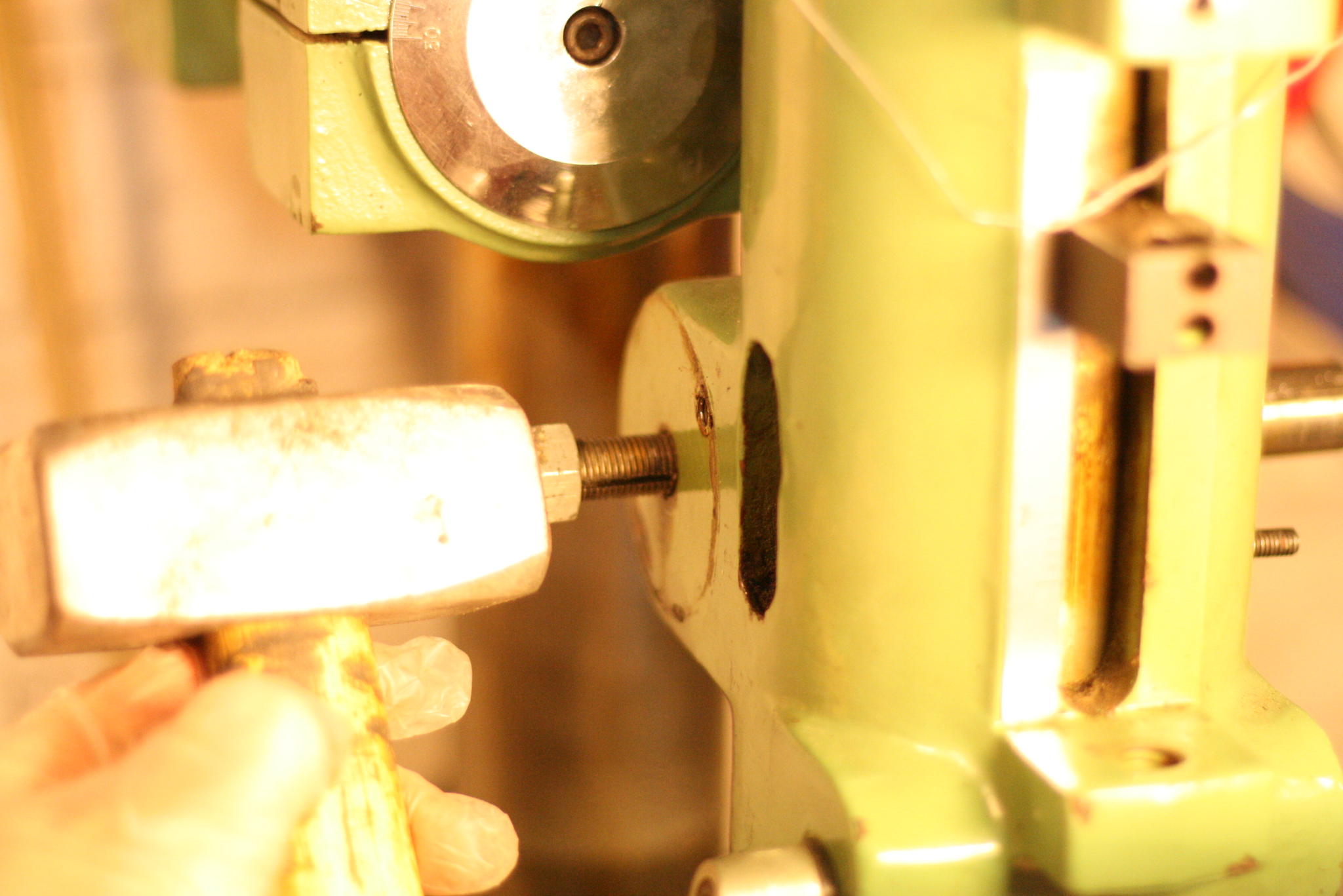

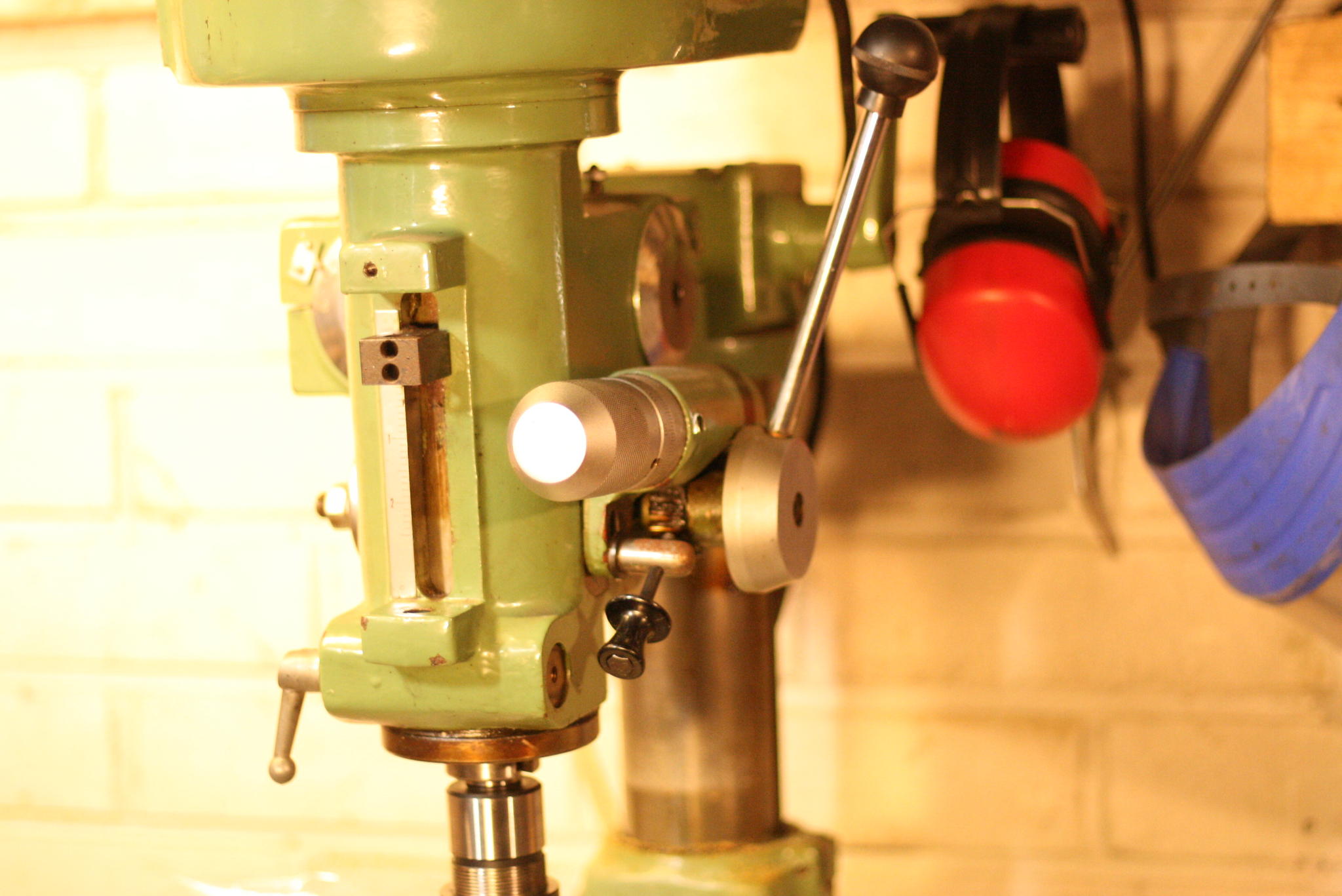

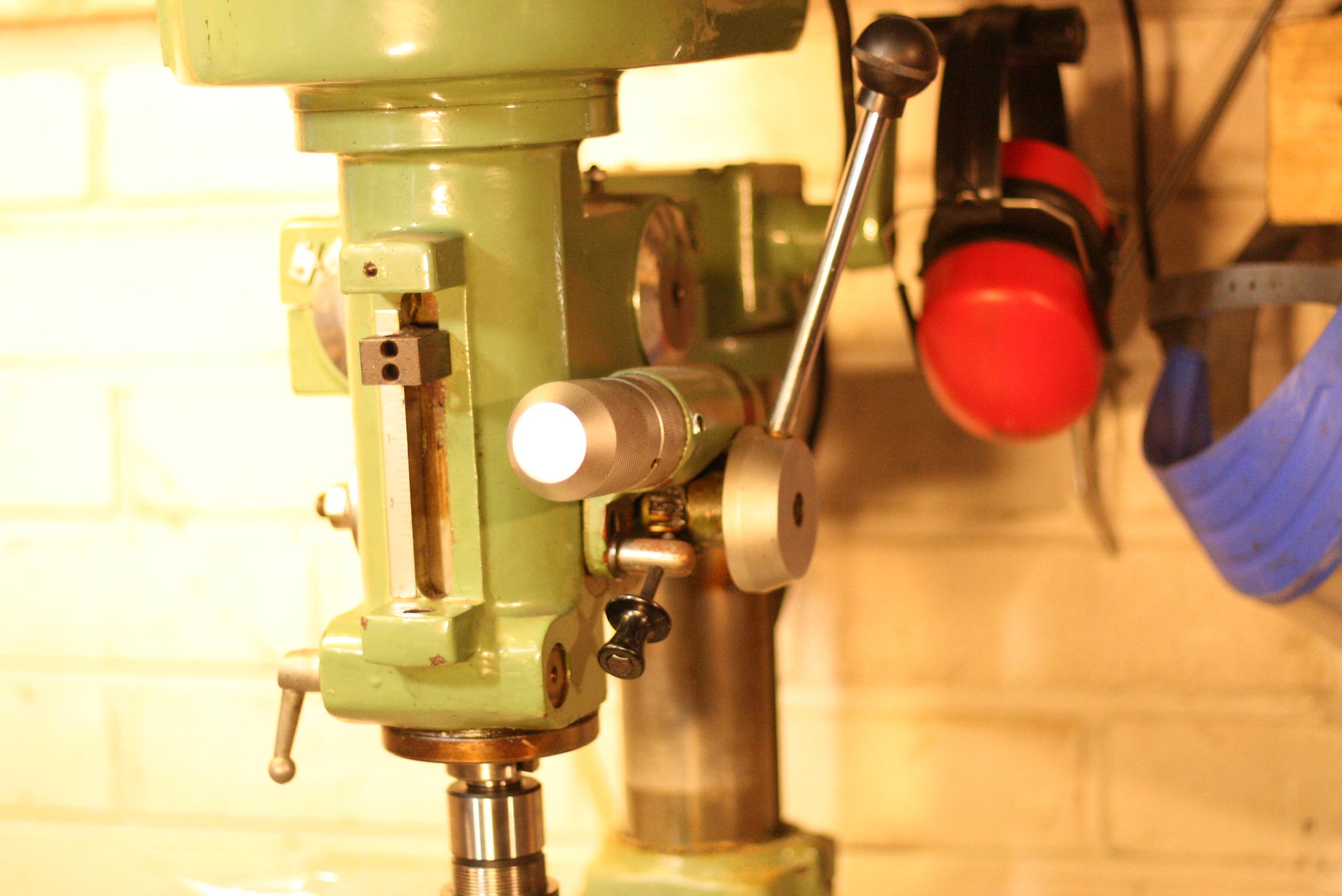

    Have you tried tightening the two nuts in picture C against each other, so that they lock on to the thread, then use the inside one to unscrew the threaded rod? If it's in a tapped hole that should get it out.
    I wouldn't worry too much about the hand lever. I tend to remove the hand levers on my mill when I'm using it with CNC since they have a tendency to hit stuff (or me) if I don't!

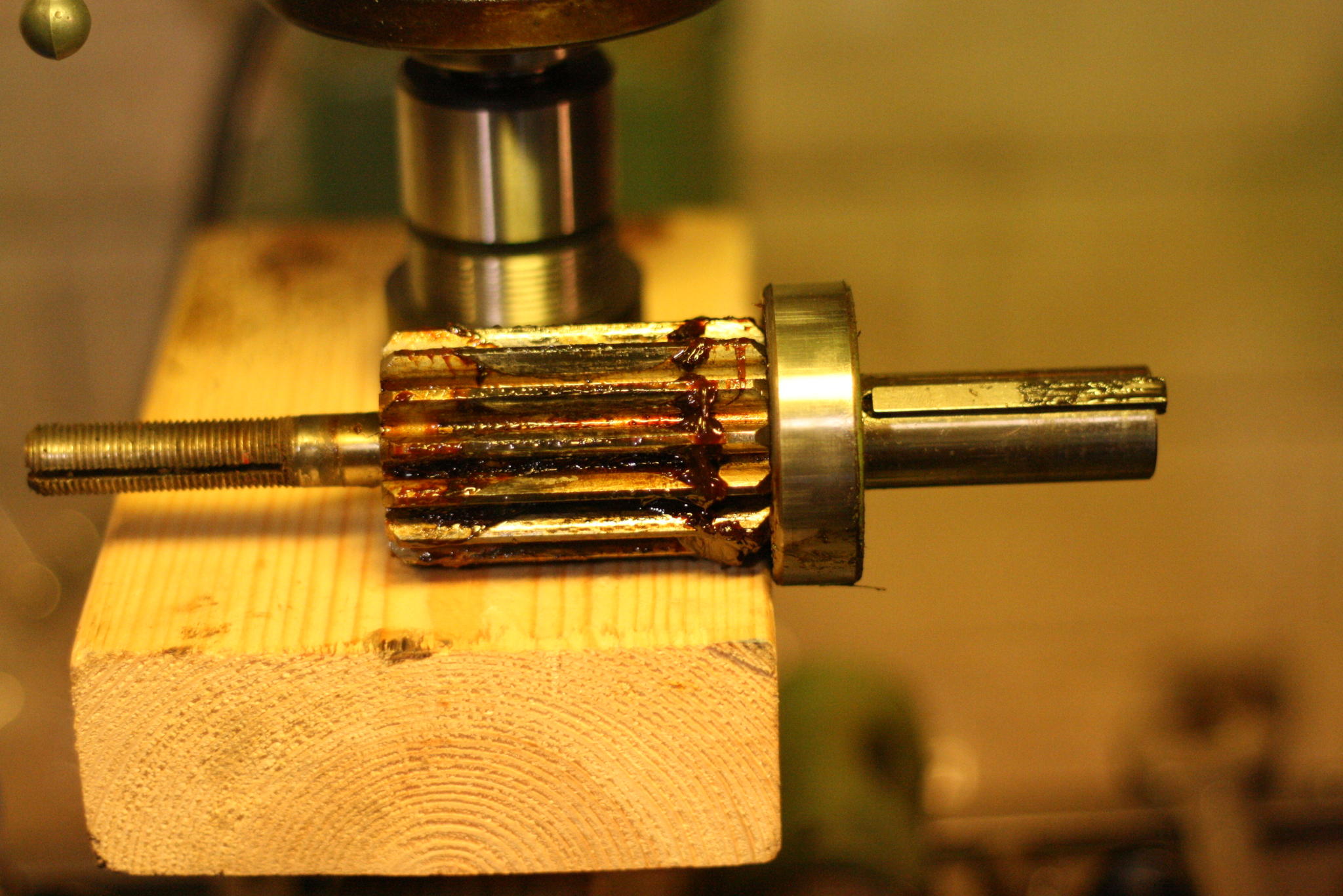

    A small update:
    - the pinion gear eventually came out by punching the bearing out, slowly and carefully, from the opposite side
    - here is the gear/bearing that came out - this is all obsolete now

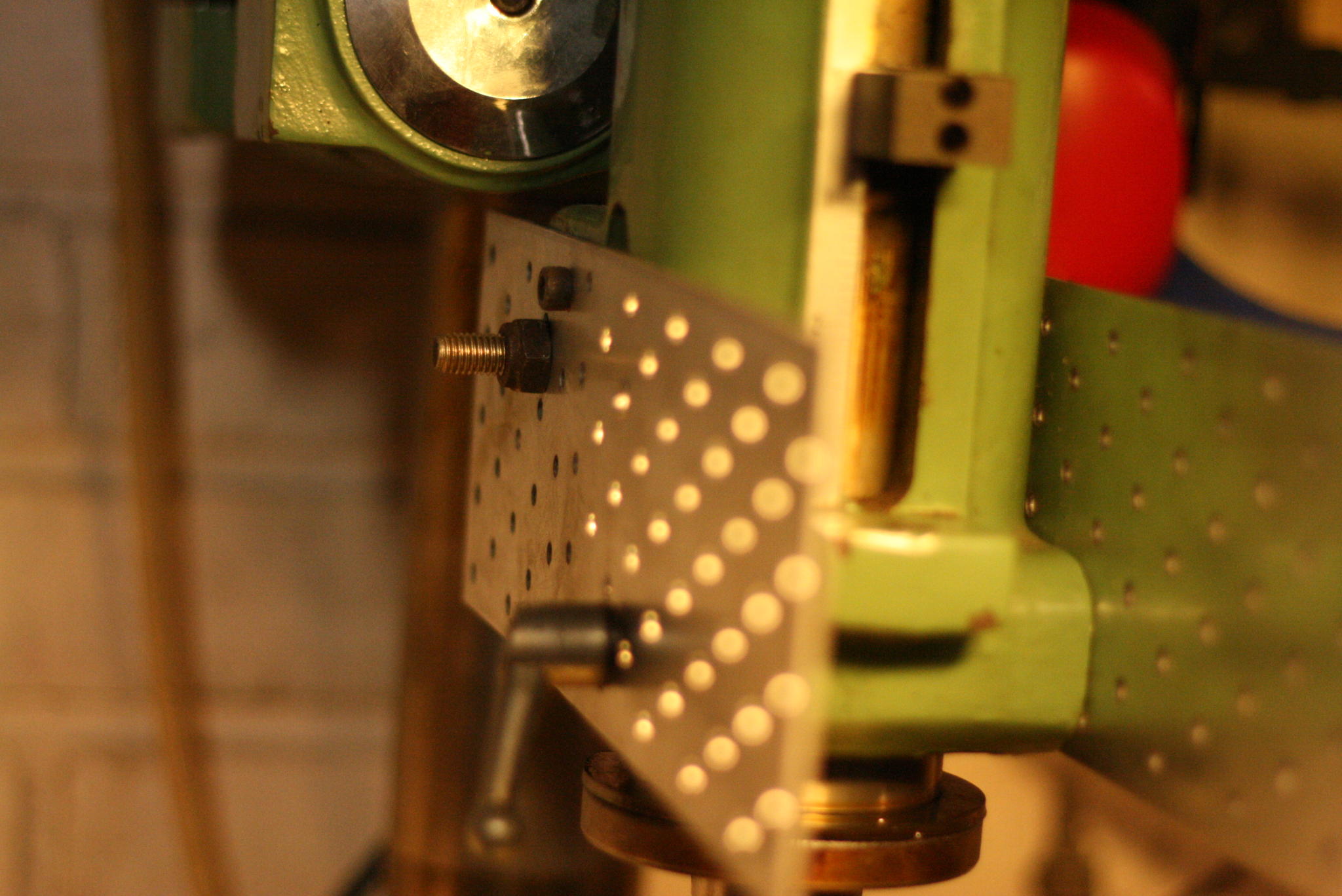

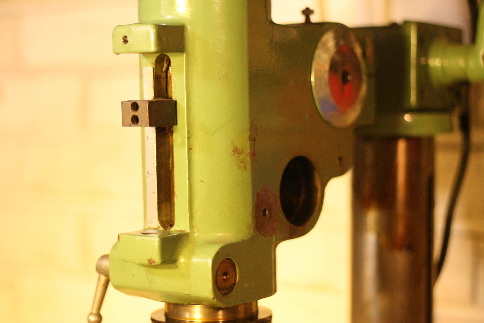

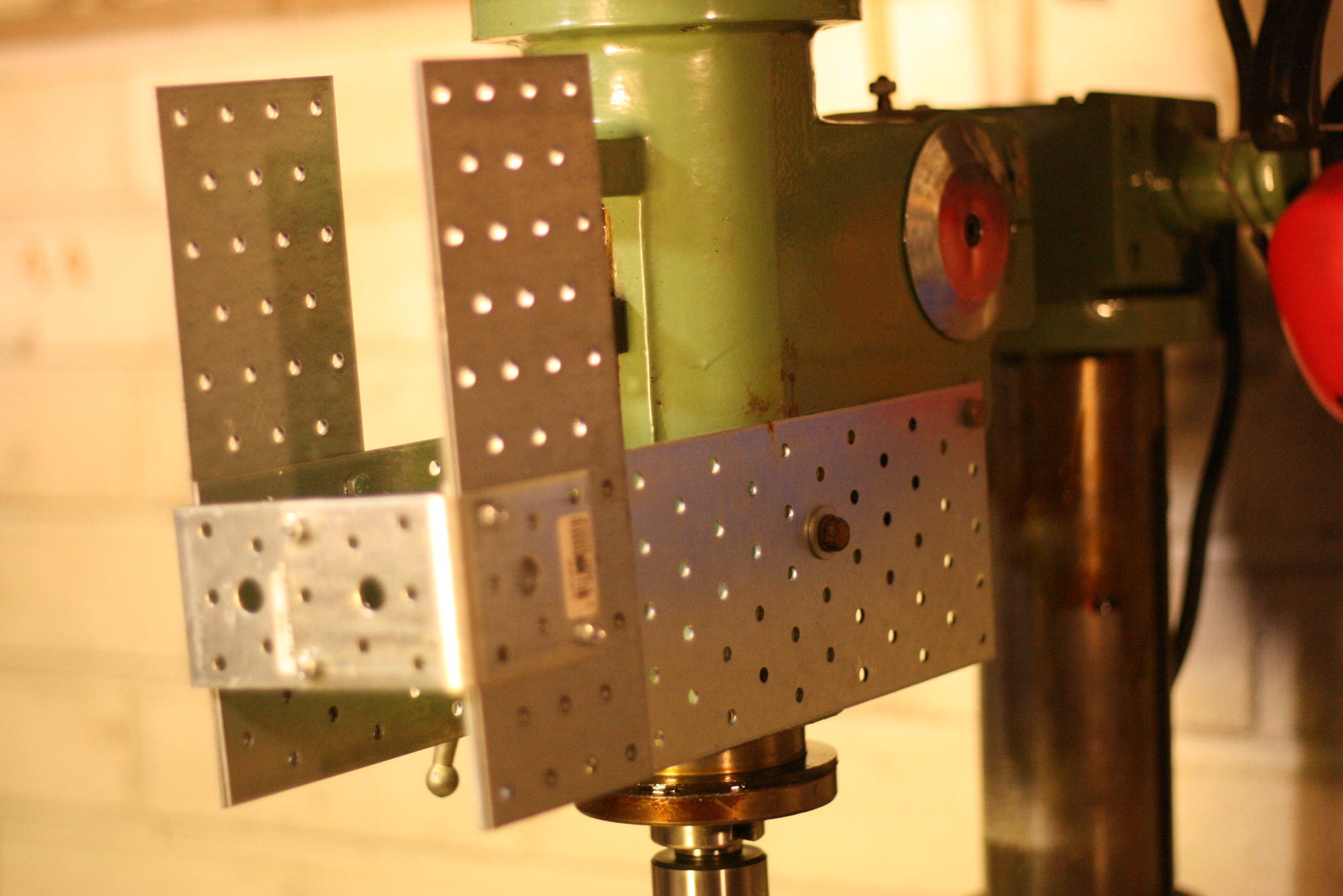

    - now the Z-axis looks mean and lean (LEFT: BEFORE, RIGHT AFTER)
ID:	7183Click image for larger version.

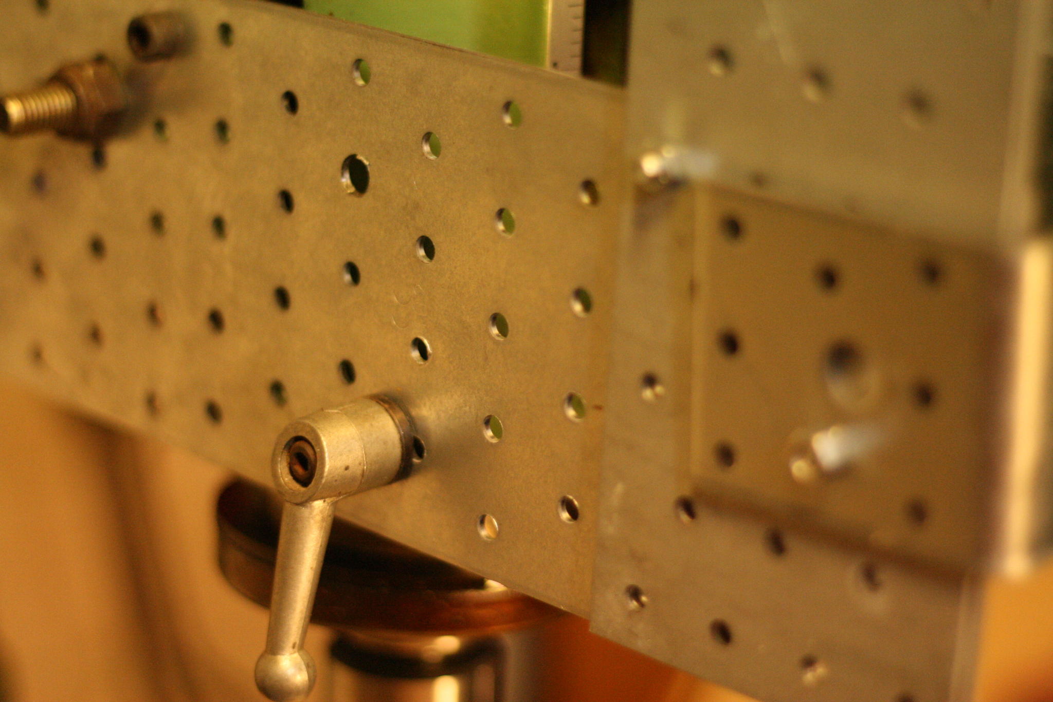

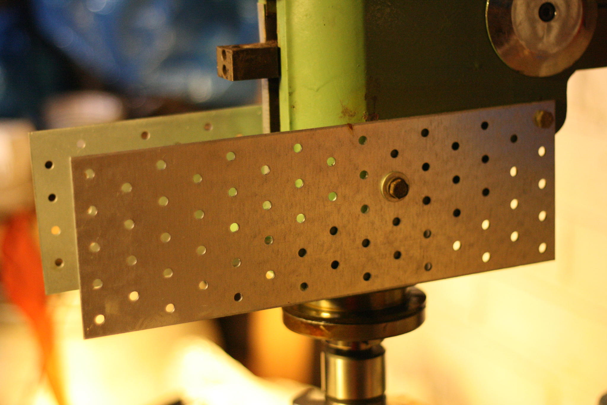

    - Now, I have bought a pile of these sort of building materials, and plenty of short 5mm bolts/nuts
    -- They are made from galvanized iron, (or the more expensive ones, are stainless steel, very rigid)
    -- Aim to attach bearing mounts to structures made from these building materials
    -- This is cheap, but thought would make a running mock up with them.
    -- Hope that way one could run the machine a bit, check dimensions again, check where to improve --> then make rigid, nice looking parts from aluminium.
    Maybe this ugly duckling will turn to a beautiful swan some day.

    The sensitive drill part is really useful when you come to hammer a collet out of the taper, it gives you something to hammer against.
    Best if you can release the Z axis screw before you hammer so you aren't bashing against expensive ball nuts and bearings.
  4. #64
    Good point Robin. Thanks!
    Alternatively, perhaps one could use the lever on the left hand side of the quill, to lock it (during hammering)
    - Not sure though is it strong enough / meant for that purpose.
    Hoping to receive some bearing mounts, before weekend, so would have something to play with..

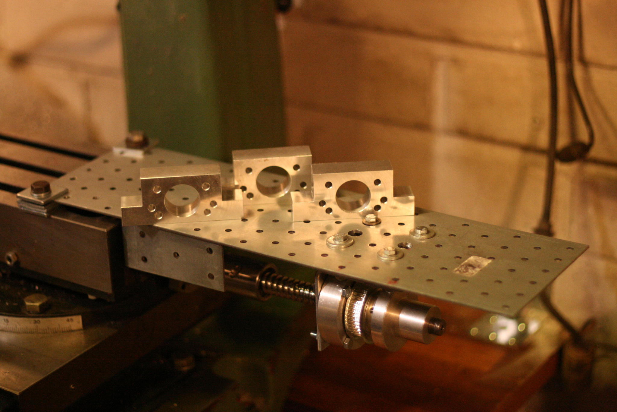

    [x] received six (6) bearing mounts for the ballscrew -bearings
    - a small local workshop made them for me.
    - these are temporary bearing mounts, but very good at such.
    - Holes for bearing are 32mm in diameter. Used heat to expand the mounts, so that bearings would go in easier. Holes are quite tight and precise, think it is impossible to remove the bearings in one piece.

    [x] continued with a temporary, crude build
    - in particular Z-axis
    - Z-axis now looks like this Click image for larger version.
ID:	7230 Click image for larger version.
    - Z-axis lower bearing mount. Used an electric drill to fabricate some supports
ID:	7226 Click image for larger version.
ID:	7228 Click image for larger version.
    - Purpose is to make a mock-up of the build, write down anything that needs changed, and then hopefully make it a nice looking mill.

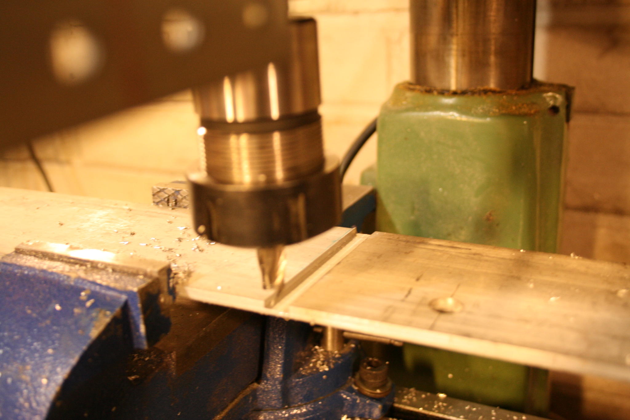

    Well she runs now, albeit slow and ugly, though to my eyes it is pretty
    Is this it? CNC -virginity lost?
    My smallest milling bit is a 10mm wide end mill, so the letters are fat beyond recognition.
    Machining marks are quite visible, and think all the axis give way when pushed hard.
    - Think the cut aluminium chips are around 0.2mm thick.
    - Have to check what sort of feed rates I used actually, and how fast the mill bit was turning. With my zero experience I just set them to something that didn't seem overly fast.

    I have now officially begun an intermediate -build of the CNC -conversion.
    - Focus is making now parts more rigid, and more like the final, beautiful build.
    -- One is using less thick (cheaper) materials here, than in what will be the final build.
    Today I have been using the mill as a manual machine, with LinuxCNC, using DRO's and Power feeds.
    - Trying to get used to G-code, use simple commands like G0 somewhere, G1 elsewhere... while cutting aluminium.
    - Measuring with a digital vernier, cutting a tenth here and there.
    Perhaps one had thought I am going to make a fancy drawing and export it into G-code. Send chips flying and ta-da, bolt everything in place, and have a ready CNC conversion.
    But it has not been like in dreams. Need to take one step at a time. It was fun cutting aluminium today. :)
