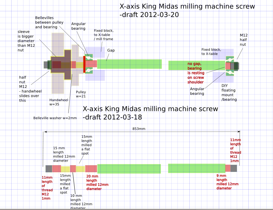

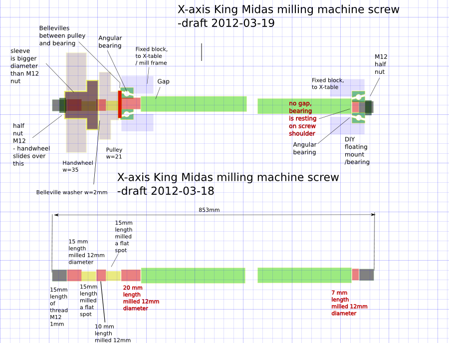

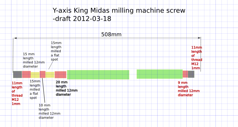

    You only leave a gap on the left hand side, the tension end. On the right you want the 12mm nut to grip the angular bearing inner ring against the step in the screw. That gives you something to tighten the nut against so it stays where you put it. Don't want that right end nut free to unscrew itself.
    The gap on the left only needs to be long enough to stop the 16mm part of the screw ever touching the bearing. If it does touch then the Belleville washers stop pulling on the screw.
    A tiny update to X-axis screw.
    - Red texts are updates.
    It is comforting if the extension carries any motor heat in to the bed, so the screw doesn't warm up.
    Will take a note of that. Again really good suggestions. Thanks!
    Project has been moving at a snail's pace, but that is okay, have already avoided many pitfalls.

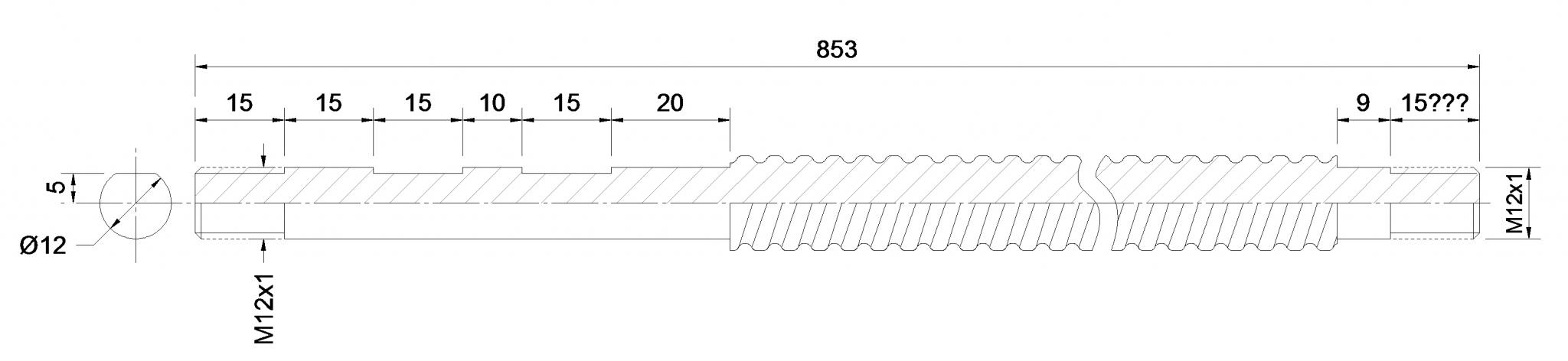

    What's the dimension I've marked with '???':
Name:	diy_john ballscrew end machining.jpg
    Pretty minor, but I changed the end bearing surface from 7mm to 9mm since the bearing is 10mm wide and it's best not to have the bearing resting on too much thread.

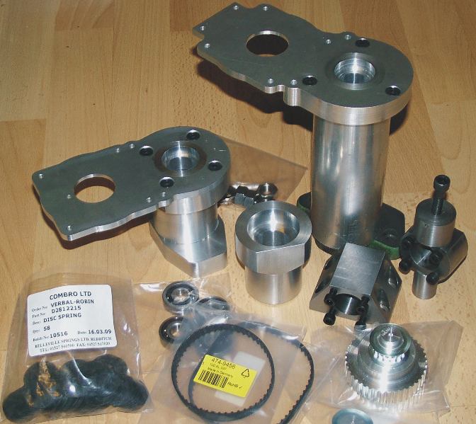

    I'm confusing my milling machines, on this one I used full nuts rather than pairs of half nuts. I didn't want to stress a half nut by asking it for 500 lbf of tension.
    10mm for the bearing, 10mm for the nut, say 1mm protruding, 21mm total.
    Doesn't really matter how far the thread goes inside the bearing, the big axial load from the Belleville washers overwhelms all the other loadings.
    I made all the bearings an easy sliding fit, inside and out. This made it very easy to assemble but it went rock solid the moment I tensioned it.
    How do you plan to mount the motors? I suggest you cobble them on somehow with plates and studding then replace everything when you have CNC. Motor mounting is important now only because it determines the length of the screw.
    Things to remember when designing motor mounting plates...
    Putting the motor on so it faces away from the machine is best.
    Putting the motor on facing the machine saves a couple of quid on the ballscrew length but makes everything else difficult.
    Leave a tadge of motor movement to adjust the belt tension.
    Cut the outline for a belt cover and it's mounting bolts, assume you have CNC for making the belt cover.
    Somewhere to attach a flexy conduit over the motor wires saves bodging it later on.
    My point was not knowing those dimensions means the length of ballscrew directly between the bearings is unknown, which is a critical dimension.
    I guess so long as the mounting surfaces are accurate, but there's no reason to have the thread far in the bearing surface.
    That is a sweet picture Jonathan. Good point that 9mm.

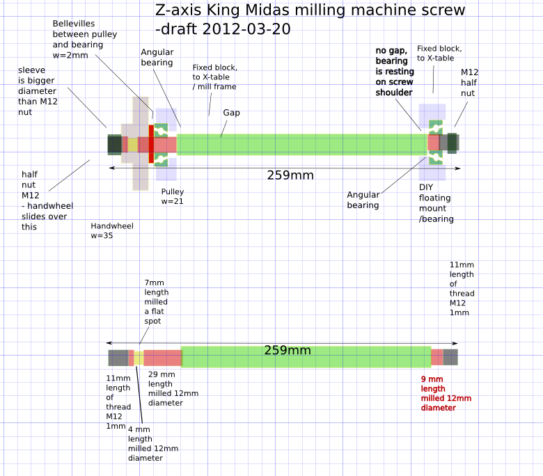

    Final versions of X, Y, Z -axis screw are like this (changed according to Robin's / Jonathan's comments)
    - X-axis:::

    - Y-axis:::
    - Z-axis:::
    Revised shopping list is here. A couple of notes about that
    1) Power supply perhaps is slightly undersize. Thought to trial and see.
    2) Need two (2) of the Nema 23 -motors WITHOUT the rear shaft
    - Need one (1) --------------//----------------- WITH the rear shaft (Z-axis, will attach hand wheel there)
    3) Items 12, 14 -- 19 not sure where to source from, have not found yet
    4) Bearing housings / fittings ---> DIY ?

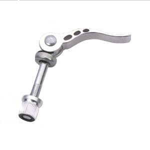

    Have you considered in the Z-axis screw mount how to temporarily disengage it from the spindle when changing tools so that the force from hammering on the draw-bolt to release the tool taper isn't transferred to the relatively delicate ballscrew/ballnut?
    Have not yet figured out how that could be best done. Some sort of a quick-release system would be cool. But not sure about design, and whether it would introduce slack to the Z-axis
    - Something like this maybe, to quick-release?
    Really grateful for all comments and advice in this thread. They have been very helpful. Thanks!
